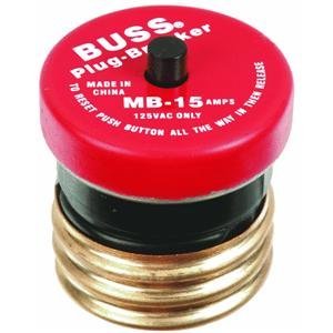

This panel was in the hall on the same house as the above panels and when you closed the panel cover it shut off the power to the 2 fuses with the white buttons.
Would like to ask about the fuses with the white buttons. Is the white button a reset, are these style usable in certain situations?

Those white button are reset buttons. Someone has replaced the standard plug fuses with a plug fuse style circuit breaker.

Quote:
Originally Posted by kwood View Post
Problem is they are made in china.
Would you want a fuse made in china in your home?
I think not!
Why not that's where all of the circuit breakers are made.

Can you get CSA approval on this type of fuse yet?

If things do not have UL or CSA then they are not approved for sale or use in Canada.

Fuses are more reliable than breakers ...
And IMO any FPE panel needs an evaluation by a professional, with a written determination on signed letterhead, and clients should budget for replacement due to a known history of problems.

They wont get insurance if they are down here in Florida. Citizens is the only one insuring most older homes and they do not want to see fuses any more. Simple write up. Replace
