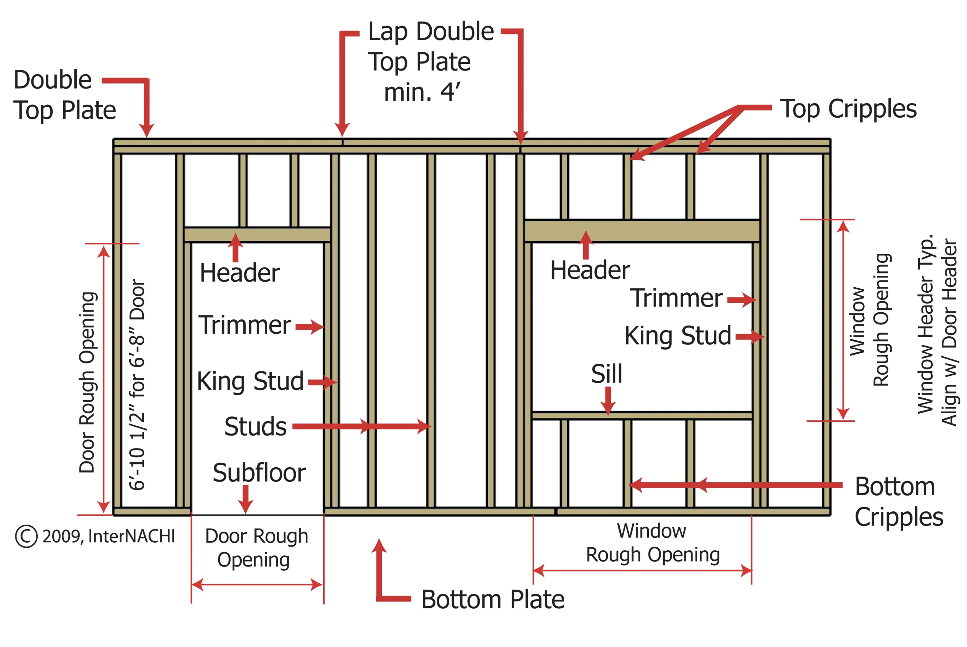

Understanding Double Top Plates as Structural Beams
Double top plates in wood-frame construction function as continuous beams spanning between studs, capable of distributing concentrated loads from joists, trusses, and rafters across multiple support points. This engineering principle allows for flexibility in framing alignment while maintaining structural integrity.

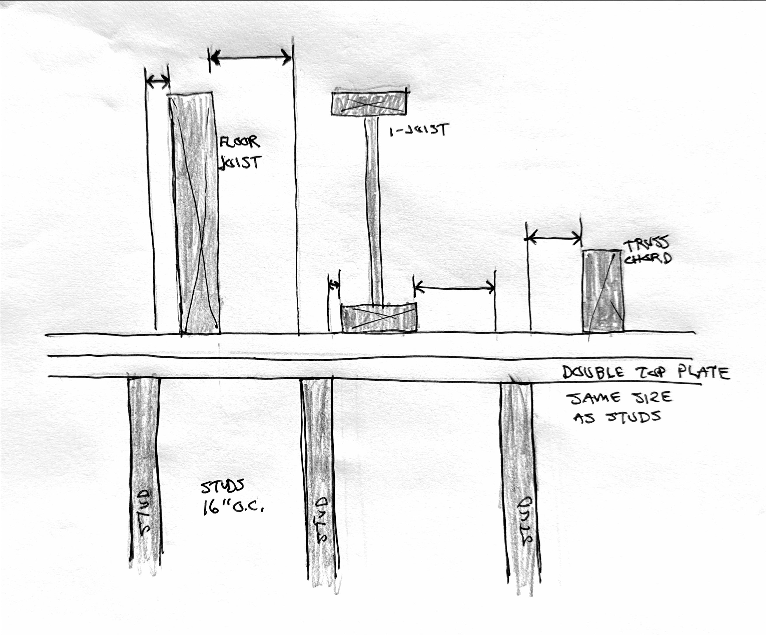

IRC Section R602.3.3: The Code Requirements
A common stud wall framing is shown above. The 2"x4" studs are 16" o.c. and the double top plate is the same size as the studs. The roof rafters, floor joists, or truss chords are resting on the double top plate, and the studs are at 16 inches (406 mm) on center. In this situation, there are no limitations to the distance between the location of the rafter, joist, or chord on the plate and the location of the wall stud.
  • Joist, trusses, or rafters need not align with the bearing studs below spaced 16 inches (406 mm) apart.
