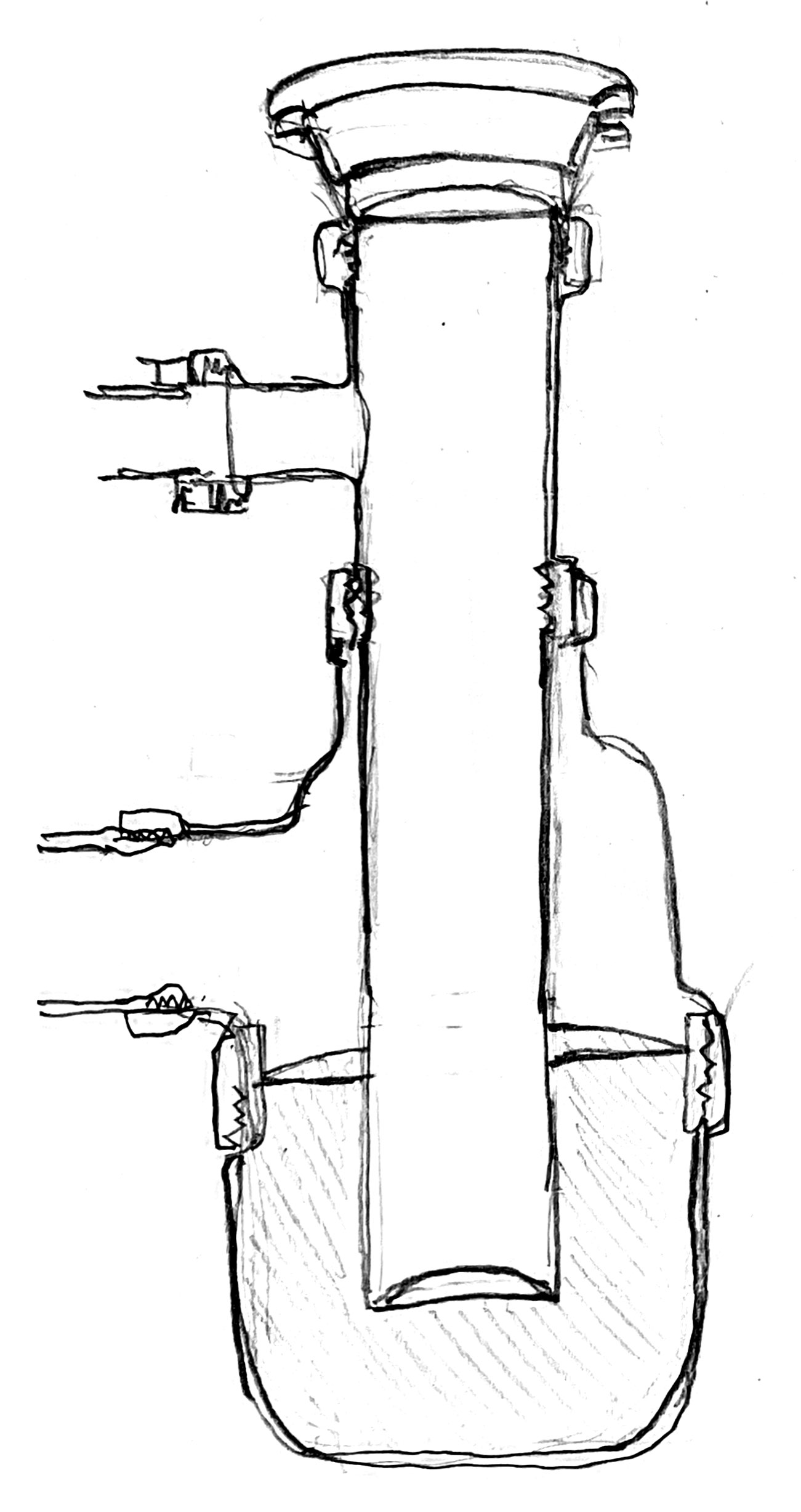

Bottle traps, often referred to as decorative lavatory traps, are sleek, compact, and space-saving drainage solutions that fit well in tight areas. Bottle traps, also known as partition traps, are a type of plumbing trap that utilizes an internal partition to separate the house side from the sewer side. They resemble a small bottle, with an internal pipe designed to allow water to flow while retaining enough to form a seal that prevents sewer gases from escaping.

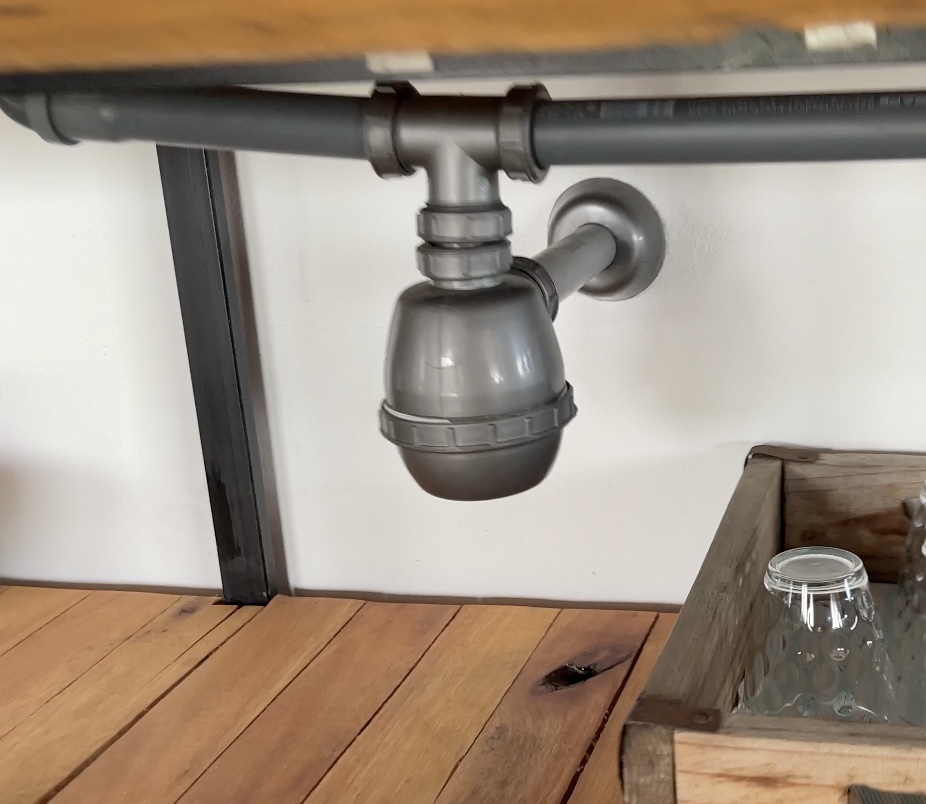

However, there’s a major issue: They don’t meet modern plumbing codes and are considered non-compliant.
Here's what home inspectors need to know:
Why This Matters:
Ensuring that plumbing systems adhere to current building standards is important for maintaining indoor air quality and preventing health hazards associated with sewer gas infiltration. Identifying and addressing non-compliant traps like bottle traps is a key aspect of a complete home inspection.
