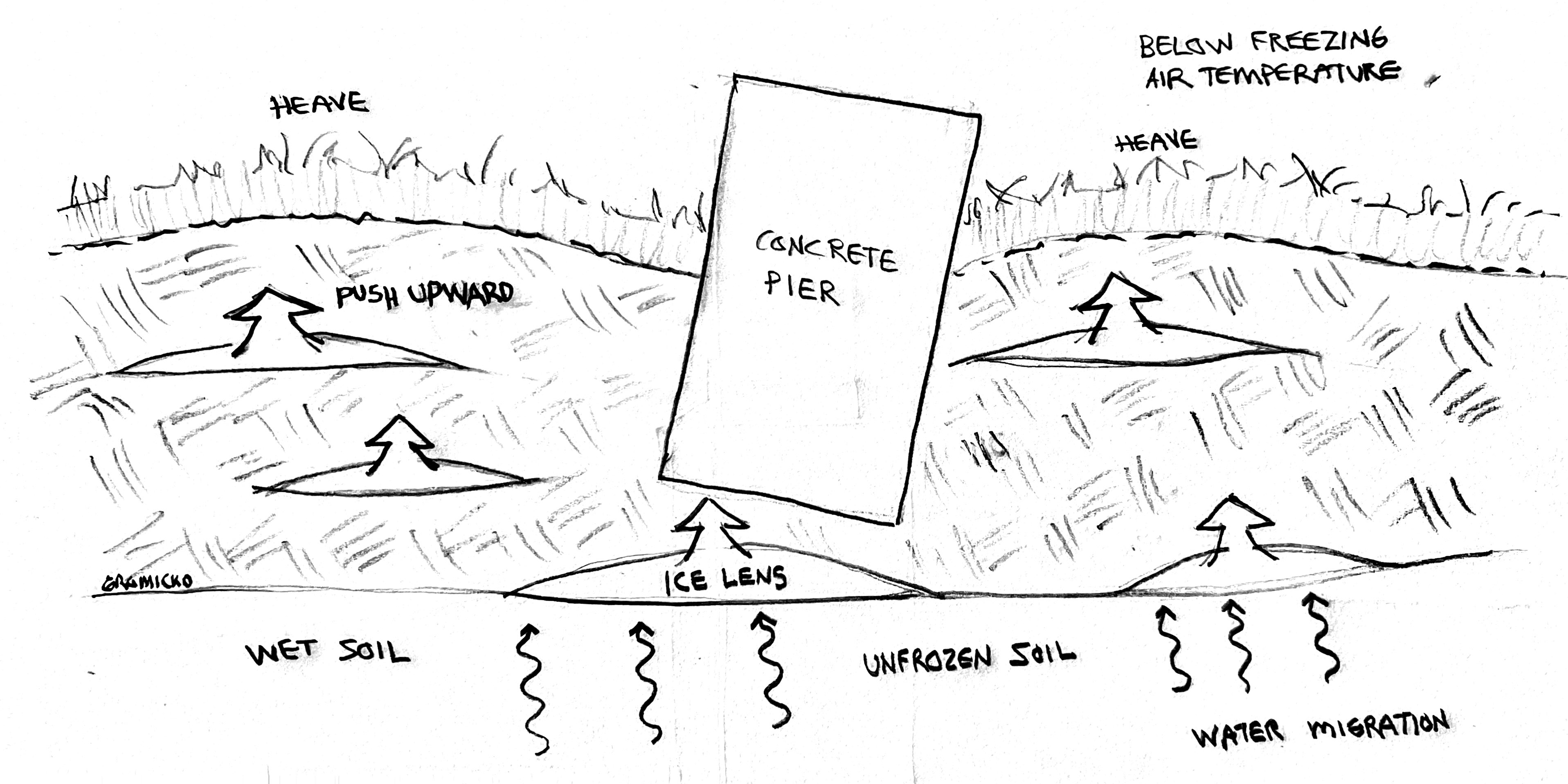

An ice lens is a layer or band of pure ice that forms within freezing, moist soil. These lenses can grow and stack in stratified layers, causing the ground above to push upward or lift, resulting in frost heave.

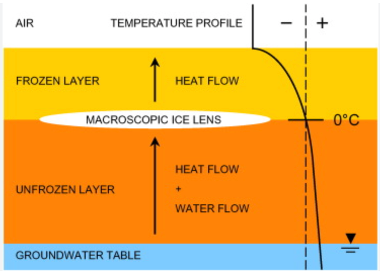

The formation of ice lenses is based on thermodynamics and capillarity:
This process can repeat itself, forming multiple stacked lenses and pushing the soil surface upward. This is the essence of frost heave.

Ice lenses are based upon the principle that when certain soils are exposed to freezing temperatures and have access to liquid water, capillary action draws water toward the freezing front, where it freezes and accumulates into layered ice bands. These ice lenses can expand and lift the soil, leading to structural damage known as frost heave. Understanding the mechanics behind ice lens formation is crucial for proper building design, especially in cold climates.
