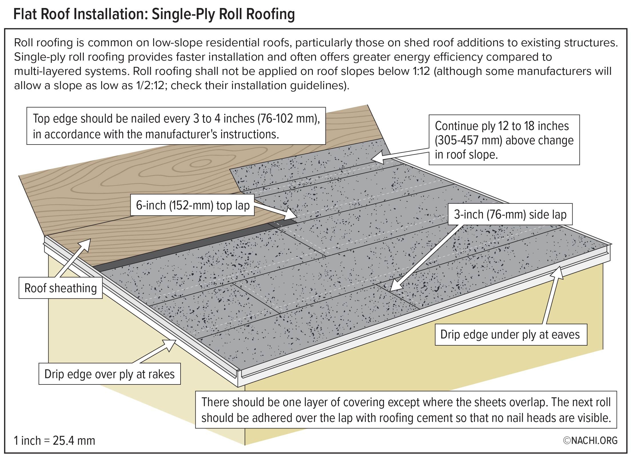

Flat Roof Installation: Single-Ply Roll Roofing
