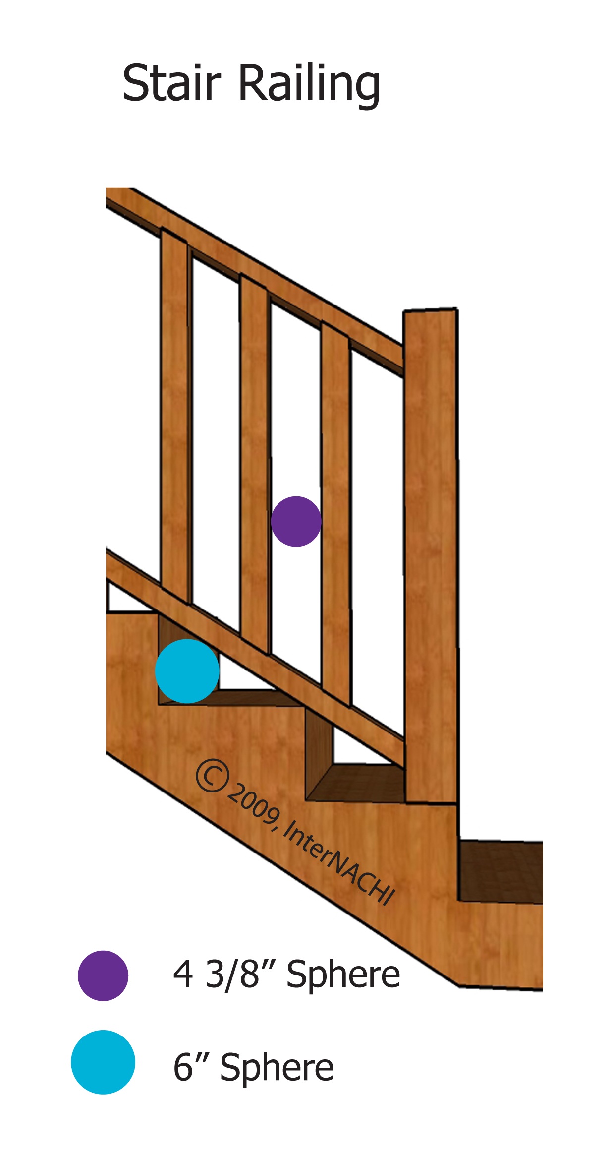

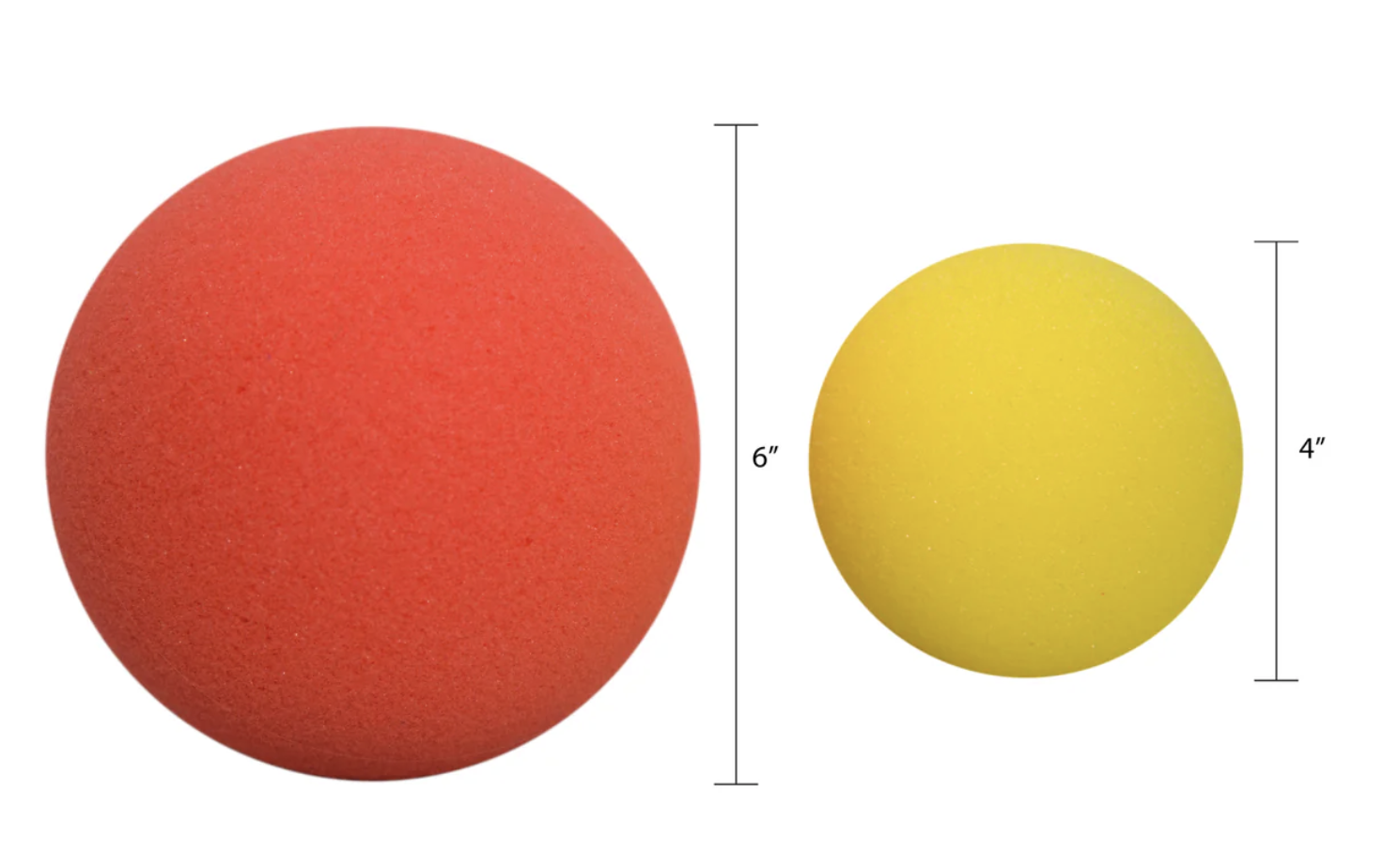

The 2024 IRC Section R321.1.3 states that required guards shall not have openings that allow passage of a sphere 4 inches in diameter. This is commonly known as the "4-inch sphere rule."
There it is—your standard for "improper spacing." If a 4-inch ball can pass through the balusters, spindles, or any opening in the guard, it's a defect. It poses an unreasonable risk to people, especially young children, and could be deemed by the inspector to fit the SOP's definition of a material defect.

1. Bring a 4-inch sphere. You can buy a simple tool that's exactly 4 inches in diameter, or use a ball. Test every opening in guardrails on decks, stairs, balconies, and porches. This is for your own evaluation—you don't need to mention the tool in your report.
2. Measure the height. The IRC requires guards to be at least 36 inches high at open-sided walking surfaces, including stairs, porches, balconies or landings. Use this knowledge to identify defects, but in your report, write something like "guardrail height does not meet modern safety standards."
3. Document with photos. Take pictures of defective guardrails and include them in your report. Show the 4-inch sphere passing through the opening if possible. Let the visual evidence speak for itself.
4. Explain the risk without citing code. In your report, write: "Baluster spacing exceeds 4 inches, which does not meet modern building standards and creates a risk for small children." You're stating the fact, explaining the risk, and staying in your lane.
