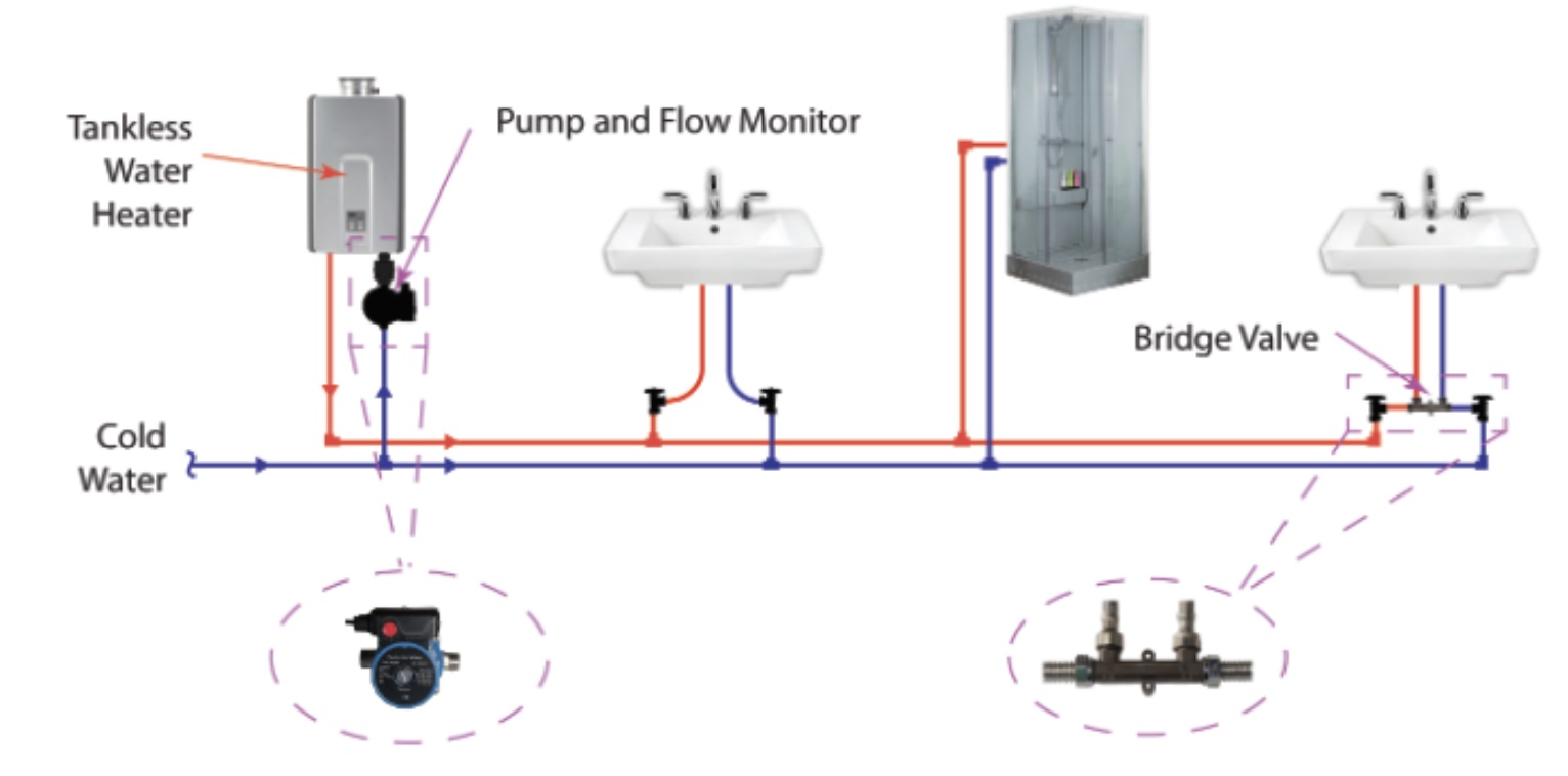

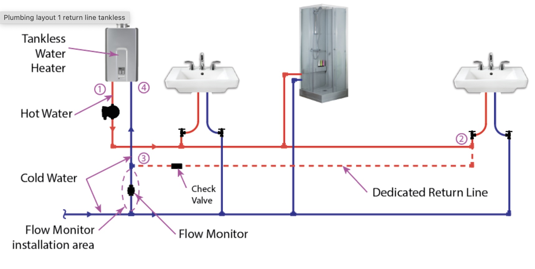

The illustrations below show how there can be a few different ways hot water can be distributed and recirculated to the fixtures using a tankless water heater as the hot water source.
There may be a dedicated return line. A dedicated pipe returns unused hot water from fixtures back to the water heater. A check valve prevents backflow, ensuring water flows in the correct direction. A timer or sensor controls when the recirculation pump operates, optimizing energy efficiency.
There may be a bridge valve at the farthest fixture. It may not be easy to determine during a home inspection.

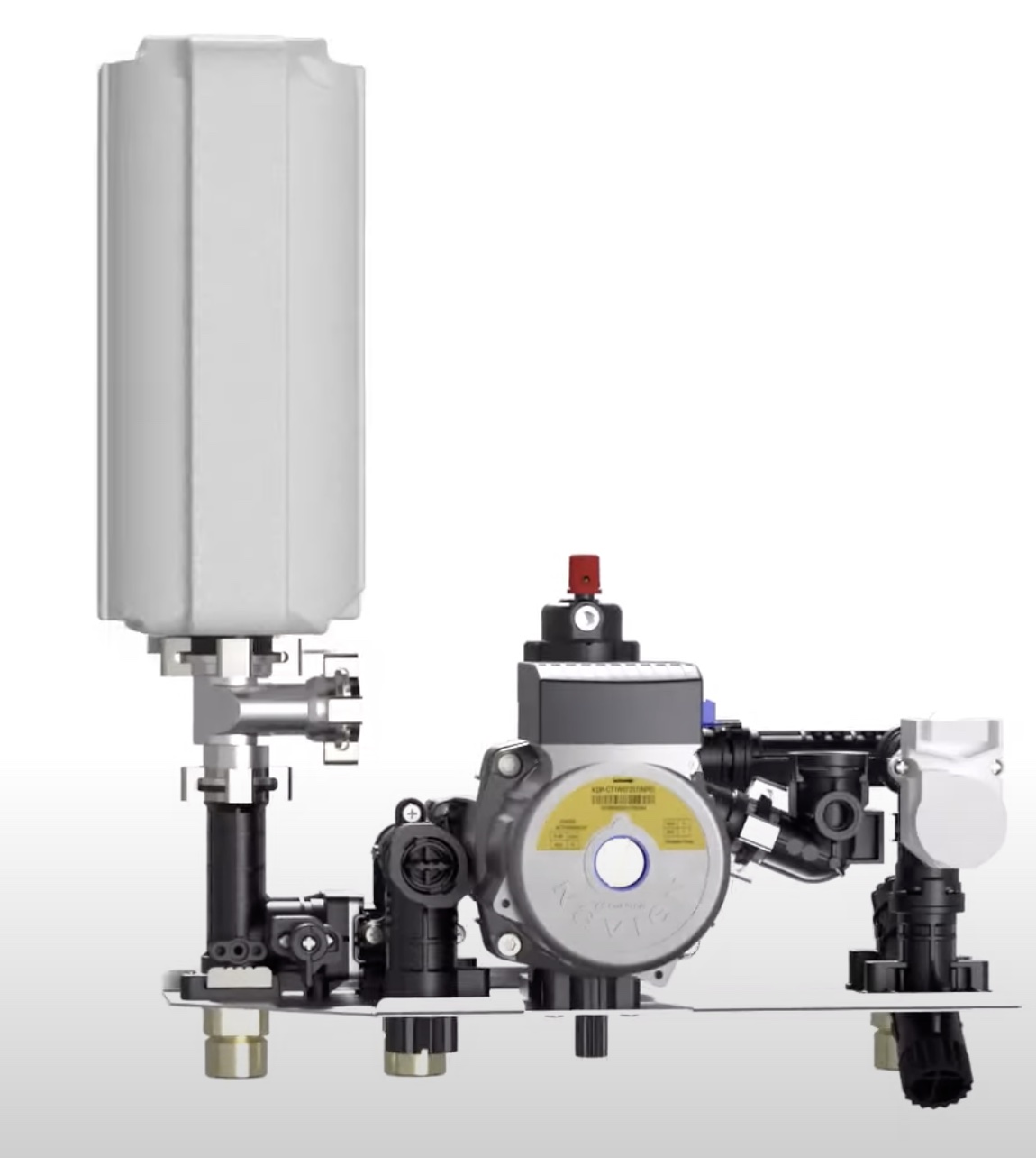

Some tankless models have built-in recirculating pumps, while others require an external pump. The picture below is of an internal recirculating pump and buffer tank.
The pump circulates water through the hot water distribution pipes.

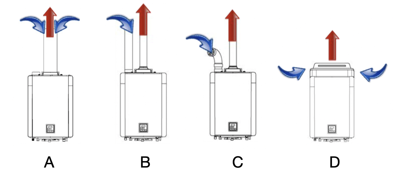

Venting Options
There are a few venting options for tankless water heaters. Specific details will be described in the manufacturer's installation manual. Below are some general options illustrated by Rinnai.
A is a concentric pipe for an indoor installation, where the intake air and exhaust vent through a single concentric pipe connection. B is a twin pipe for an indoor installation, where the intake air and exhaust gent through separate pipes. C is for an indoor installation, where the room air is used for combustion while the exhaust vents to the outside. D is an outdoor installation where an outdoor vent cap is installed on top of the water heater.

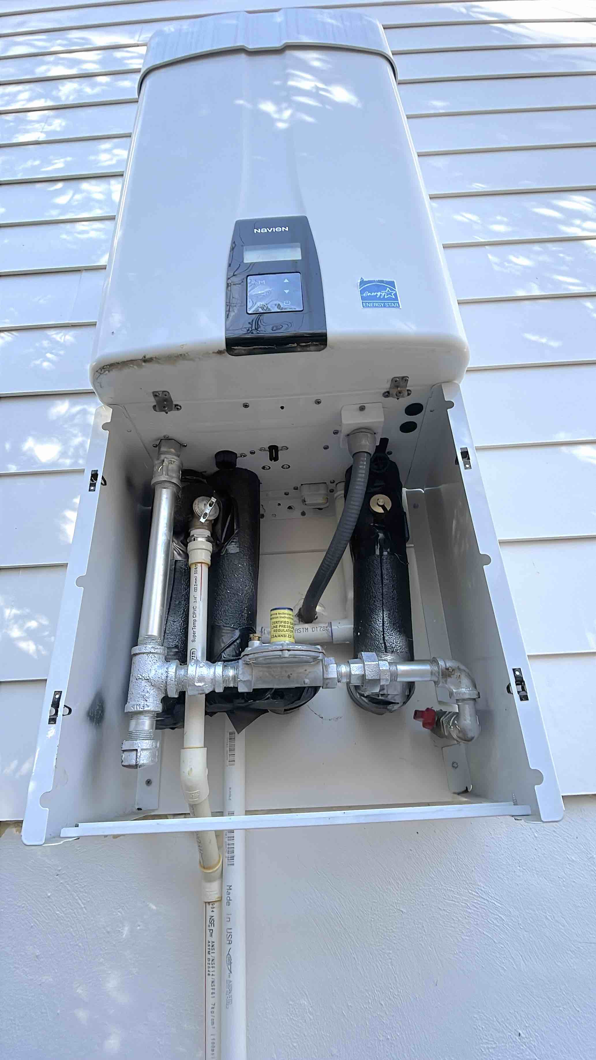

The inspection image below is of a tankless water heater. The pipes for the natural gas supply, the TPR valve, its extension pipe, pressure regulatory, shutoff valve, electrical line, and insulation hot and cold water pipes are all observable in this inspection image. No major defects were observed.
When indications of defects are observed at the tankless water heater, a licensed plumber qualified to work on tankless water heater appliances is recommended to evaluate further and make corrections.
