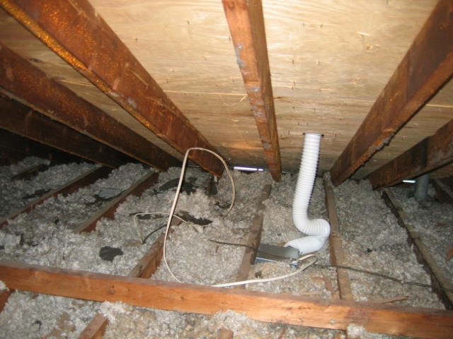

Home inspectors sometimes see a uninsulated bathroom duct in an unconditioned attic space and wonder if it's a defect. Here's an article to help answer that question.
The inspection image shows flexible ducts originating from two bathroom exhaust fans that pass through an unconditioned attic space. The uninsulated ducts can form condensation under certain climate zones and conditions. Excessive condensation can degrade the duct, promote mold growth, and cause structural damage. Check your local code and climate zone.

The inspection image is of an uninsulated bathroom exhaust duct passing through an unconditioned attic space, showing the potential for condensation problems. The home inspector recommended the duct to be sealed and insulated.

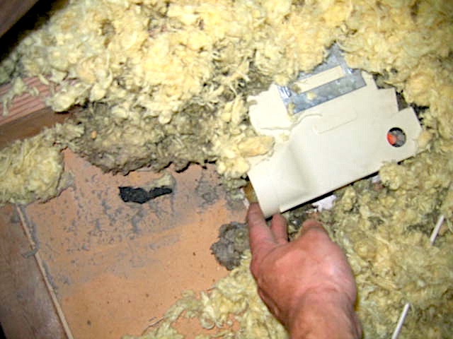

The inspection image is of a bathroom exhaust fan and the flexible duct passing through unconditioned attic space.

The inspection image is of a bathroom exhaust fan without any duct pipe.

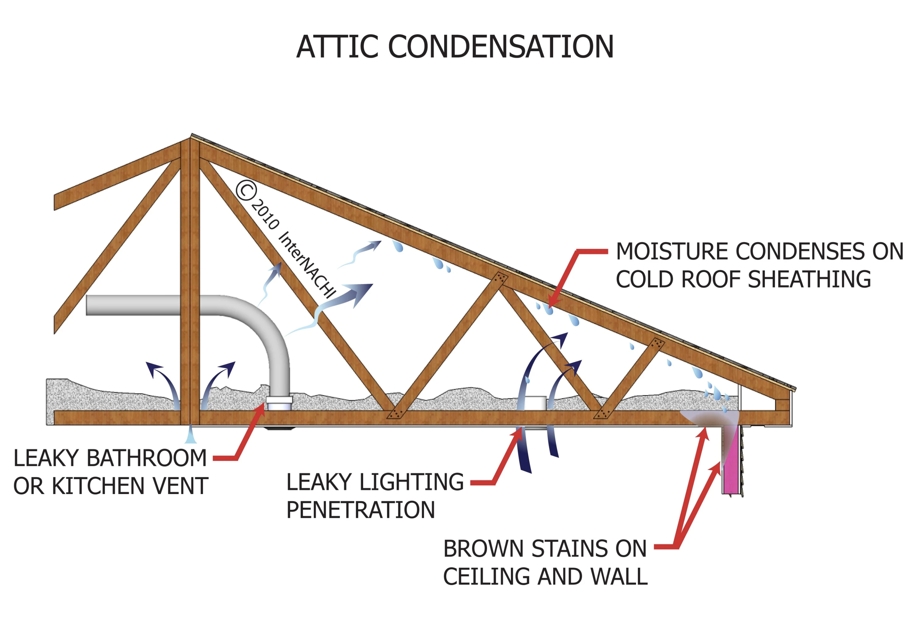

Sealing and insulating bathroom exhaust duct pipes is a crucial step to prevent moisture and condensation problems in a cold attic. The primary issue isn't just condensation inside the duct, but also the escape of warm, moisture-laden air into the cold attic space due to unsealed connections.
This escaped air cools rapidly to its dew point, causing water vapor to condense on the coldest surfaces. This moisture leads to issues like rusty roof nail tips and water staining on the underside of the roof deck sheathing. Proper sealing and insulation of the ductwork is essential to ensure moisture is effectively vented outside the home, protecting the attic's structural integrity and maintaining a healthy living environment.

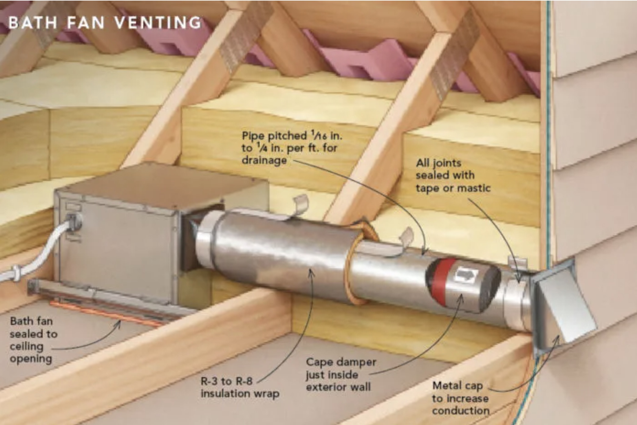

Michael Maines, a residential designer and former carpenter in Palermo, Maine, provides a solution in Fine Homebuilding Magazine. His best practice is to wrap the entire duct with R-3 to R-8 insulation, paying particular attention to the termination point area, which is where condensation is most likely to happen.

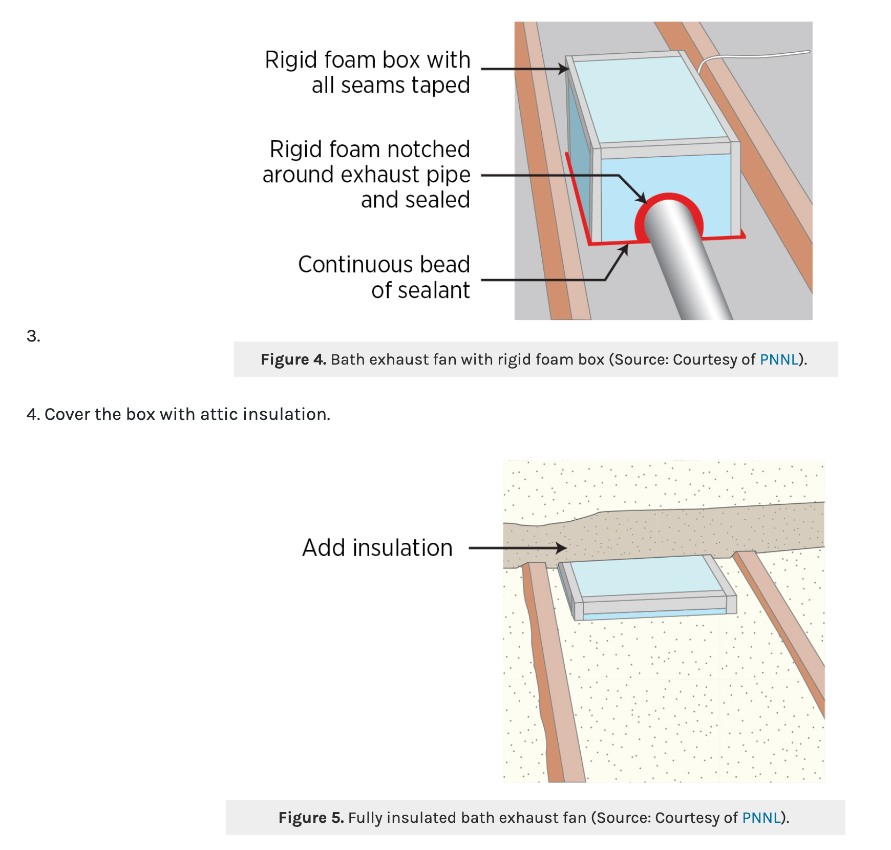

The rigid foam box installed around the fan can be leaky. Pressure and temperature differences between conditioned and unconditioned spaces encourage this air flow. These air leaks represent energy losses. They could also potentially allow warm, moisture-laden air into unconditioned attics where it can condense on cold surfaces, creating moisture problems. Air barriers need to be continuous to be effective, and this means sealing all penetrations in exterior walls, ceilings, and floors adjoining unconditioned spaces.
