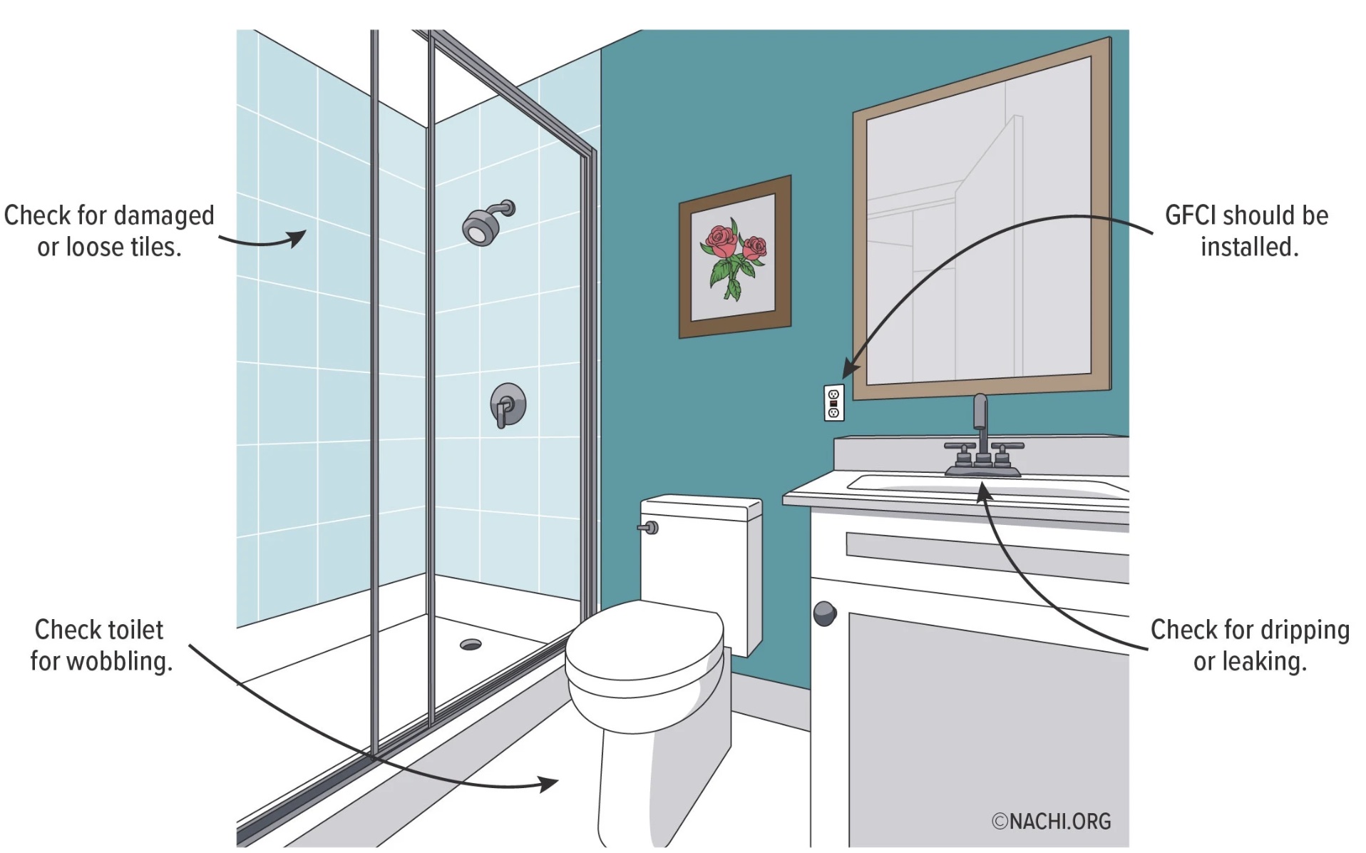

  • Check for ground-fault circuit-interrupter (GFCI) protection. All bathroom receptacles should have GFCI protection. GFCIs prevent electrocution in wet areas and have been required in bathrooms for decades. Arc-fault circuit-interrupter (AFCI) protection is generally not required in bathrooms.
  • If a GFCI receptacle is installed in the bathroom, push the test button, then reset it. If it doesn't reset, that's a defect.

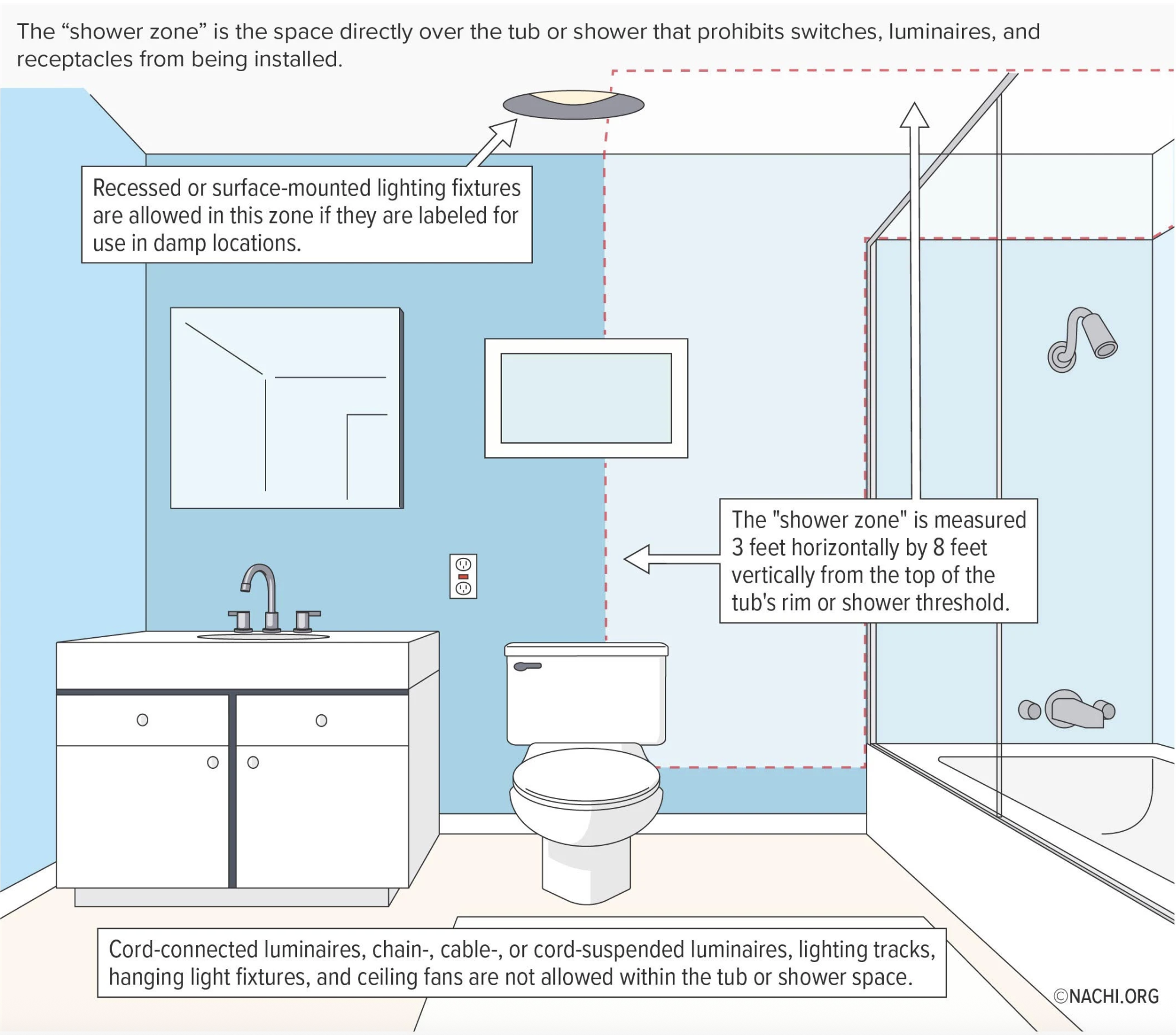

  • There should be at least one lighting outlet (light fixture) controlled by wall-mounted device (switch). The switch should be located near the bathroom door. It must also be located outside tub and shower area.
  • Light fixtures within 3 feet (914 mm) of the tub or shower should be rated for damp or wet locations.

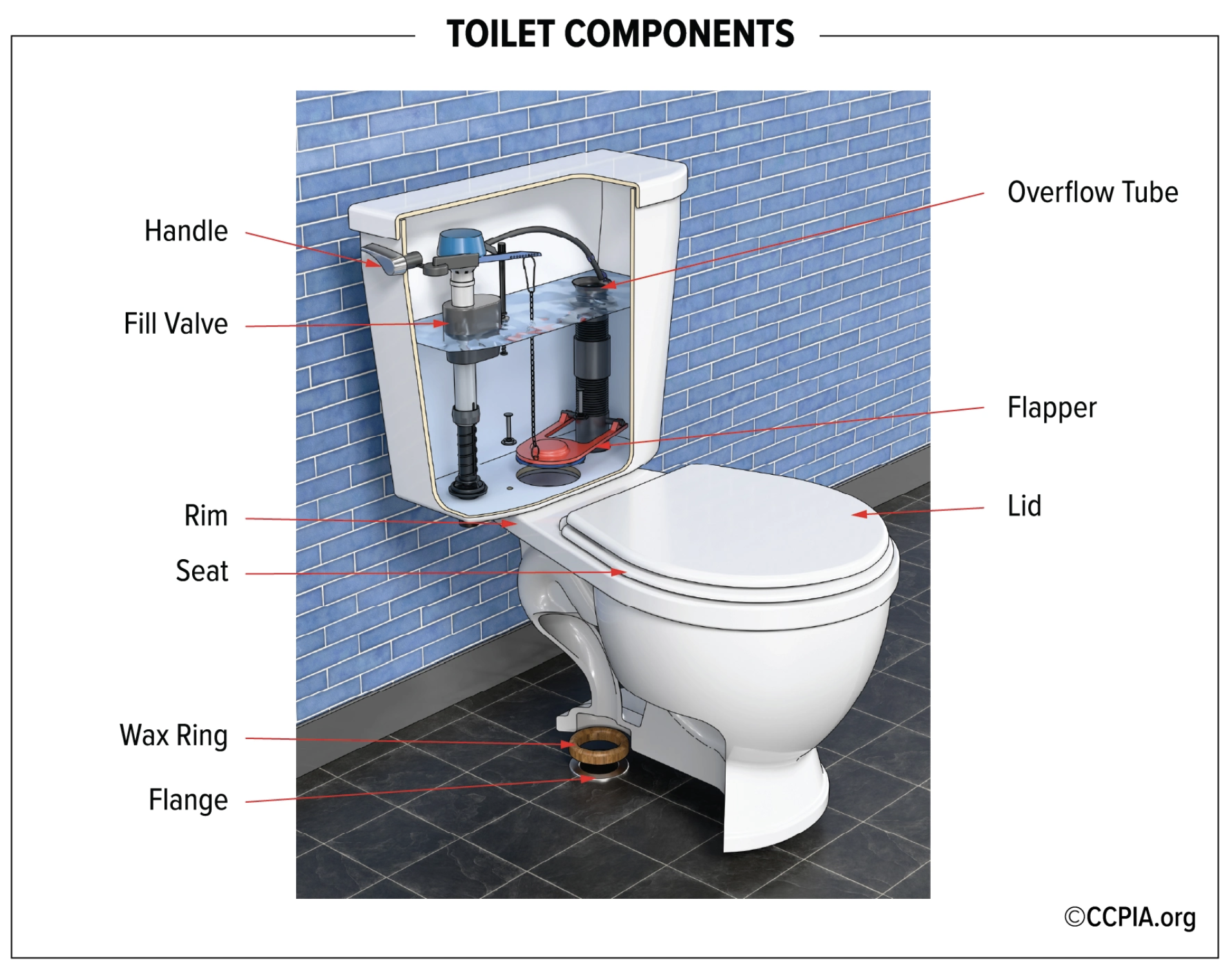

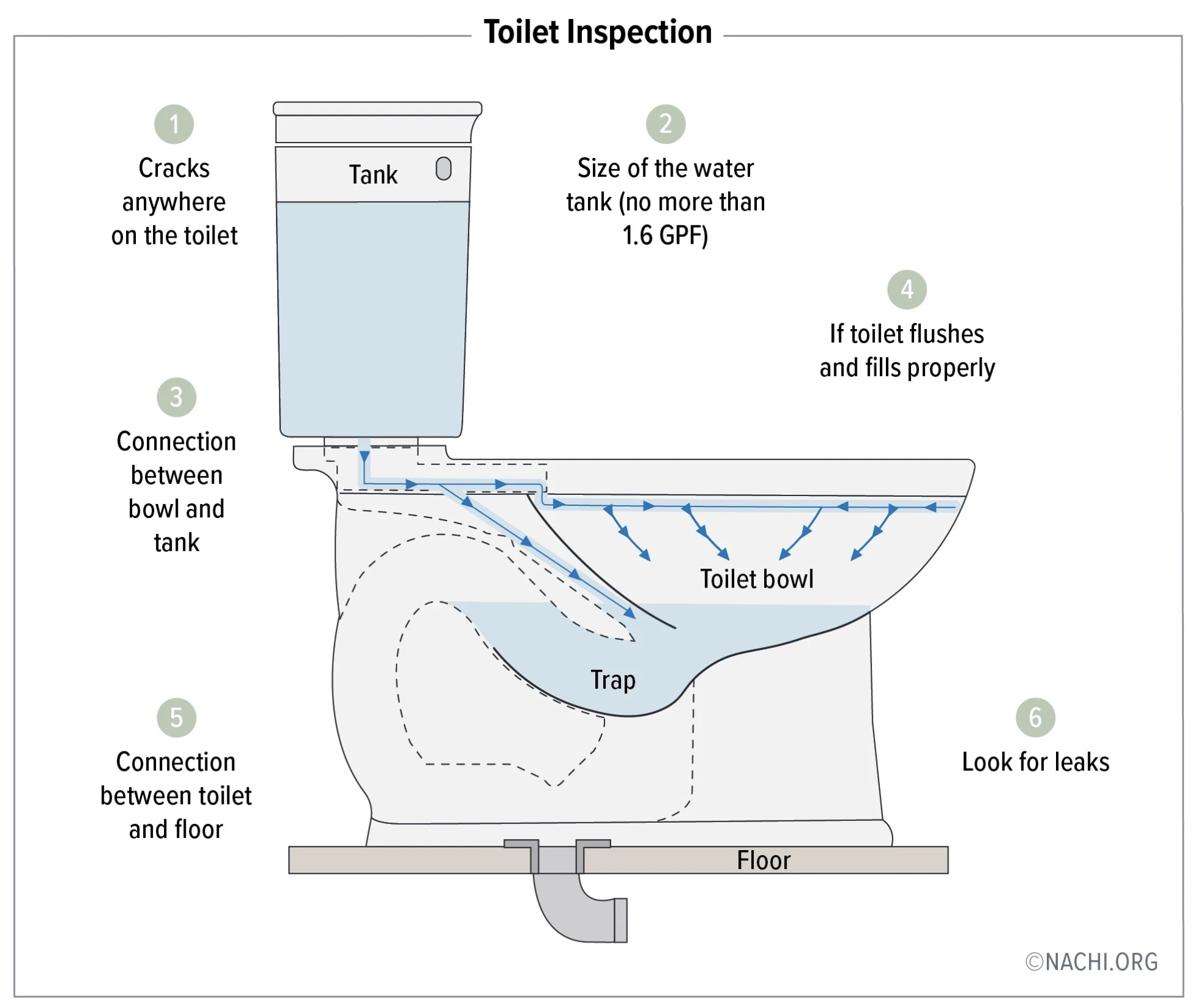

Toilet
  • Use the side of your leg to check the toilet. A loose toilet may leak, the bolts may be loose, and the wax ring might be damaged.
  • Flush the toilet several times.
  • Make sure it flushes, drains, and fills back up again.
  • Listen to see if it’s still filling up the tank.
  • Check the seat, lid, and hardware.

  • Check the cabinet for water stains or warped wood that shows prior leaks.
  • Check for a P-trap.
  • Check the water supply lines and shut-off valves.
  • Run your hand along the pipes and valves to feel for water leaks. Sometimes leaks are easier to feel than see.

  • Look for cracked or damaged tiles and missing grout. Use your knuckles to find hollow sounds that may indicate loose tiles.

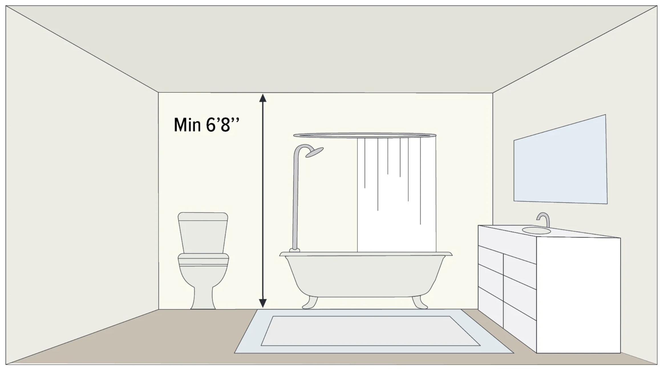

  • The minimum ceiling height for bathrooms and toilet rooms is 6 feet, 8 inches (2032 mm). There are exceptions for a sloping ceiling over the toilet.

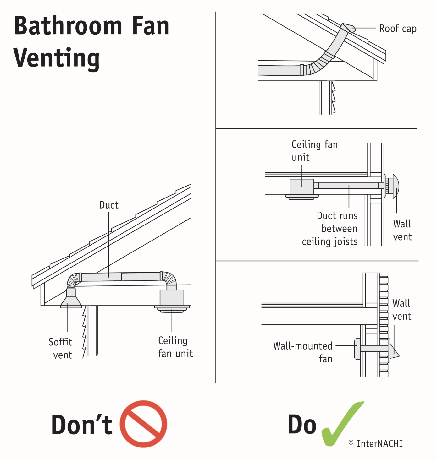

Bath Fan
  • If there’s no bath fan (mechanical exhaust/ventilation system), there must be a window. And the window should have at least 1.5 square feet of openable space.
  • If there's a bath fan, turn it on. Listen to it. It should sound like a fan, not a rattle.
  • Hold a tissue up to the fan. It should pull the tissue toward the vent.
  • The bathroom exhaust fan must discharge to the outdoors. The air must not be exhausted into an ceiling, attic, soffit, ridge vent, or crawl space.
  • The exhaust duct termination must have a backdraft damper.
