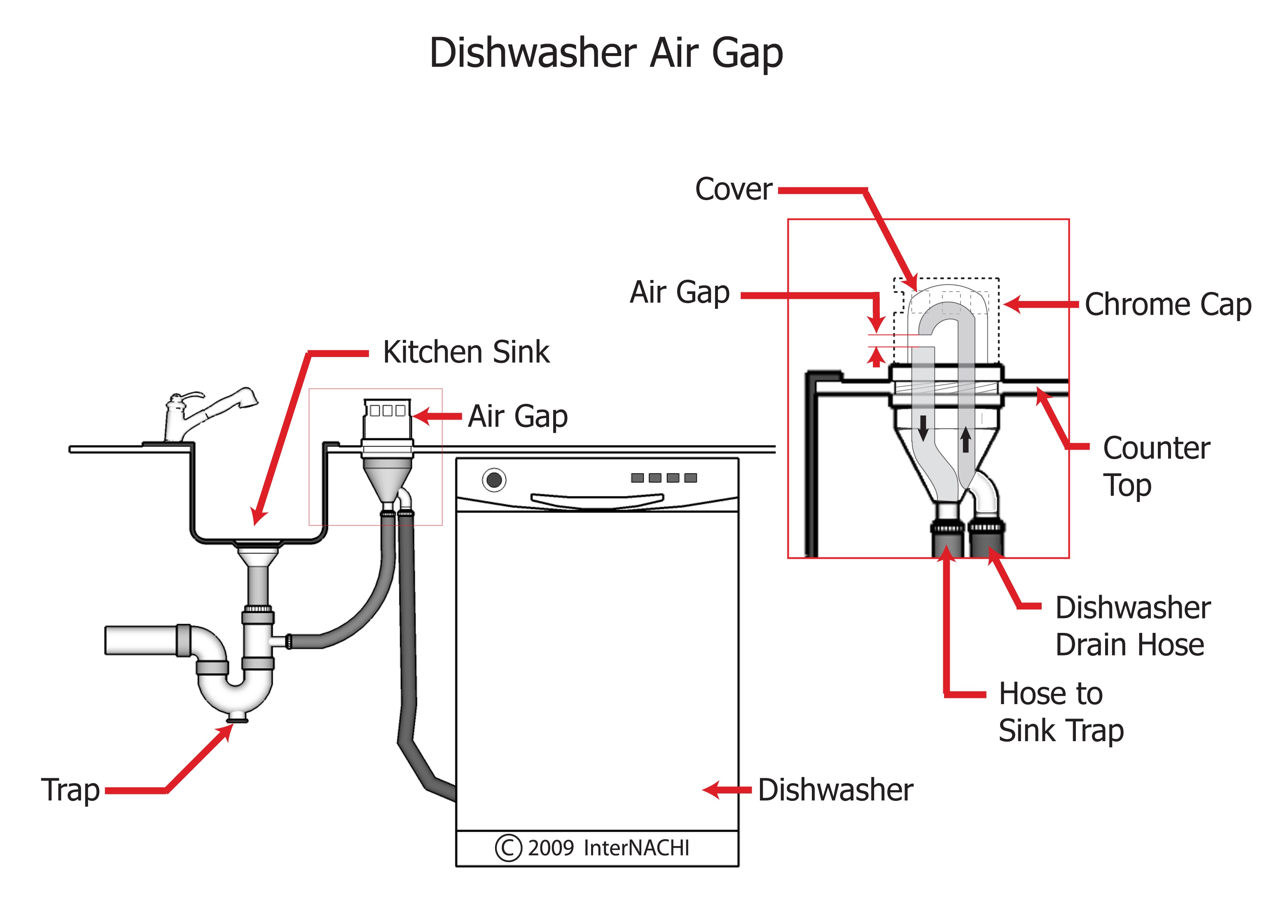

  • Check the discharge line from the dishwasher and the drain pipe under kitchen sink. The discharge line from the dishwasher must connect to (a) a drain pipe (a wye branch fitting), (b) a food disposer, or (c) a standpipe with an air break. And the drain pipe should be secured to the underside of the countertop to prevent backup.
  • If a standpipe is used for the dishwasher drain waste connection, the waste line must terminate through an air break and be secured to the top of the standpipe. The need to loop the dishwasher hose to the underside of the countertop is not needed for this waste connection because the standpipe is an indirect waste and the chance for backup into the dishwasher is unlikely (Refer to 2024 IRC P2717.2).
  • Check the backflow prevention. There must be an air gap or high drain loop to prevent contaminated water from the dishwasher from entering the clean water supply of the house. There may be an airgap device mounted on sink or countertop or a high loop fastened as high as possible to the underside of the counter.
