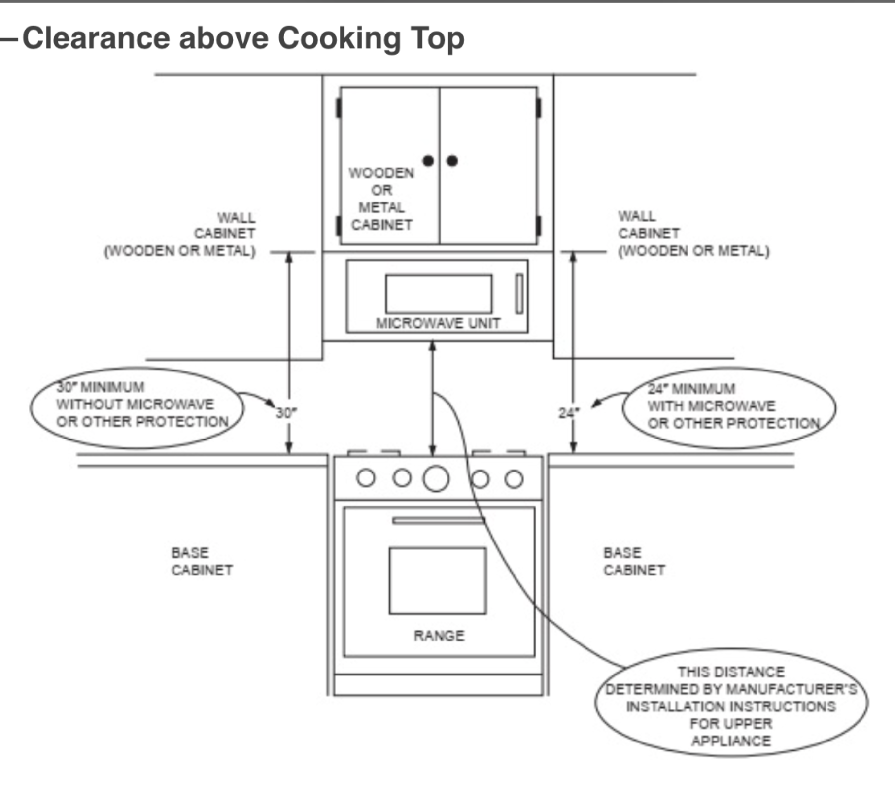

Clearance
  • Check vertical clearance to combustible materials. Cook tops can produce intense heat. Household cooking appliances should have at least 30 inches (760 mm) of vertical clearance above the cooking top to combustible materials (framing, finishes, cabinets, shelving, soffit) and metal cabinets with combustible contents. A few exceptions permit a minimum clearance of 24 inches (610 mm), including when the underside of the combustible material or metal cabinet above the cooking top is protected by a microwave oven installed in compliance with the manufacturer's installation instructions. Refer to 2024 IRC G2447.5 (IFGC 623.7).

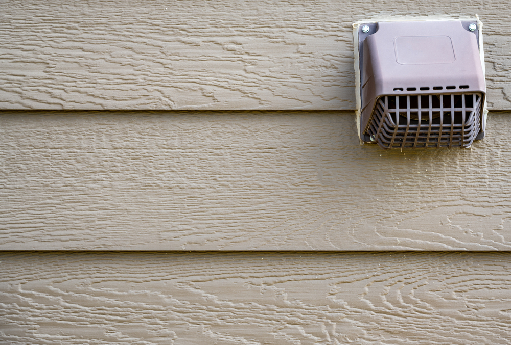

  • Determine where the kitchen exhaust fan terminates. It must discharge outside. There's an exception if natural or mechanical ventilation is provided for the kitchen, but this is not common. Refer to 2024 IRC 1503.3.
  • The exhaust fan should not discharge into an attic, soffit, ridge vent, or crawl space. Because kitchen exhaust systems affect indoor air quality by removing cooking vapors, grease, and moisture, recirculating fans are inadequate ventilation systems. Refer to 2024 IRC M1504.3 for details and exceptions.
  • The exhaust should terminate at least 3 feet (914 mm) from a property line and from gravity air intake openings, operable windows, and doors.
  • The exhaust hoods at exterior walls or the roof should be at least 3 feet (914 mm) from operable windows.
  • The exhaust should terminate at least 10 feet (3048 mm) from mechanical air intakes.
  • The exterior termination (exhaust hood) should have a backdraft damper that opens freely. Backdraft dampers prevent the infiltration of outdoor air when the exhaust system is not operating.
