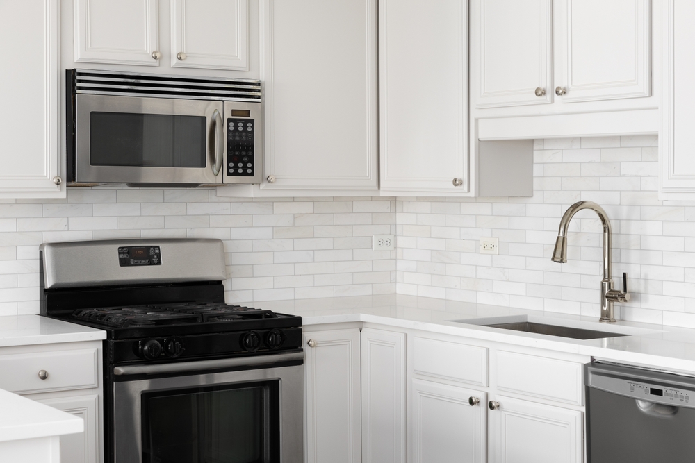

  • Check for secure mounting of the microwave oven. Units should be firmly attached to cabinetry or wall brackets and not move when the door is opened.
  • Check for damage. Never operate a microwave with a damaged door or cracked glass. This poses a serious risk to radiation exposure.
  • Check vertical clearance to combustible materials. Cook tops can produce intense heat. Household cooking appliances should have at least 30 inches (760 mm) of vertical clearance above the cook top to unprotected combustible materials (cabinet, framing, soffit, shelving). There are exceptions that permit the minimum to be 24 inches (610 mm), including a microwave installed according to the manufacturer's installation instructions. Refer to 2024 IRC G2447.5 and IFGC 623.7.
  • Check that the electrical receptacle in the cabinet above is properly positioned and the cord connection is secure. Refer to 2024 IRC R4101.3.

  • Microwave energy will not leak from a microwave in good condition. A damaged microwave oven may present a risk of microwave energy leaks. To be safe, step away from the microwave while it is running to avoid exposure to non-ionizing electromagnetic radiation.
  • Check the operation of the microwave oven by placing a small cup of water or wet paper towel inside the appliance and running a brief 5-second heating cycle. Check the operation, not the cooking performance or water temperature.
  • Listen for the magnetron humming.
  • Check the light inside the appliance turns on.
  • Check the turntable rotation during operation.
  • Use an EMF detector or InterNACHI's Microwave Detector to check for electromagnetic wave leakage around door. Follow the detector's instructions.
  • The unit should immediately turn off when the door is opened.
  • If the unit doesn't start, makes unusual grinding or arcing sounds, produces a burning smell, or shows no signs of heating after the brief test, that’s a defect.
