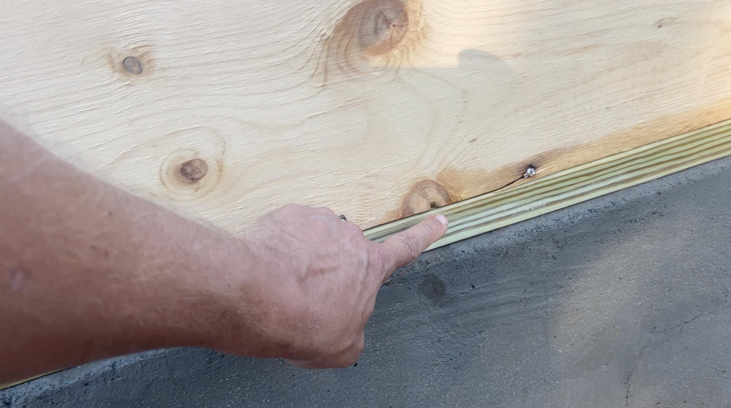

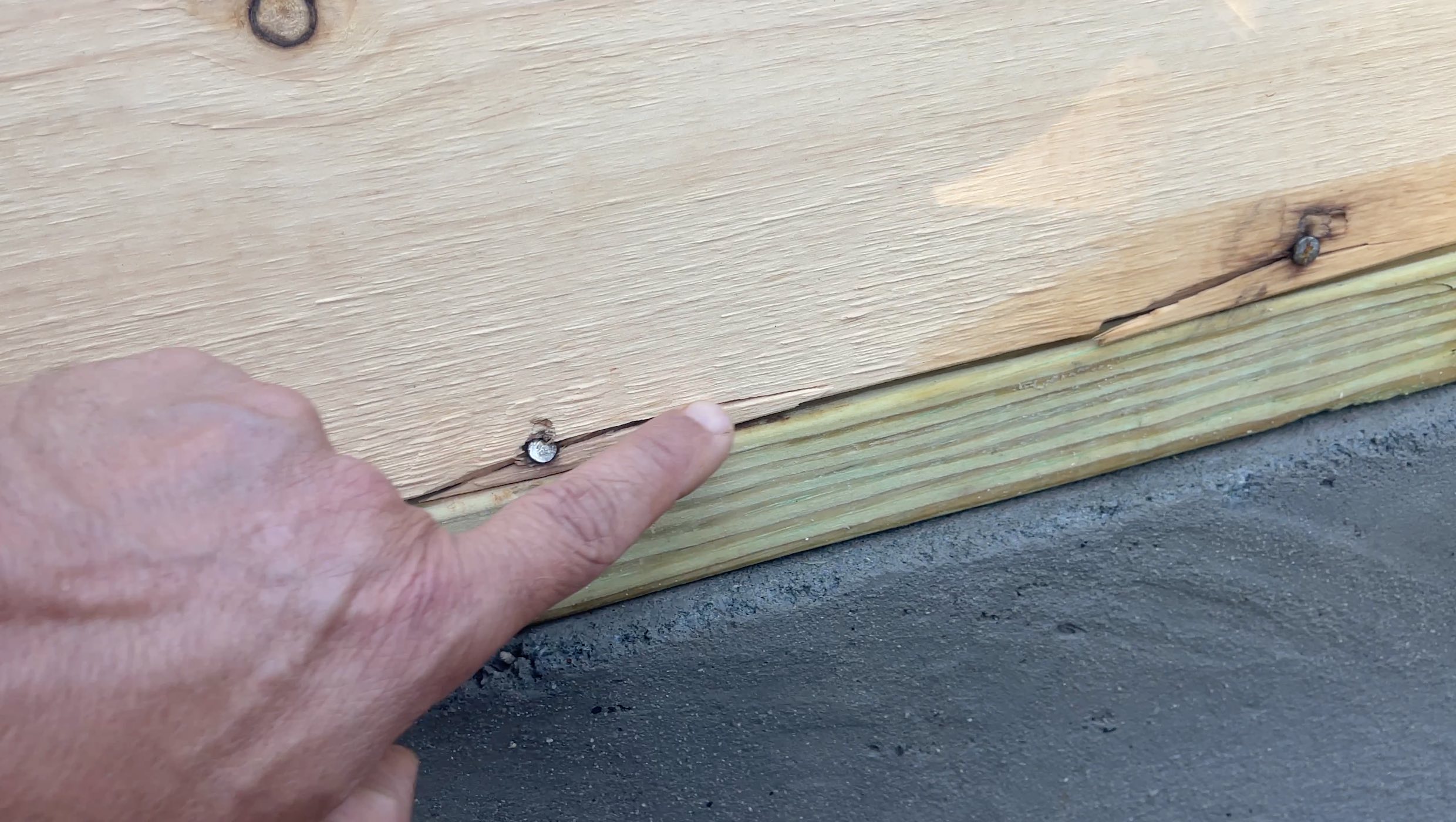

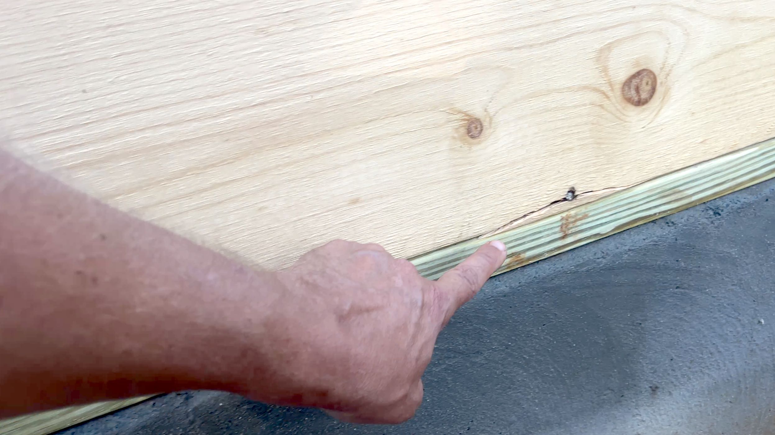

The inspection image shows a home inspector observing fasteners passing through split wood caused by incorrect toenailing of the band joist to the foundation sill plate.
When a nail is installed in a way that splits the wood it's supposed to join, it compromises a home's structural integrity. Instead of the force being transferred effectively through a solid connection, the split wood fibers lose their grip on the nail, dramatically reducing its holding capacity. This creates a weak link in the continuous structural load path—the interconnected framework of a home (from the roof, through the walls, to the foundation) designed to resist and transfer forces from gravity and wind.

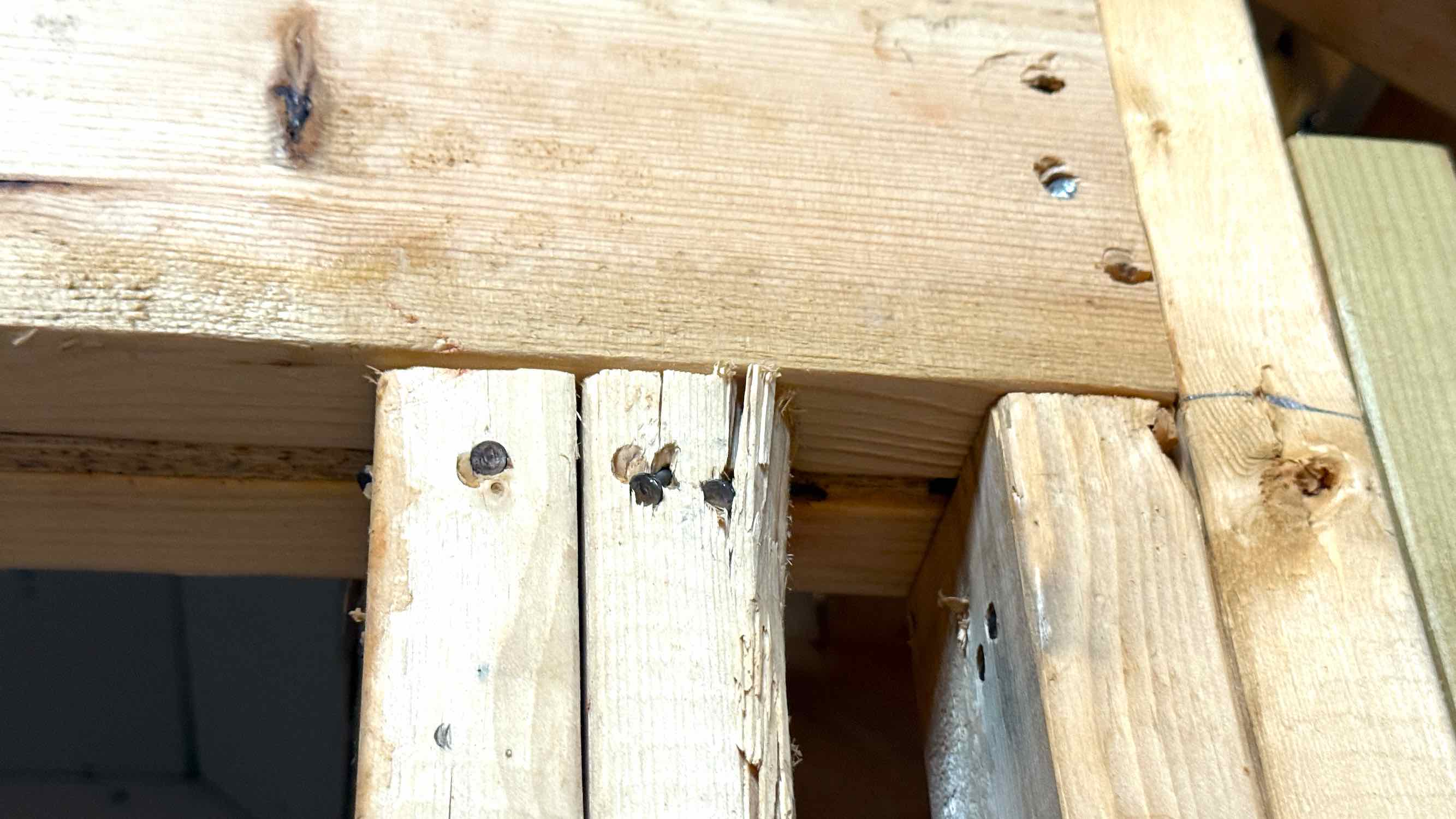

The inspection image is of toe-nailed fasteners splitting open the end of a 2x4 stud below a door header.

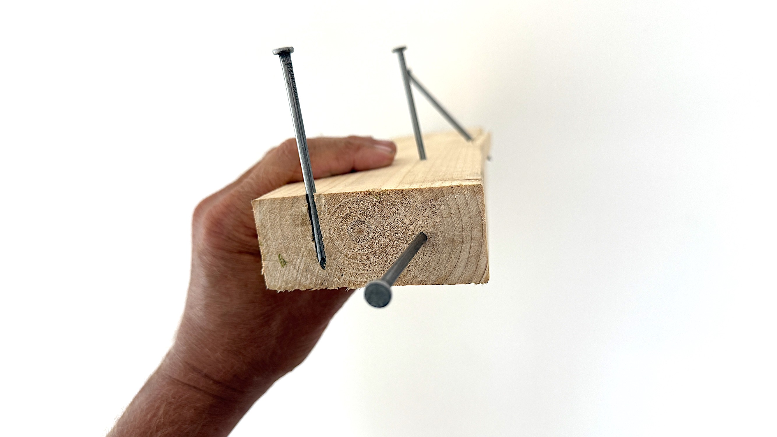

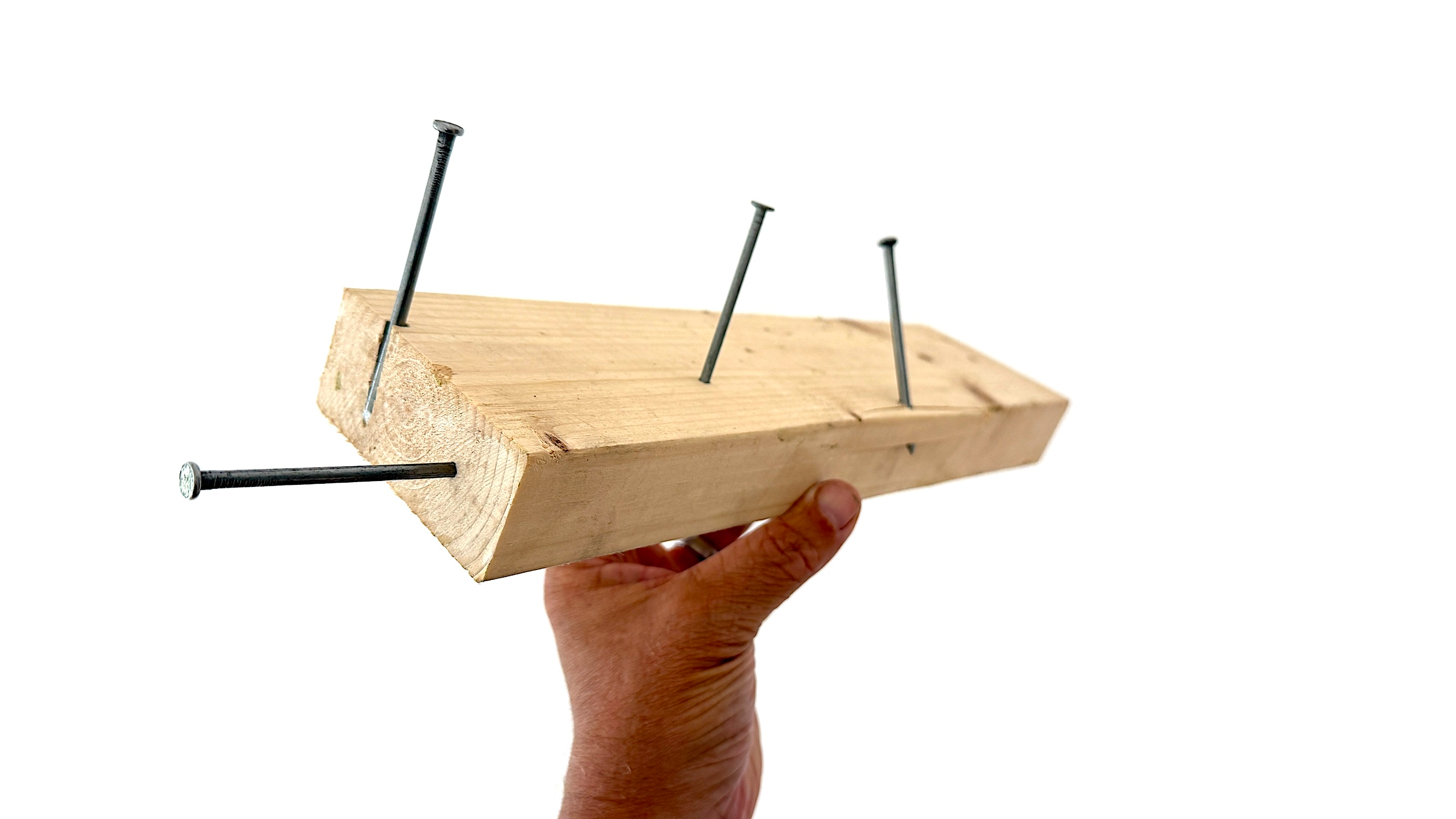

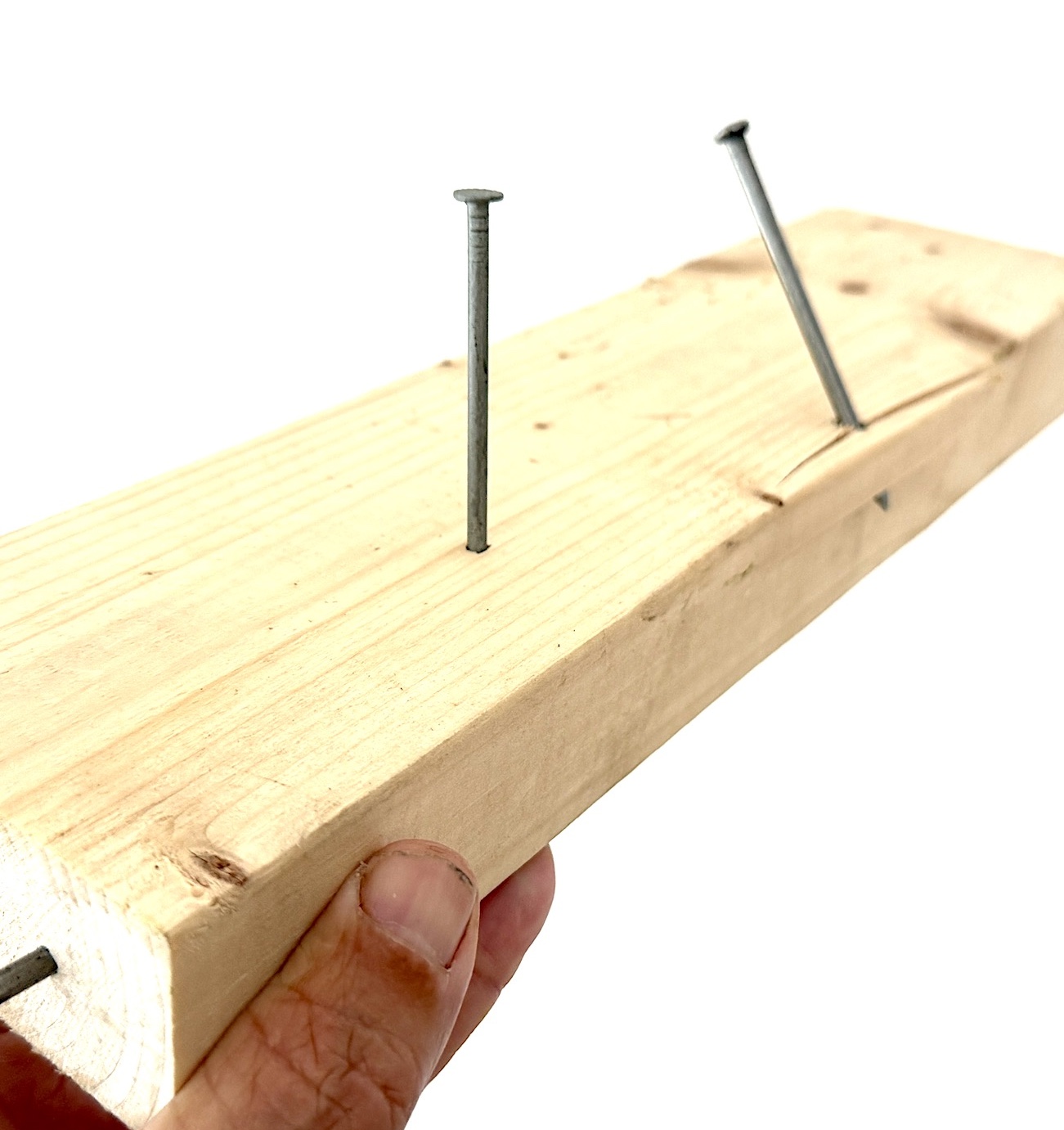

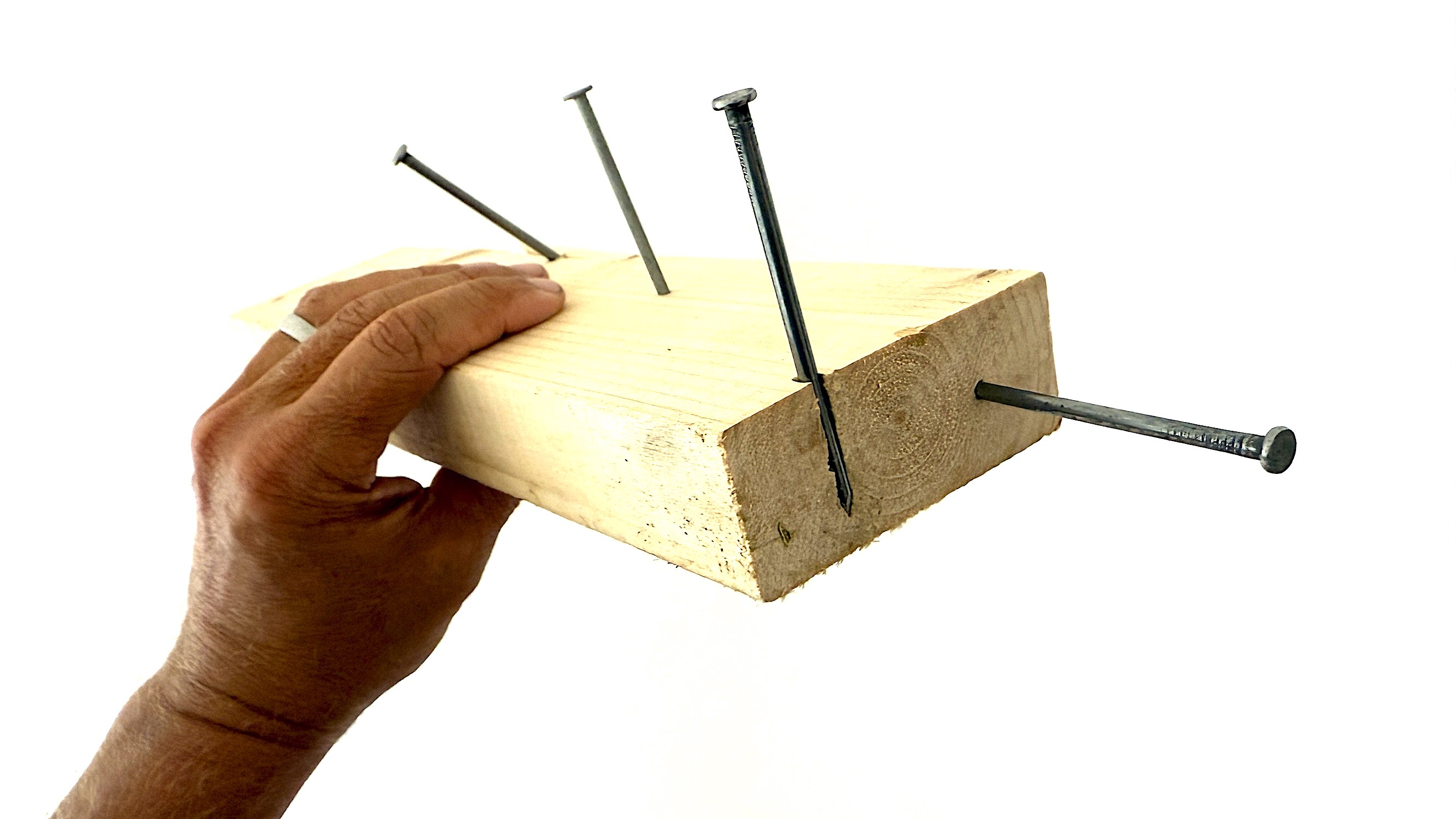

The image shows several 12d common nails driven into a piece of 2x4 wood.
The nail closest to you is driven at the end of the board and parallel with the grain of the wood, which runs down the length of the board. This end nail can be withdrawn easier in comparison to a nail driven on the face of the board, perpendicular to the wood grain.
Nails driven into the end grain of wood (parallel to the fibers) may have only 50-75% of the strength of nails driven into the side grain. End-grain nailing, even in intact wood, has significantly reduced capacity compared to side-grain nailing due to the absence of compressive friction from the perpendicular fibers. When splitting occurs, the capacity is reduced even further. It is a compounding problem, not a separate one.
The nail on the side is driven perpendicular to the wood grains providing the greatest holding capacity.
The nail on the right is an improperly toe-nailed fastener that has created a large open split in the wood.
The nail at the very end of the board is driven perpendicular to the wood grain to show how the wood fibers split and crack when the nail is driven into it.

The inspection image is of a toenailed fastener splitting open an edge of the band joist.
Wood naturally expands and contracts with moisture changes. When nails are driven into green lumber that later dries out, or into seasoned wood that goes through wetting and drying cycles, they can lose a major part of their withdrawal resistance.

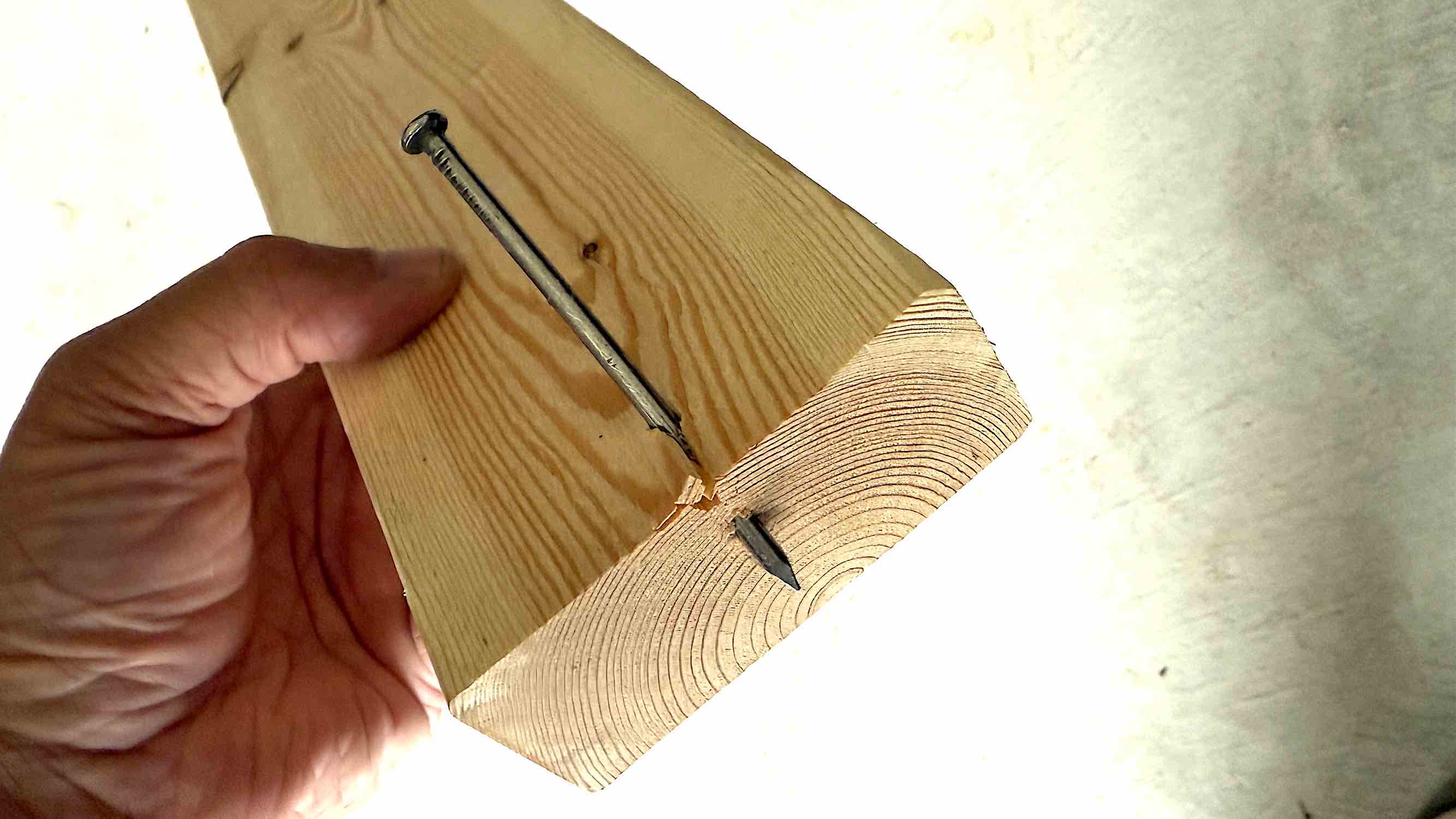

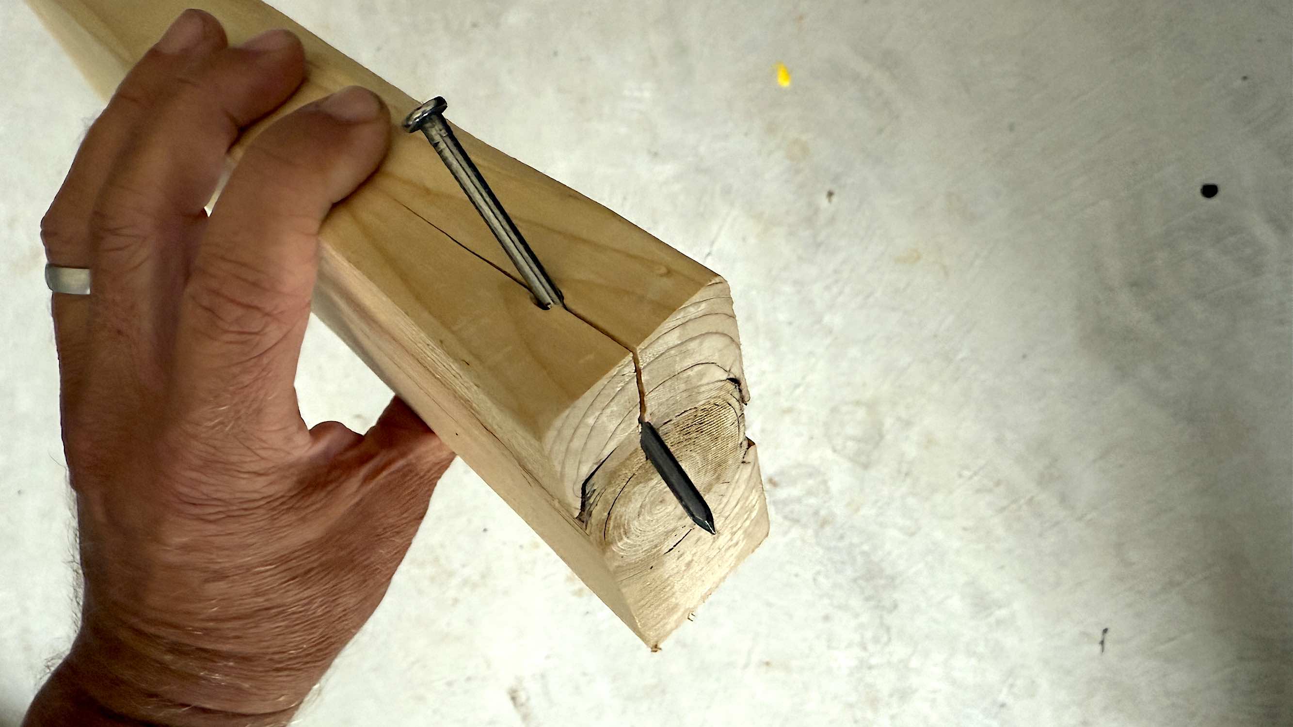

The image of a nail splitting open the end of a 2x4.

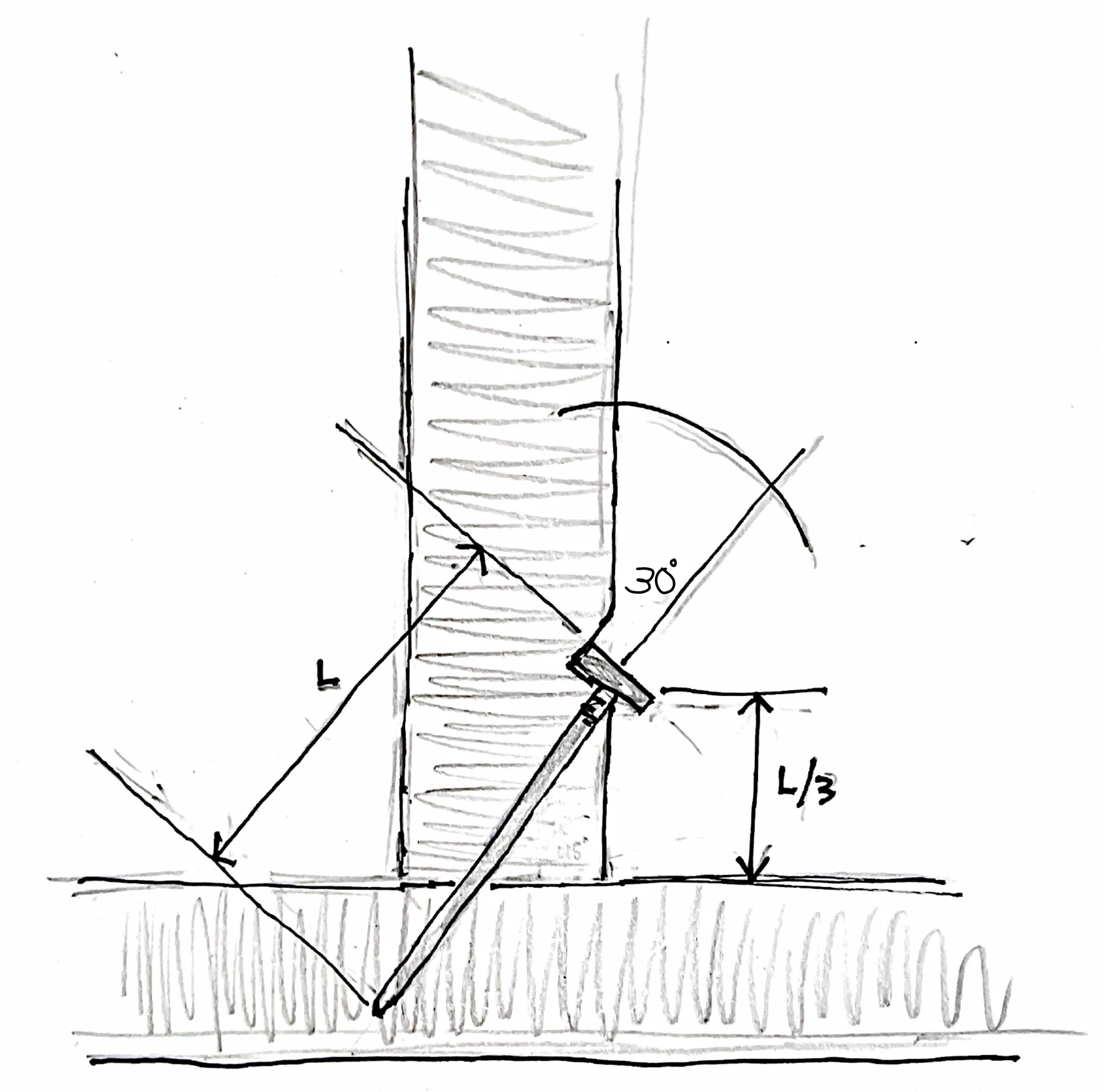

Driving a nail at an angle through the edge of one piece of wood into another creates a strong, angled connection. This technique secures wall studs to top and bottom plates, attaches floor joists to beams, band joists to sill plates, and more. When toenailing, a good technique could be to position the nail away from the end of the board at a distance equal to about one-third of the nail's length and at a 30-degree angle.
Research shows that the maximum strength of toenailed joints under lateral and uplift loads is obtained by:
  • using the largest nail that will not cause excessive splitting,
  • allowing an end distance (distance from the end of the attached member to the point of initial nail entry) of approximately one-third the length of the nail,
  • driving the nail at an angle of 30° with the attached member, and
  • burying the full shank of the nail but avoiding excessive mutilation of the wood from hammer blows.

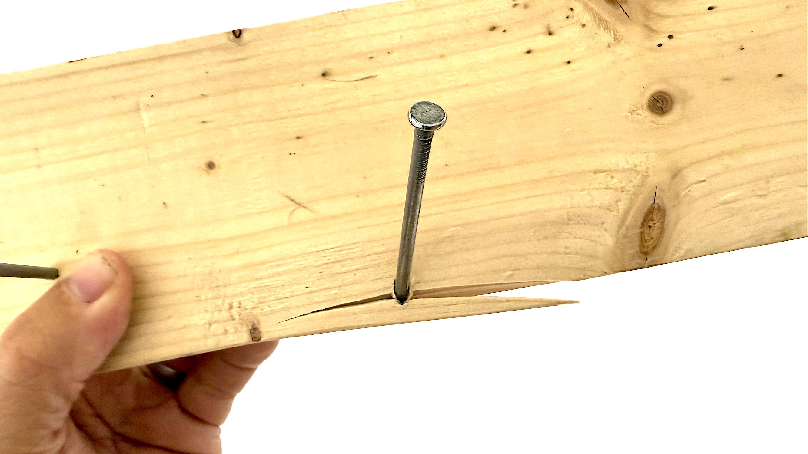

This image is of a nail splitting open the end of a 2x4.
