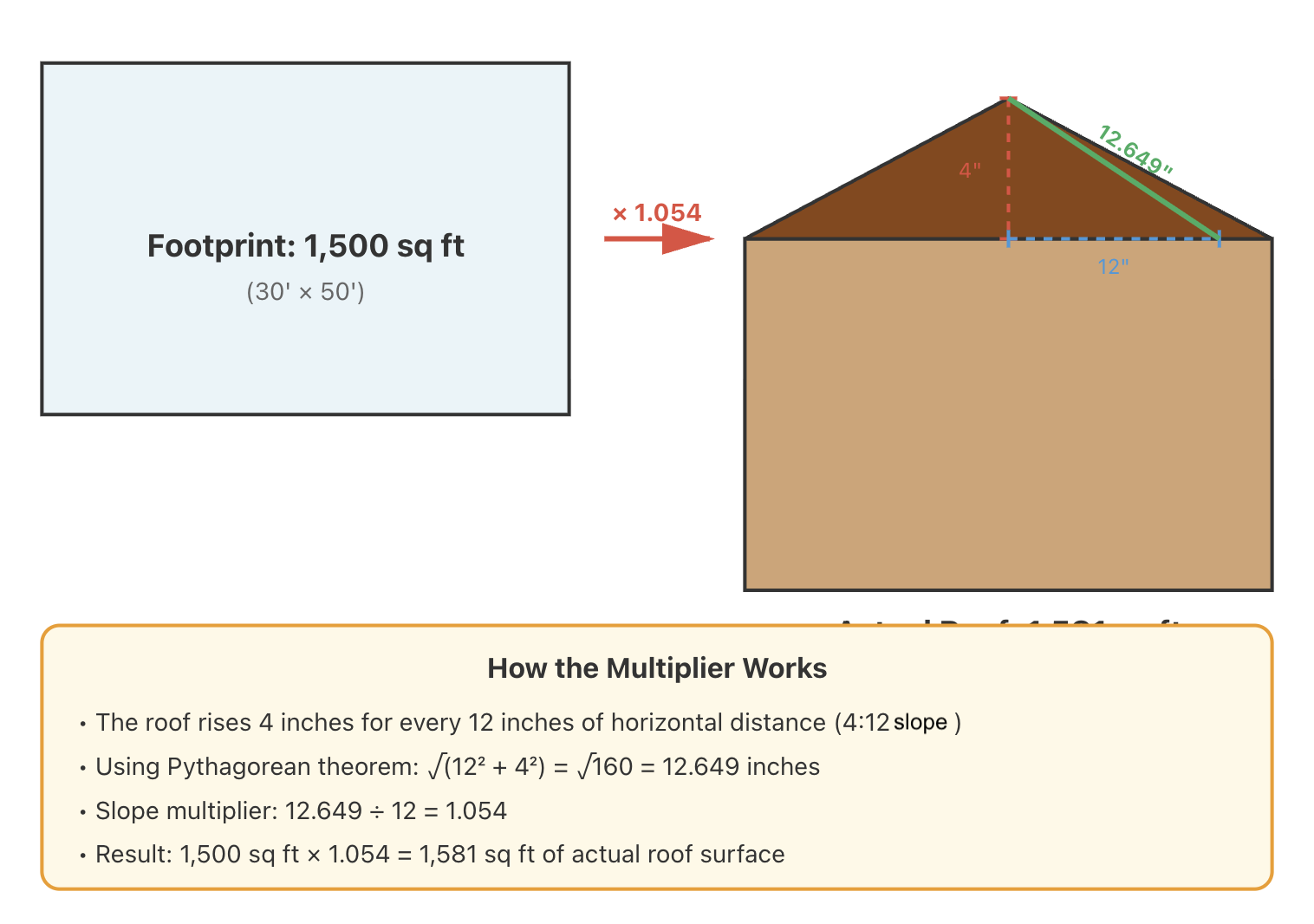

The roof slope multiplier is a shortcut number that accounts for the extra roof area created when a roof is sloped (angled) rather than flat.
Think about it this way: if you have a 30' × 50' house, the footprint is 1,500 square feet. But when you tilt that roof up at a 4:12 slope (which means the roof rises 4 inches for every 12 inches of horizontal run), you're creating more surface area than the flat footprint below it.
The slope multiplier of 1.054 means the actual roof surface is about 5.4% larger than the footprint. So instead of just 1,500 square feet, you have 1,581 square feet of roof to cover with shingles.
Here's the Math
For a 4:12 slope, you can use the Pythagorean theorem. If you go 12 inches horizontally and rise 4 inches vertically, the actual sloped distance (hypotenuse) is:
  • √(12² + 4²) = √(144 + 16) = √160 = 12.649 inches
So the multiplier is 12.649 ÷ 12 = 1.054
