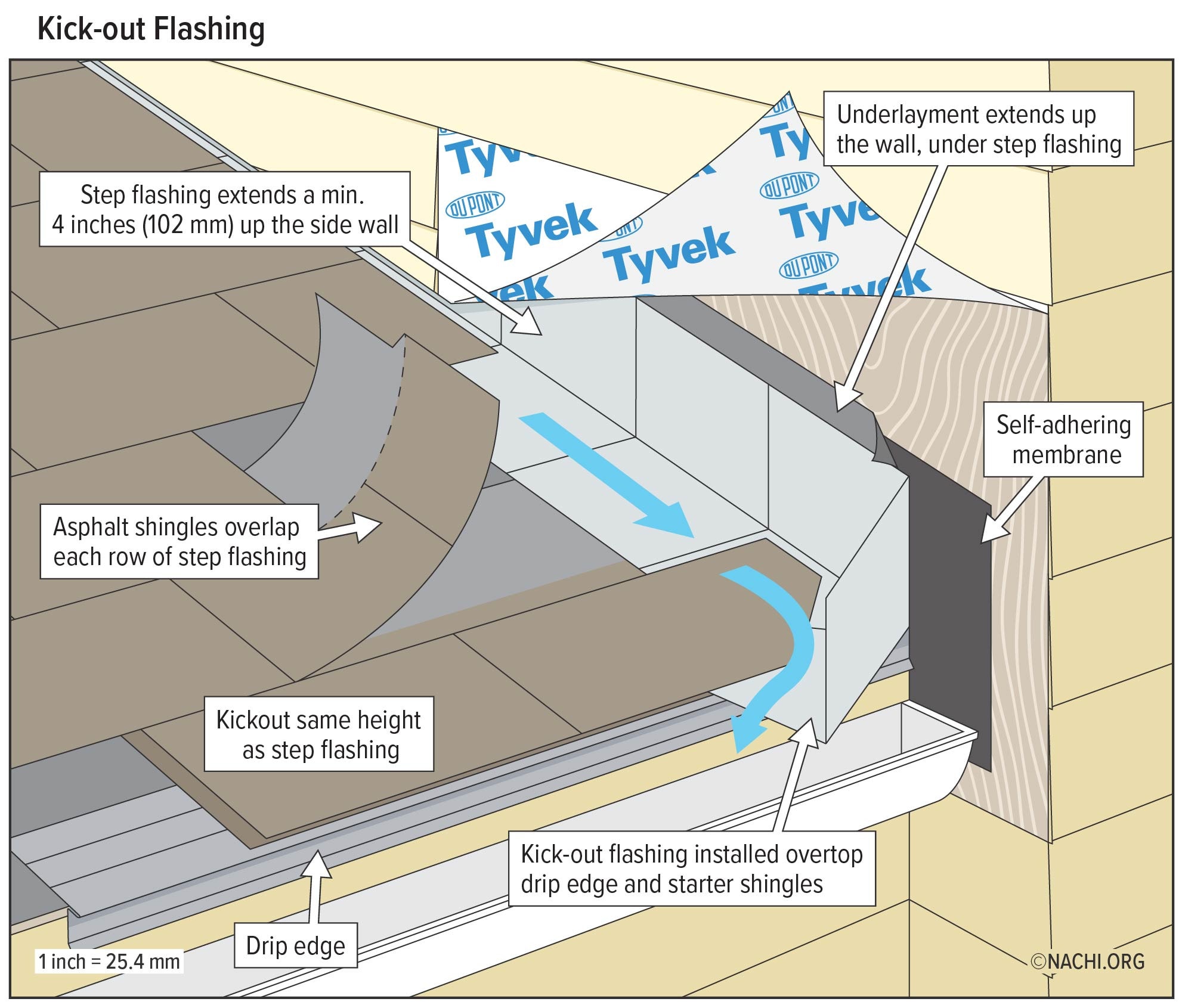

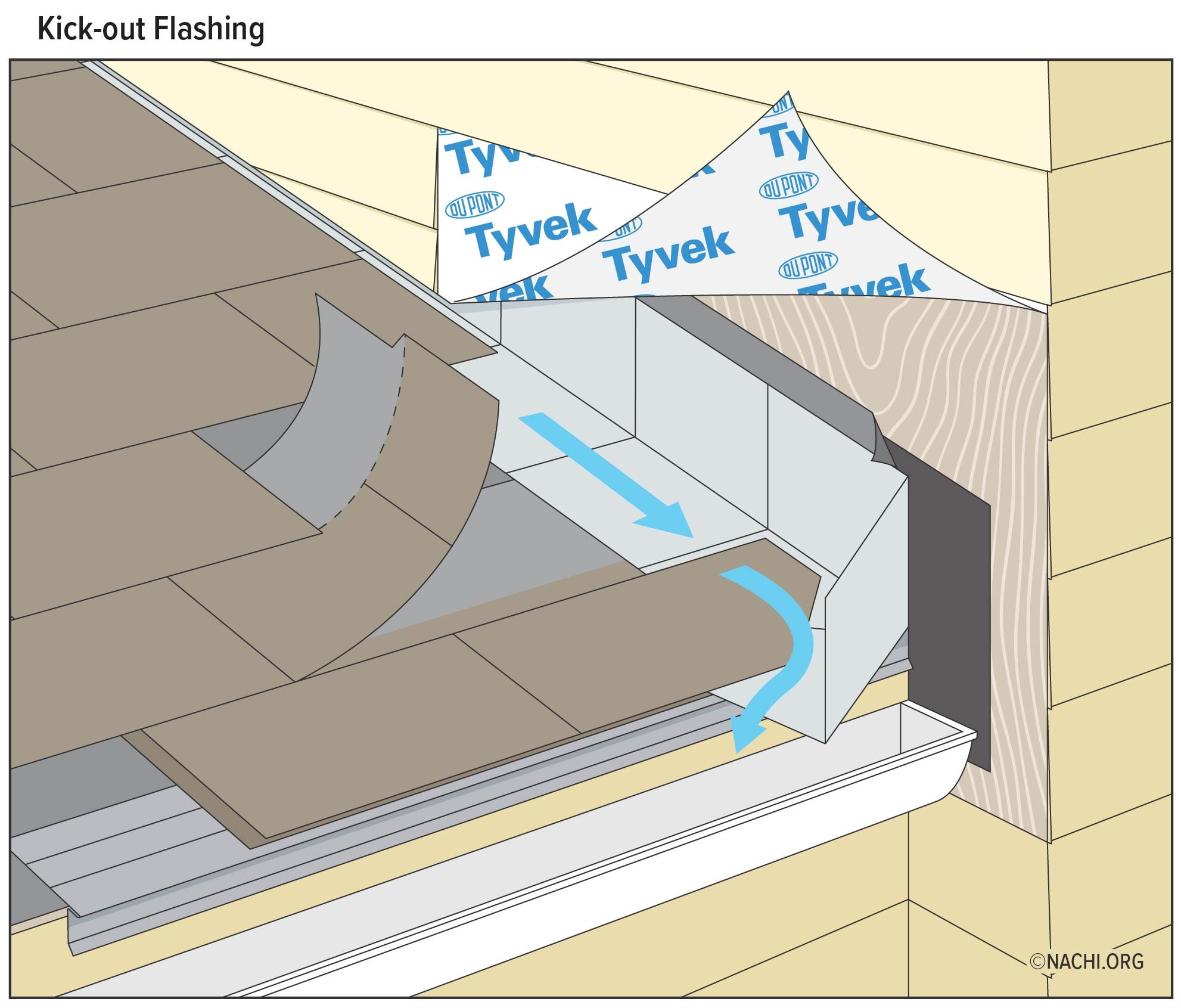

Kickout Flashing
In any location where a roof-wall flashing exists and the roof terminates on the wall, a kickout flashing
should be installed. This flashing is designed to prevent water from running down the flashing and
entering the wall system by diverting the flow away from the bottom of the roof-wall interface and to
the side outside of the siding material.
In any location where a roof-wall flashing exists and the roof terminates on the wall, a kickout flashing should be installed. This flashing is designed to prevent water from running down the flashing and entering the wall system by diverting the flow away from the bottom of the roof-wall interface and to the side outside of the siding material.
