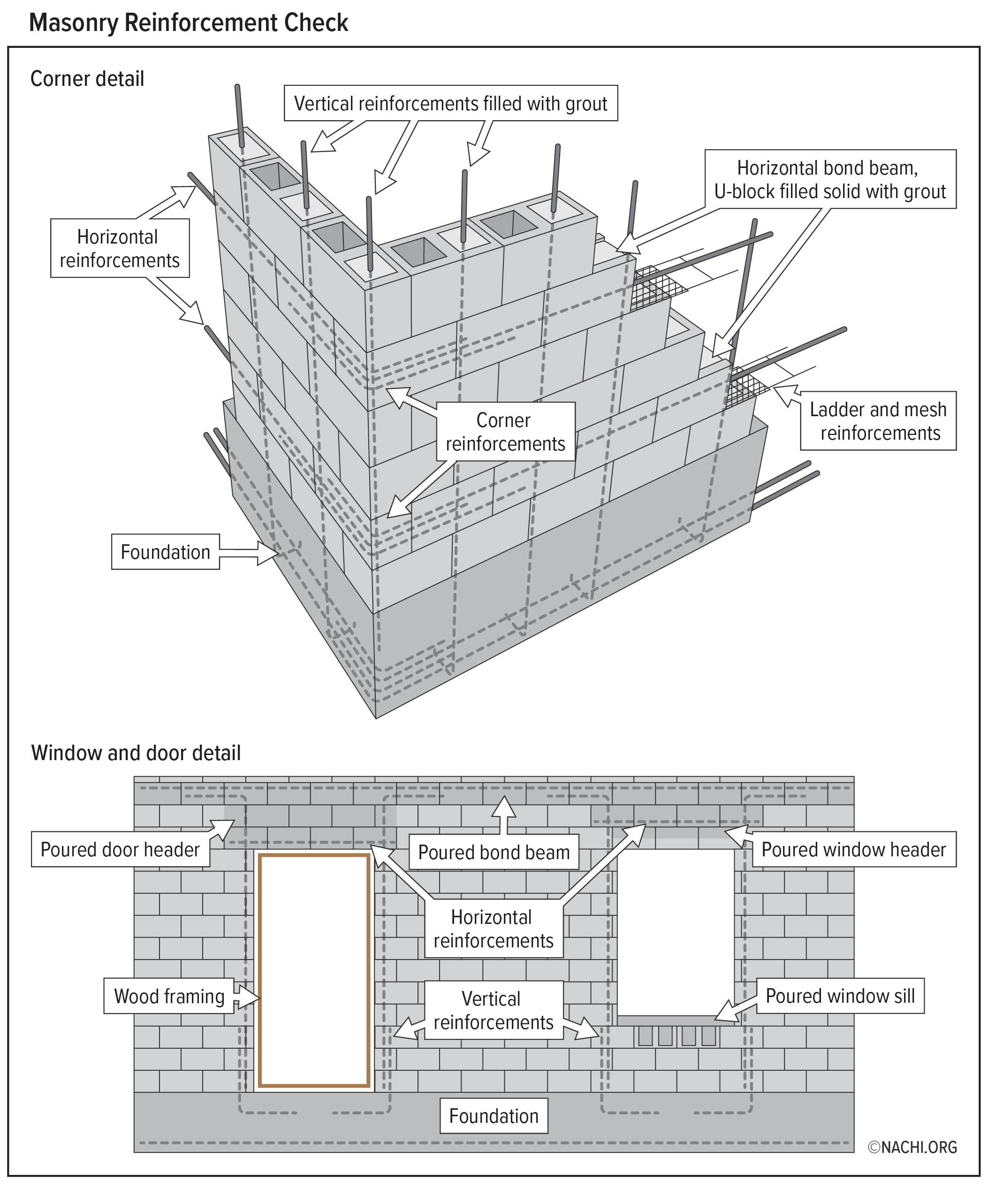

Masonry Reinforcement Check
Masonry walls should be checked for reinforcement. Definition of reinforced masonry requires
both horizontal and vertical rebar to be installed. Inspectors only need to confirm rebar at two
corners and one window or door opening for rebar on the entire house.
