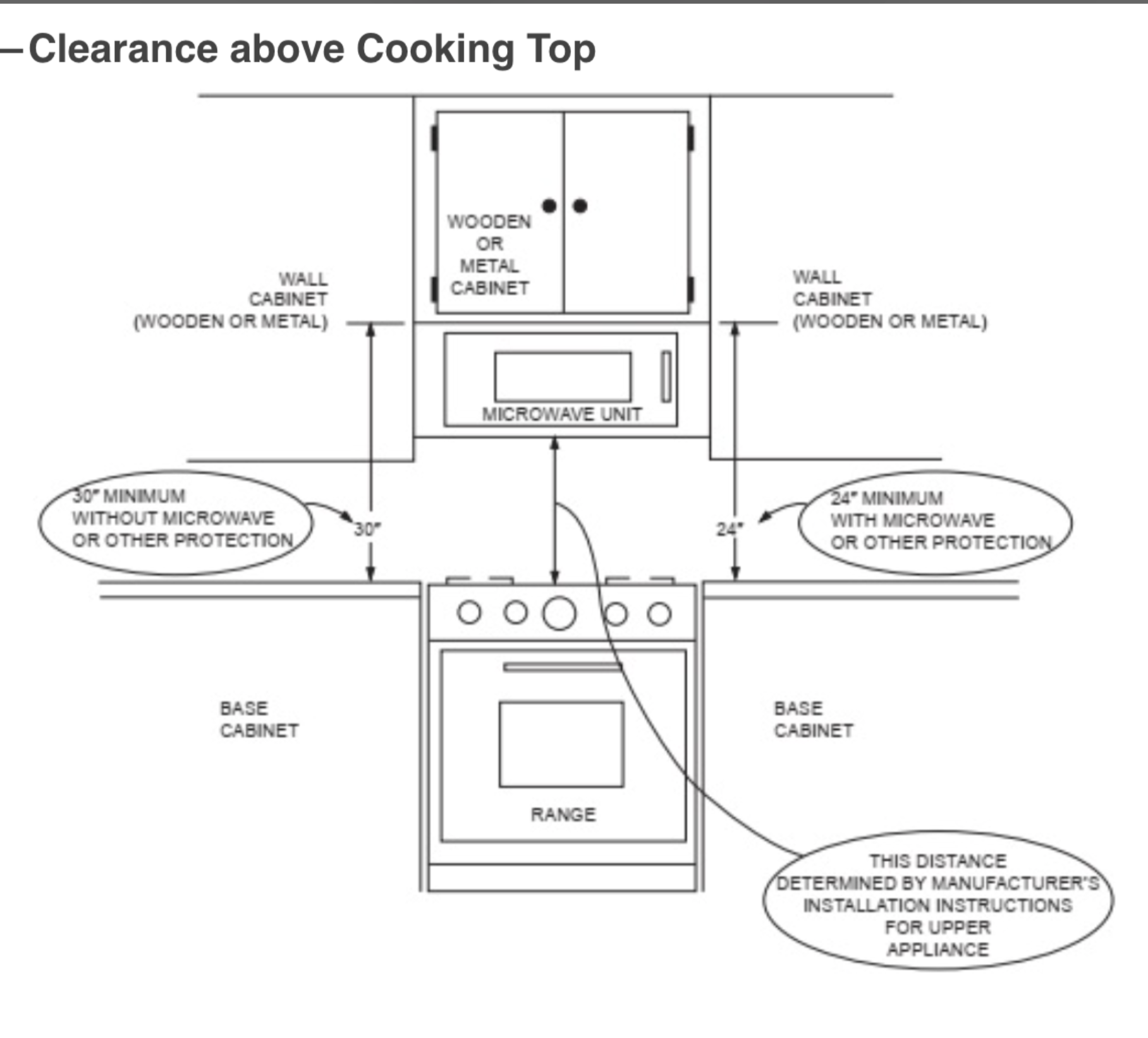

  • Check vertical clearance to combustible materials. Cook tops can produce intense heat. Household cooking appliances should have at least 30 inches (760 mm) of vertical clearance above the cooking top to combustible materials (framing, finishes, cabinets, shelving, soffit) and metal cabinets with combustible contents. A few exceptions permit a minimum clearance of 24 inches (610 mm), including when the underside of the combustible material or metal cabinet above the cooking top is protected by a microwave oven installed in compliance with the manufacturer's installation instructions. Refer to 2024 IRC G2447.5 (IFGC 623.7).
