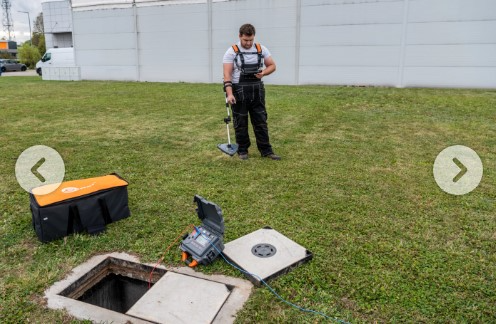

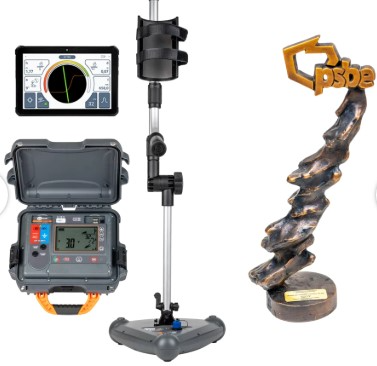

 The LKZ locator set consists of a LKN transmitter and LKD detector. It allows for location, identification and tracking of the route of objects buried in the ground. It allows to trace:
  • power cords and cables, control cables, telecommunications cables,
  • underground elements of lightning protection systems, cathodic protection systems,
  • water and sewage systems,
  • fuel transmission systems (pipelines, gas pipelines)
  • heating systems and pre-insulated pipes.
The sets of LKZ series are an invaluable support in earthworks carried out for various industries, including energy, installation, construction, railway, telecommunications, water and sanitary, heating, geodetic and many others.
LKN-2500 transmitter injects a locating signal into an underground object. LKD-2500 detector placed along the object traces this signal along the object. The information about position of the traced object is displayed on the Sonel LKZ Mobile app which is connected with the detector. Determination of the object’s route is possible based on observation of compass readings and the level of the detected signal.
The system has the ability to trace cables and record routes via the mobile application. Such files can be exported and shared with other users – including those who do not have the LKN-2500 / LKD-2500 device.
The system is capable of operating in passive mode (without the use of the LKN-2500 transmitter) and active mode (with the use of the LKN-2500 transmitter). The active mode allows to introduce the signal in three different methods:https://s3.amazonaws.com/uploads-east-1.nachi.org/chapters/images/180/Tq7vCzxxIeM31xVziZf06LtIvztT49CzGP8p2bIs.jpghttps://s3.amazonaws.com/uploads-east-1.nachi.org/chapters/images/180/w3Pzgtyl1buAftreBqQLL4kCUrjOqKpraZyutbIr.jpghttps://s3.amazonaws.com/uploads-east-1.nachi.org/chapters/images/180/zpOB04BnfR0taUSSs4XValiB97bxD9UKaflN1yIQ.jpg

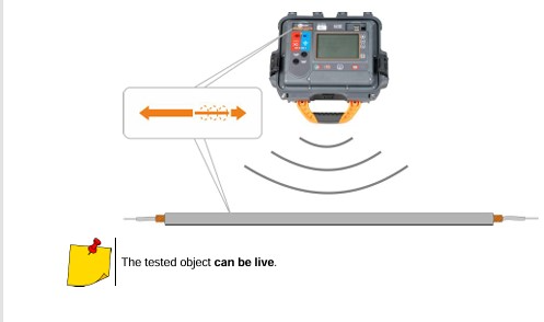

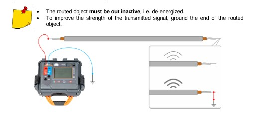

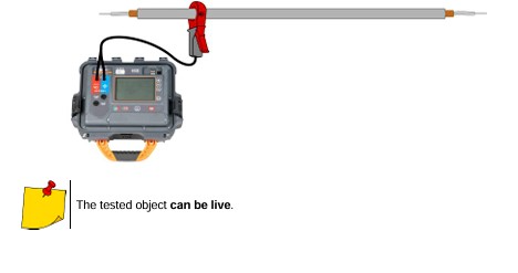

  • galvanic – injects tracing signal into the object directly, through crocodile clips and test leads,
  • clamp – injects tracing signal into the object through an inductive clamp,
  • inductive – injects tracing signal into the object inductively, using the instrument’s internal antenna.https://s3.amazonaws.com/uploads-east-1.nachi.org/chapters/images/180/fjf7deoWhVa6DcC3WAGpvA8Rj67FmNiiu2vanxYN.jpg

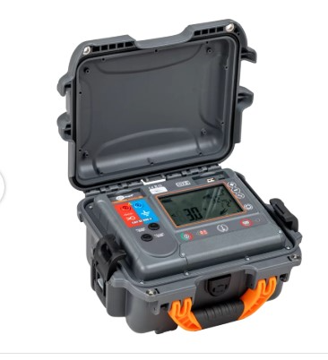

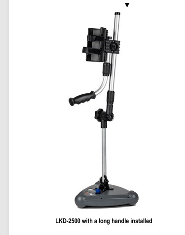

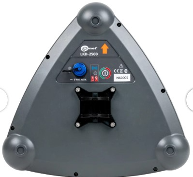

Transmitter LKN-2500
  • Operation in direct galvanic or inductive connection mode – internal transmitting antenna
  • Compatible with transmitting clamps
  • Rugged housing
https://s3.amazonaws.com/uploads-east-1.nachi.org/chapters/images/180/bBXwpCyY06apD4IOFbSgyImp2p0tAIdsmVOuDunK.jpghttps://s3.amazonaws.com/uploads-east-1.nachi.org/chapters/images/180/yiJtI7LauOYG6XStP8VPel9if0mADBlZU4HfQPSx.jpghttps://s3.amazonaws.com/uploads-east-1.nachi.org/chapters/images/180/HsQOxbskmYw3Br7lYNbZmHEIgL550wxpefPvzwXk.jpgDetector LKD-2500
  • Active mode
  • work with LKN-2500 transmitter at the frequencies of 8 kHz, 32 kHz (Signal mode)
  • Passive mode– work at the frequencies of:
  • 50 Hz, 60 Hz (Power mode)
  • 2...65 kHz (Radio mode)

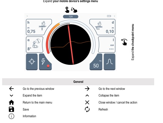

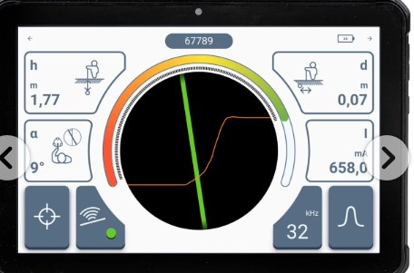

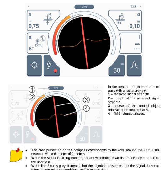

Sonel LKZ Mobilehttps://s3.amazonaws.com/uploads-east-1.nachi.org/chapters/images/180/pJM3nE3isd0H98KVM7loWGaaSuPuBEyTApTEulhJ.jpghttps://s3.amazonaws.com/uploads-east-1.nachi.org/chapters/images/180/VSr9cc1tBNQbDyAN1uR9cKsmN5jgNoGn5Pu8bu4N.jpghttps://s3.amazonaws.com/uploads-east-1.nachi.org/chapters/images/180/HQhFEjKL4PoCGrjcjczR0cBKGplmVKz2tEkOVkep.jpg
The application works with Sonel LKD-2500 detector. It enables tracing of objects, recording of routes in the memory of the mobile device along with GPS positions of waypoints and additional readings.
The application additionally enables:
  • live positioning preview,
  • measuring the distance to a specific waypoint,
  • export of routes to other mobile devices,
  • reading routes from the mobile device’s memory,
  • preview of all recorded parameters,
  • merging routes,
  • adding notes to routes and measurement points.

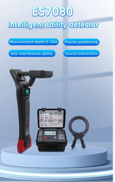

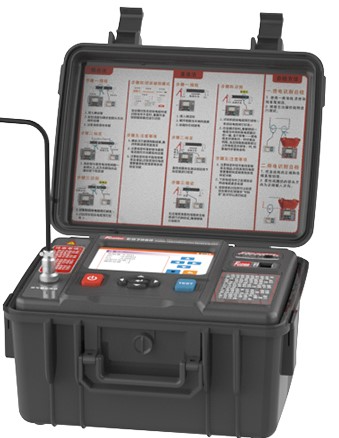

Training on Cable Detection by Using FUZRR ES7080 Smart Utility Locator - Cable Detection NCE NCD PLANT MAP SS 576 (Approved by Singapore Chapter of InterNACHI)
https://s3.amazonaws.com/uploads-east-1.nachi.org/chapters/images/180/ZCWx2cwbWSCrvYj6dstBdaSdeM0FHfANXKAq0Sd3.jpg

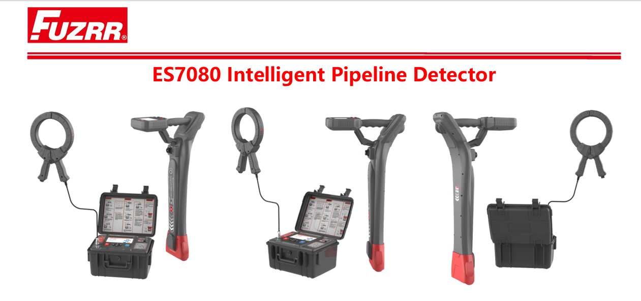

The China-made UZRR ES7080 Utility Underground Locator is the latest smart locator among the current EM-electromagnetic locator market. The Singapore Chapter of InterNACHI (InterNACH-SC) approves the one-day training course on Cable Detection by using FUZRR ES7080 Smart Utility Locator. The training shall cover cable detection techniques, nine authorities stipulated steps, NCD, NCE, SS 576, Electricity Act, Telecommunication Act, LCDW, and TCDW regulations.   The EMA-licensed LCDW and IMDA-licensed TCDW shall conduct the training.
Video1:https://www.tiktok.com/@fuzrrtester/video/7403944385076808961
Video 2: https://www.tiktok.com/@fuzrrtester/video/7379038153908161809https://s3.amazonaws.com/uploads-east-1.nachi.org/chapters/images/180/N7h5LtklP7uxWkVWOnKi1swEUnbroTe7rhQ9zbtO.jpg

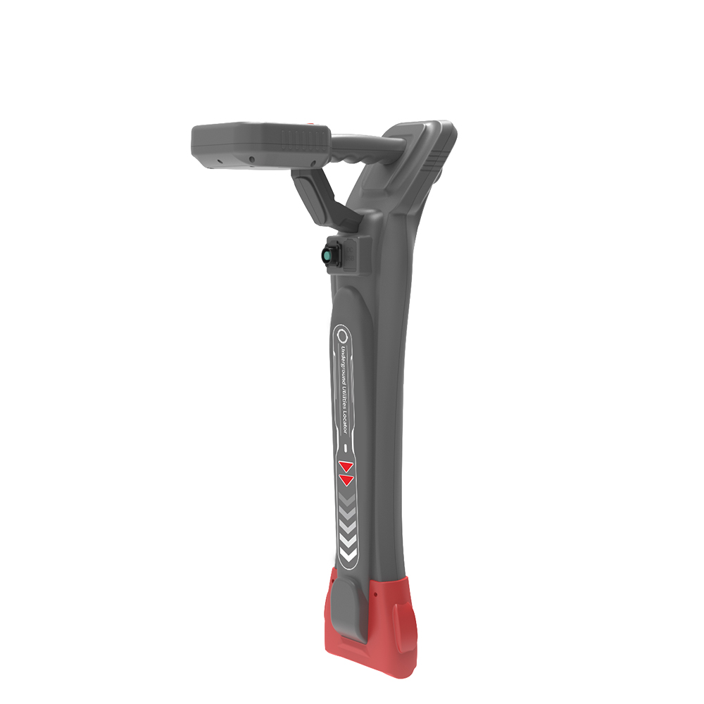

Intelligent Utility detector, also known as Utility locator, Path Locator, is a very comprehensive path detection instrument. It has pipeline path detection, cable identification, fault search and other functions. The instrument is composed of transmitter, transmitting current clamp, receiver, receiving flexible current clamp, connecting test line, A-word frame (optional), etc. Intelligent Utility detector can be used for path detection, pipeline survey and depth measurement of metal pipelines and underground cables under trenchless excavation. The instrument uses a variety of filtering technologies, has anti-interference ability, and can accurately locate and measure the depth. It is suitable for the detection and patrol of various underground metal pipeline, pipeline management and maintenance, municipal planning and construction, power supply and other departments, and is one of the necessary instruments of pipeline maintenance units. This function is realized by the signal transmitter, receiver, signal transmitting clamp and connecting test line.
The instrument has the following characteristics:
1. Multiple detection modes: classical positioning mode, wire cruise mode, signal distortion measurement mode;
2. Classic positioning mode: compass, direction and signal amplitude display, visually display the left and right direction of the pipeline。
3. Lead cruise mode: 360 omnidirectional pipeline path indication, continuous display of depth, current, and pipeline relative position. The interface is simple and intuitive, and it can be operated without experience
4. Signal distortion measurement mode: the peak and trough wave form should be displayed at the same time. In the field without distortion, the peak and valley value position should be consistent, and the field shape should be symmetrical relative to the centrol line.
5. Current direction determination (partial frequency), can be calibration current direction, eliminate adjacent line interference, to prevent tracking errors.
6. Full digital high-precision sampling processing: stable and reliable, ultra-high sensitivity, extremely narrow reception frequency band, strong anti-interference ability, can fully inhibit the power frequency and harmonic interference of adjacent running cables and pipelines.
7. Multiple detection frequencies: 11 active detection frequencies and 3 passive detection frequencies.
8. Transmitter a variety of signal output: direct output, caliper coupling, induction method.
9. Transmitter digital amplifier power output, automatic impedance matching, automatic protection.
https://s3.amazonaws.com/uploads-east-1.nachi.org/chapters/images/180/23GD4U1TqMkEzd9z9eHUDQzI5SHciMWXk8o8BDv4.jpg
Cable identification is designed for power cable engineers and cable workers to solve the technical problems of cable identification. It can be used to identify live and blackout cables. The user can accurately identify one of the target cables from multiple cables through the instrument to avoid serious accidents caused by mistaking live cables.
For cable identification, 20 cables can be pre-calibrated at the transmitter and then received and identified at the remote end, which greatly saves the time of engineering personnel to and from calibration operation and improves work efficiency. The cable identification is successfully marked with √, and the non-target cable is marked with ×, which can quickly and automatically identify the target cable. The function is realized by the cooperation of signal transmitter, receiver, signal transmitting clamp, connecting test line and flexible caliper.
 https://s3.amazonaws.com/uploads-east-1.nachi.org/chapters/images/180/0F6OoLxedrSWzm7EJpmOihjNSjITTHW3zQ9sOfIN.jpg

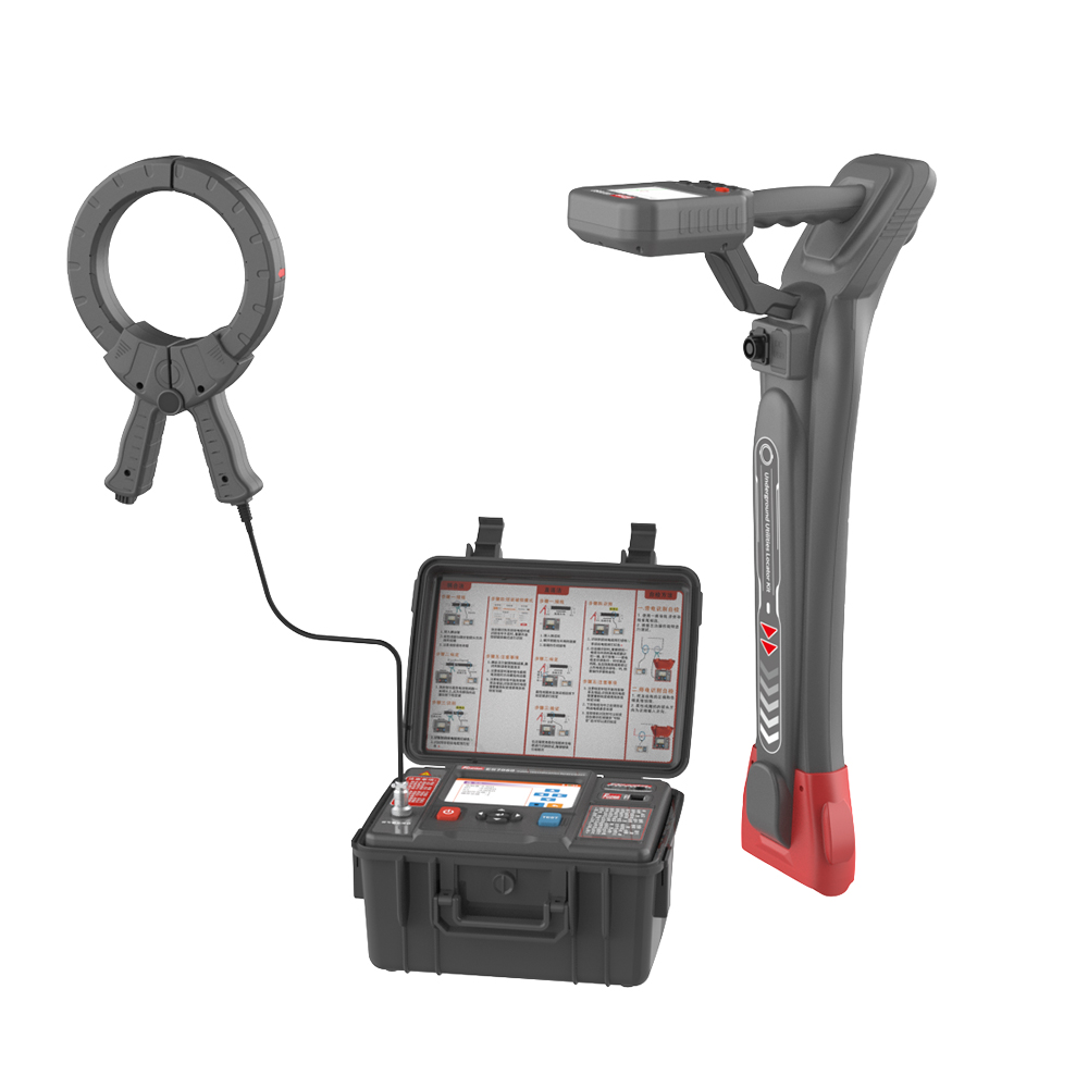

Signal transmitter: used for pipeline path detection and cable identification. The device can add identification signals to the target cable through direct connection output, caliper coupling, induction method, and other methods. There are 11 different pulse signals of 640Hz, 1.28kHz, 2.56kHz, 3.20kHz, 4.09kHz, 8.19kHz, 10.2kHz, 32.7 kHz, 65.6 kHz, 81.9 kHz, and 197 kHz. The maximum signal output power is 15W, and 6 levels are adjustable, adapting to different application environments, making pipeline detection and cable identification more accurate and reliable. Instrument built-in large function rate can be charged with lithium battery, automatic impedance matching, automatic protection. The transmitter adopts the integrated special toolbox design, its box can withstand the pressure of about 200kg, the host 5 inches of the capacity touch LCD display, real-time dynamic display signal output status and battery usage.
 https://s3.amazonaws.com/uploads-east-1.nachi.org/chapters/images/180/5B0M6ox325D0VcU5YUOi3QHwPbTFO4UKAnPs1udD.jpg

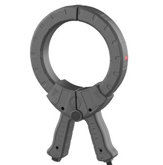

Transmitter clamp: suitable for caliper coupling method. The transmitter clamp couples the signal emitted by the transmitter to the target cable, and the jaw size is Φ 125mm. The transmitter clamp is directional, and the transmitted signal flows in from the direction indicated by the arrow on the transmitter clamp.
 https://s3.amazonaws.com/uploads-east-1.nachi.org/chapters/images/180/zUnx79DdYVOr0GN8WInTsYevAeliiKsyPd4TjFch.jpg
Receiver: Used for pipeline path detection and cable identification. Built-in multiple shielded 3D antennas, It can effectively identify 13 different pulse coded current signals of 640Hz, 1.28kHz, 2.56kHz, 3.20kHz, 4.09kHz, 8.19kHz, 10.2kHz, 32.7kHz, 65.6kHz, 81.9kHz and 197kHz generated by the transmitter. It can also identify 50Hz and 60Hz power frequency signals and RF signals with center frequencies of 32.7kHz and 81.9kHz. Using 4.3 inch capacitive touch LCD screen, real-time dynamic display 360° omnidirectional pipeline path indication, depth, current and relative position of the pipeline.
Flexible current clamp: Used for cable identification. The current clamp is a Roche coil, which has excellent transient tracking ability, can quickly identify the pulse width frequency signal generated by the transmitter, and is suitable for thick cables or irregularly shaped conductors. The inner diameter of the clamp is about 200mm, which can clamp the cable below Φ 200mm, without disconnecting the measured line, non-contact measurement, safe and fast.
If you are interested in the one-day hands-on training on the cable detection by using FUZRR ES 7080, please contact Ms Devi, Tel: (65) 6992 2730/1, 6038 5026/7/8, Mobile: (65) 8234 5571, WhatsApp: (65) 8224 8216 or email: [email protected], or [email protected], or [email protected]. Address: Golden Sultan Plaza, 03-24, 100 Jalan Sultan, Singapore 199001.
