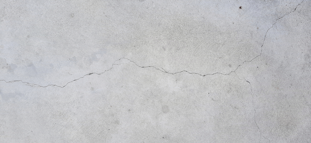

There are only two types of concrete: the kind that's already cracked and the kind that will crack. And the most concerning crack is one that water uses as a pathway to infiltrate the foundation.

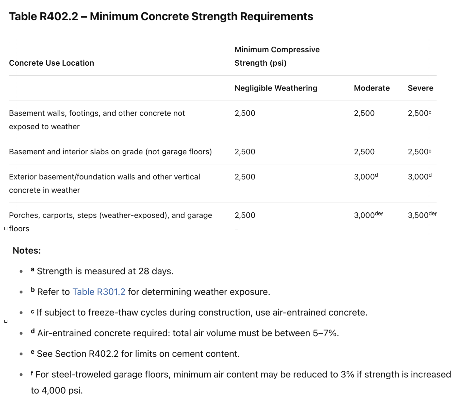

Chapter 4 of International Residential Code (IRC) establishes minimum strength requirements for different concrete applications in residential construction, based on the specific stresses each element must withstand. Inside the code book, there's recipe for concrete. It explains how strong different types of concrete need to be depending on where they're used in a house. Code makes sure contractors use concrete that's strong enough for each specific job. Think of it like this: you need strong boots for hiking and slippers for walking in your living room. Similarly, concrete that supports an entire house needs to be stronger than concrete used for less critical purposes. These requirements help ensure your home is built safely and will stand the test of time. Below is the IRC Table R402.2.
The minimum concrete compressive strengths range from 2,500 to 3,500 psi. Table R402.2 specifies the required compressive strength of concrete based on the weathering potential and a building element's exposure.
  • Interior applications (footings, foundations, and basement slabs): minimum 2,500 psi
  • Exterior slabs exposed to weather (patios, walkways, driveways): minimum 3,000 psi
These requirements aren't arbitrary—they're carefully calculated to ensure concrete can resist the specific environmental and structural forces it will encounter throughout a home's lifespan.

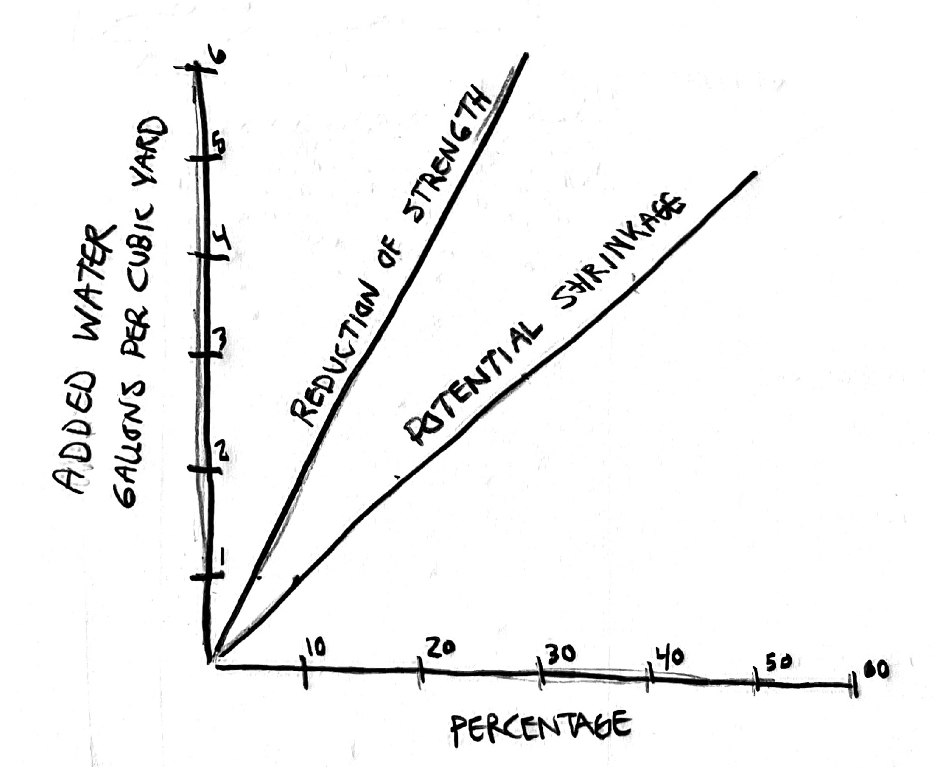

The ratio of water to cement in mixing concrete can controlled to ensure that the concrete reaches the specified strength. Adding more water when mixing concrete makes it easier to work with, but it creates two big problems: the concrete gets weaker (can't hold as much weight) and it shrinks more as it dries (causing cracks).
On site, contractors should add the minimum amount of water needed to make the concrete workable. The sketch shows that adding just 2 gallons of water per cubic yard of concrete makes it 10% weaker and causes 20% more shrinkage. This is why properly mixed concrete is so important for things like driveways and house foundations.
  • Higher water content during mixing directly reduces compressive strength (psi rating)
  • Every gallon of water added per cubic yard beyond the designed mixture reduces strength by approximately 200 psi
  • Concrete mixed at the minimum 2,500 psi for interior applications could drop below code requirements if excessive water is added on-site

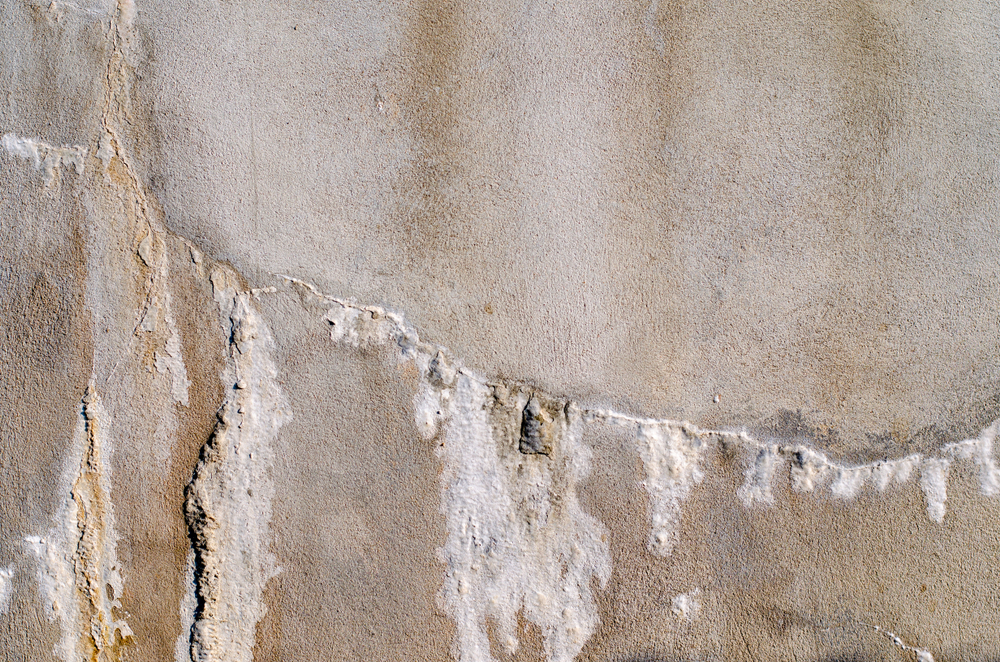

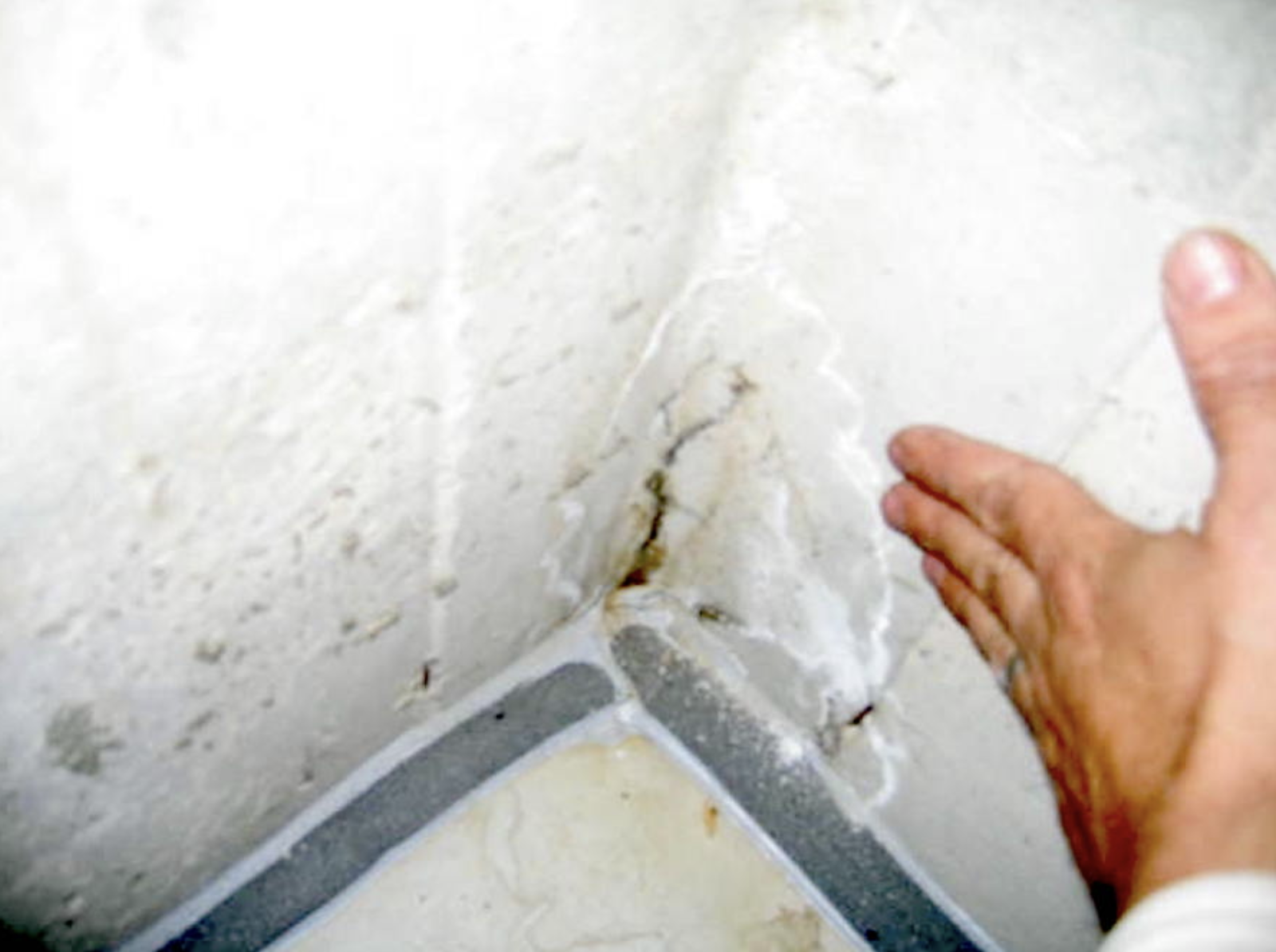

  • Foundation walls showing efflorescence: Indicates ongoing capillary moisture migration that may be compromising the concrete's structural integrity below the required 2,500 psi effective strength

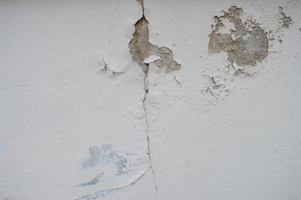

  • Exterior slabs with cracking, scaling, or spalling: Suggests concrete that likely didn't maintain the IRC-mandated 3,000 psi necessary to withstand freeze-thaw cycles, possibly due to excessive water addition during placement
  • Basement slabs showing signs of moisture migration: May indicate concrete that technically met code requirements for compressive strength (2,500 psi) but contains excessive capillary networks due to high water-cement ratios during mixing

Water plays a paradoxical role in concrete's lifecycle—it's both essential for the initial chemical reaction that creates concrete and the primary agent of deterioration over time. Excessive water creates permanent capillary networks that remain after curing. Excess water reduces strength. Capillary action draws moisture pathways. Internal pressures can damage concrete.
When inspecting concrete systems, visible conditions provide critical clues about invisible structural integrity, including efflorescence, cracking and spalling, and moisture intrusion.
