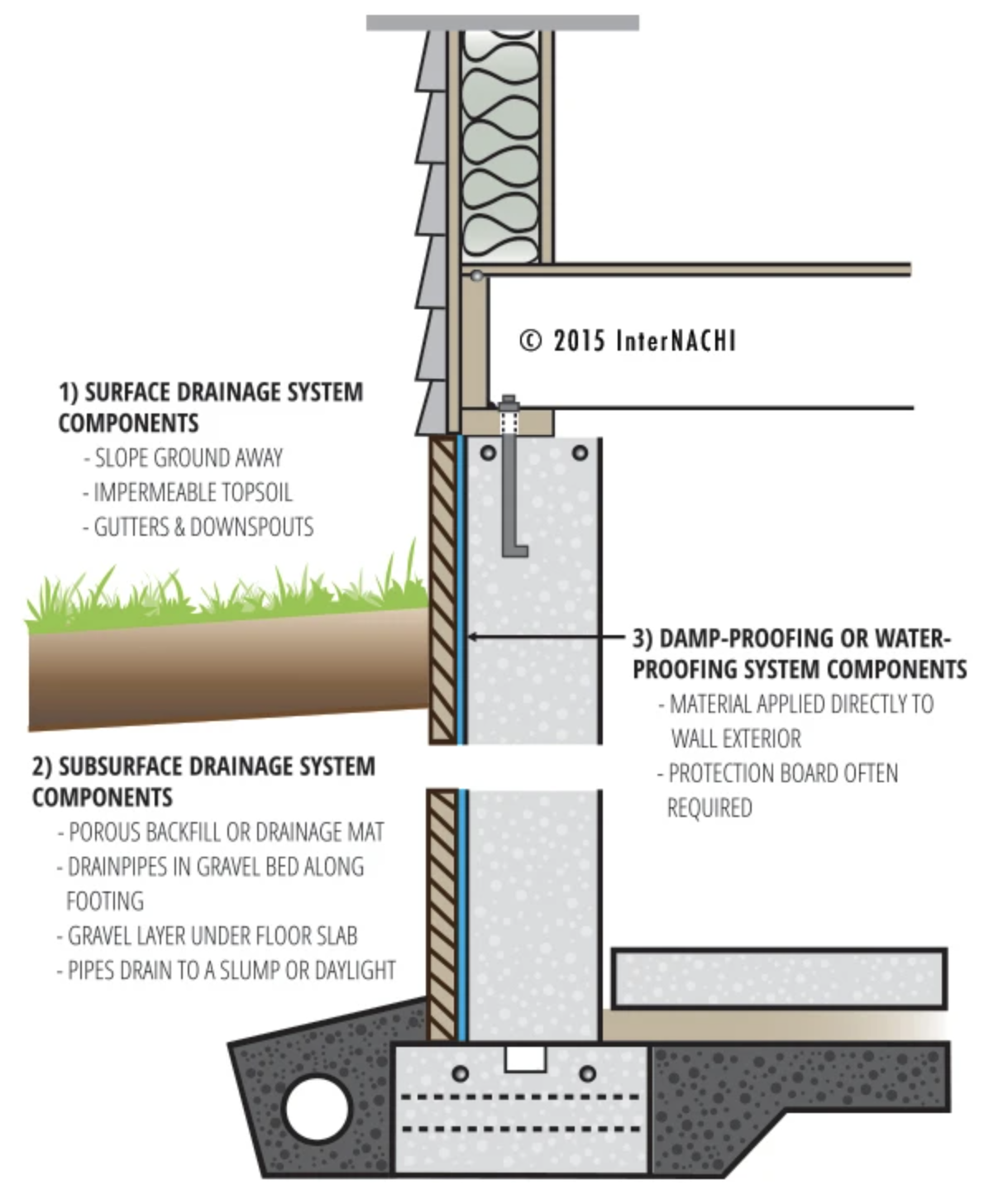

Effective foundation water management involves three critical and interconnected components: (1) surface drainage that slopes the ground away from the structure, uses impermeable soils, and directs downspouts away from the foundation; (2) subsurface drainage systems that collect and redirect groundwater away from the foundation; and (3) foundation dampproofing or waterproofing that creates a moisture barrier at the foundation wall. While all three components work together to protect a structure, this inspection training article focuses specifically on subsurface drainage systems, the often invisible but crucial final defense against moisture intrusion. This article dives deep into the critical components of foundation drainage systems as outlined in Section R405 of the International Residential Code® (IRC®), providing you with practical inspection strategies that translate technical code requirements into actionable field observations.
Water intrusion represents one of the most significant threats to residential structural integrity, particularly in below-grade spaces. According to the American Housing Survey data, out of the 145 million homes in the United States, approximately 11.7 million homes experience water leakage from outside the structure, and 2.8 million homes face water intrusion problems, specifically in the basement and crawlspace. These statistics underscore the critical nature of proper foundation drainage systems. As professional home inspectors, our ability to identify, assess, and document foundation drainage systems directly impacts our clients' financial security and well-being.
The Critical Role of Foundation Drainage

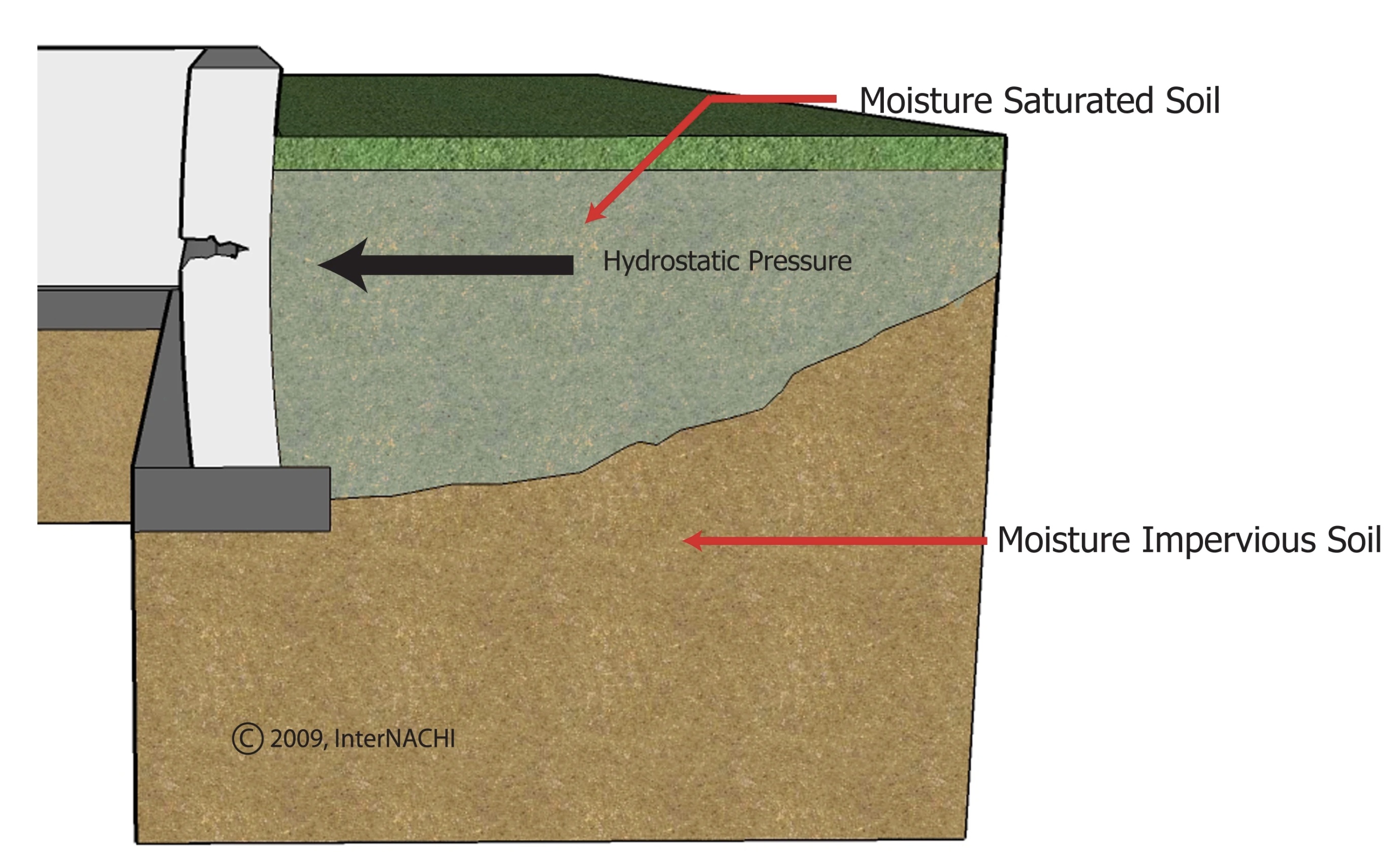

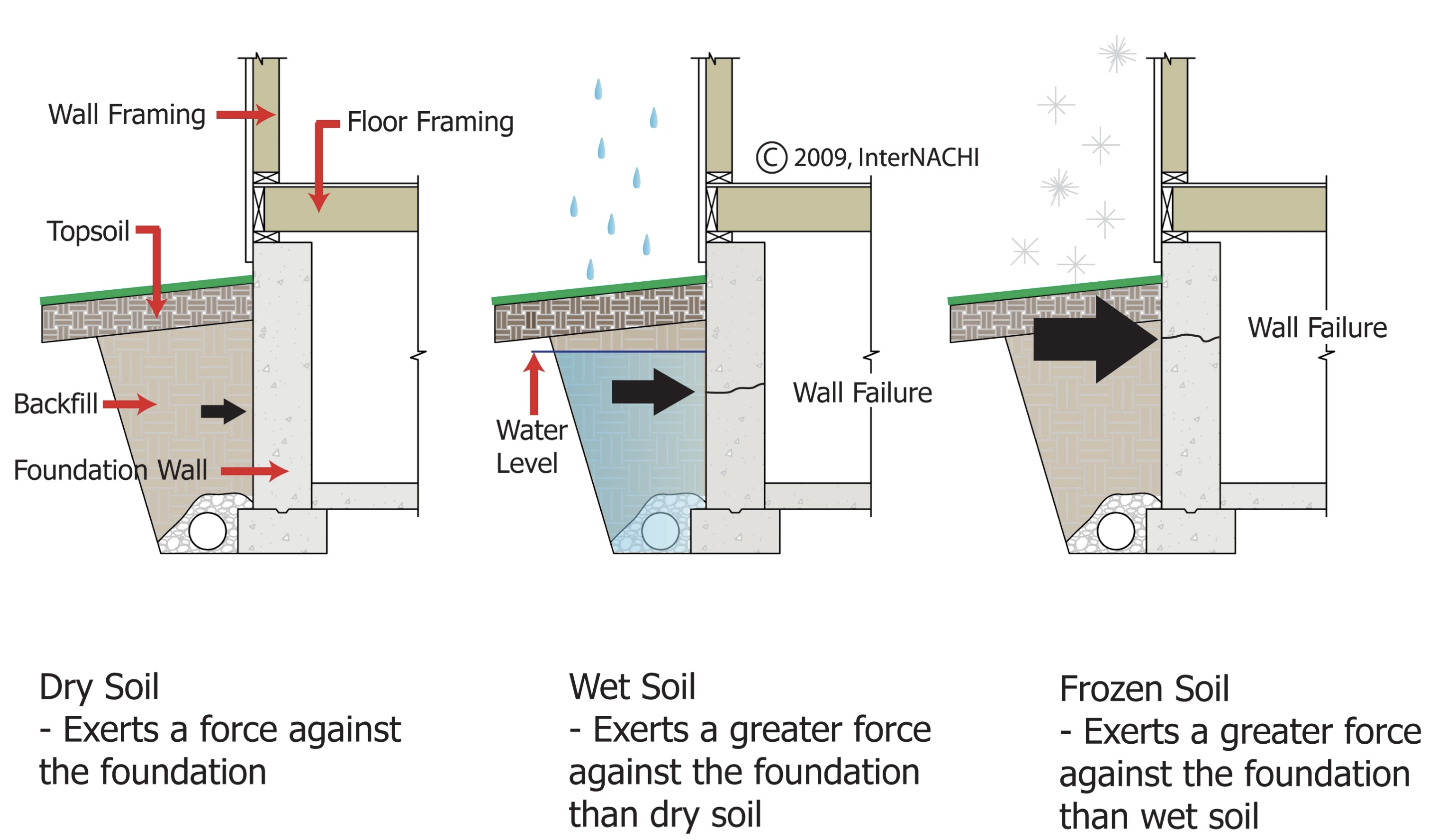

Foundation drainage systems serve as the first line of defense against hydrostatic pressure—the force exerted by groundwater against foundation walls.

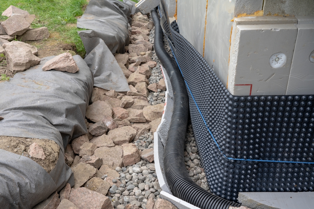

Per IRC Section R405.1, the code permits several approaches to foundation drainage:
  • Drainage tiles or drainage pipes
  • Gravel or crushed stone drains
  • Other approved systems or materials
The code explicitly requires that regardless of the specific approach utilized (drainage tiles, gravel or crushed stone drains, perforated pipe, or other approved systems or materials), the system must be installed at or below the top of the footing or below the bottom of the slab.
This strategic placement, as mandated by IRC Section R405.1, ensures that water is intercepted before it can exert pressure against the foundation wall or migrate through the joint between the wall and footing. Remember: water is patient, persistent, and apparently has nothing better to do than find ways through foundation. Our job is to give it a more appealing alternative route.

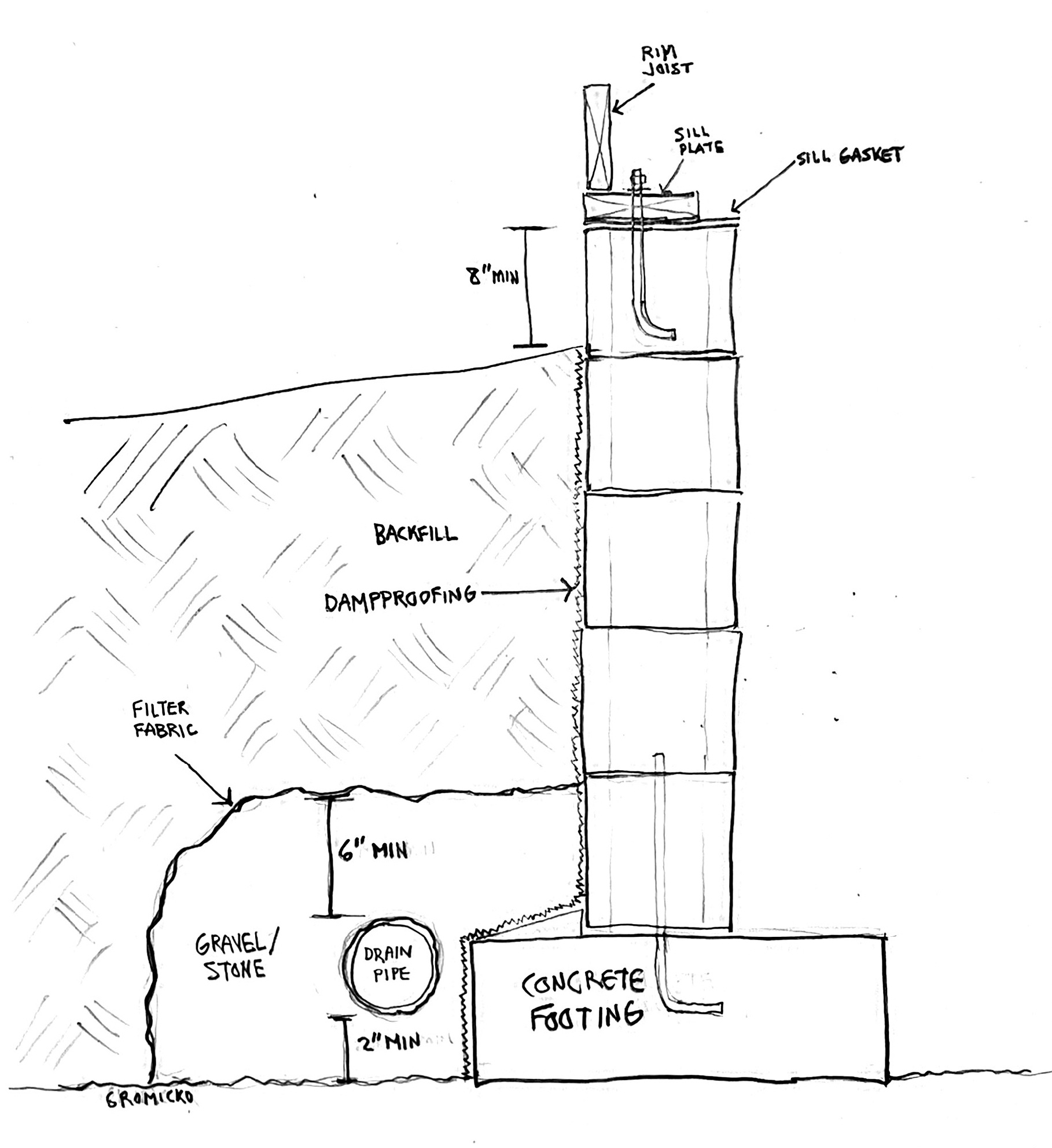

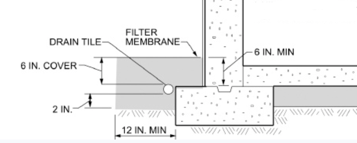

2. Proper Dimensioning and Coverage

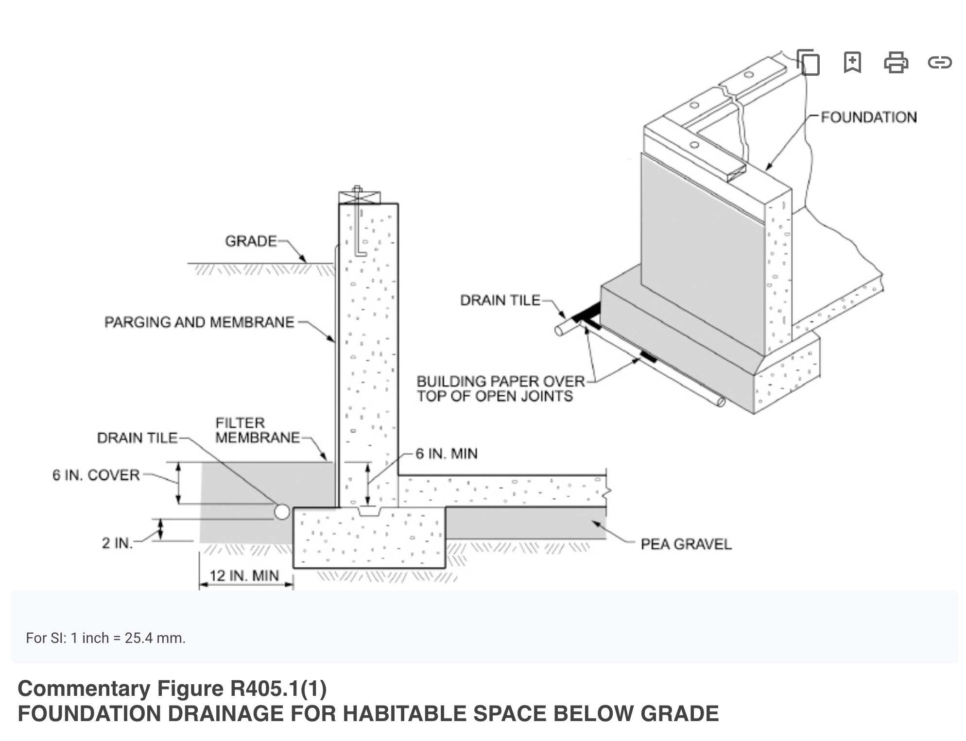

When inspecting gravel or crushed stone drains, IRC Section R405.1 requires verification that they:
  • Extend at least 1 foot (305 mm) beyond the outside edge of the footing
  • Extend at least 6 inches (152 mm) above the top of the footing
  • Are covered with an approved filter membrane material

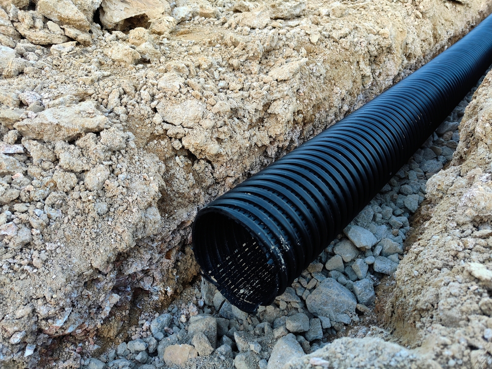

For drainage tiles or perforated pipes, IRC Section R405.1 mandates that they:
  • Rest on not less than 2 inches (51 mm) of washed gravel or crushed rock
  • Are surrounded by material that is at least one sieve size larger than the tile joint opening or perforation
  • Are covered with not less than 6 inches (152 mm) of the same material

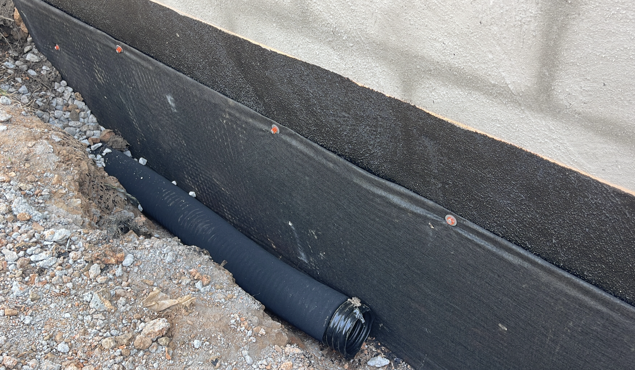

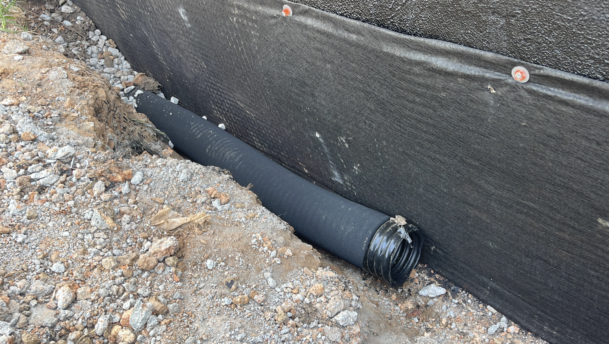

3. Protection Mechanisms
Several protection mechanisms are required by IRC Section R405.1 to ensure long-term system performance:

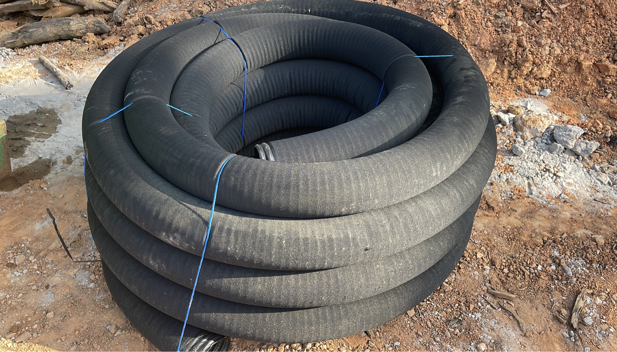

  • Open joints of drain tiles (pipes) must be protected with strips of building paper
  • Perforated drains pipes must either be surrounded with an approved filter membrane or the filter membrane must cover the washed gravel or crushed rock covering the drain
These protective measures prevent soil infiltration that could otherwise clog the drainage system, rendering it ineffective over time. Think of filter membranes as the bouncers at an exclusive "water-only" club—they keep the riffraff (soil particles) out while letting the VIPs (water molecules) pass through freely.
Drainage tiles (pipes) are extremely important in areas with moderate to heavy rainfall and in soils with a low percolation rate. Perforated pipe has perforations around the entire pipe. The perforations will be subject to clogging if not protected. Except where otherwise recommended by the drain manufacturer, the code requires an approved filter membrane to surround the perforated drain pipe. Below is an illustration of a foundation drainage system with gravel or stone covered with a filter membrane.
As an alternate solution, the code permits washed gravel or crushed stone covering the perforated pipe to be covered with an approved filter membrane. The filter membrane allows water to pass through the perimeter drain tiles or pipes without allowing, or at least greatly reducing, the possibility of fine soils entering the drainage system.

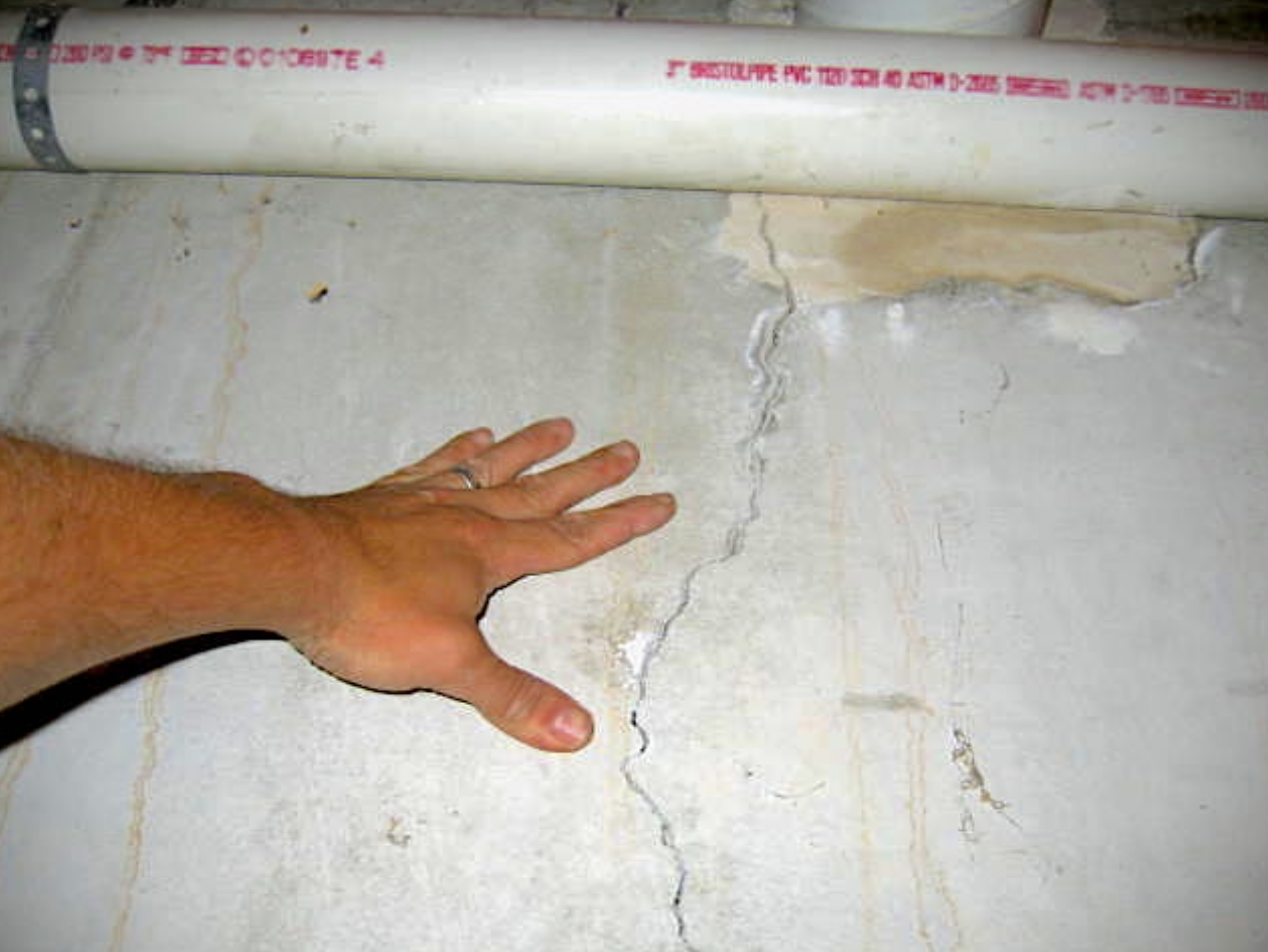

Visual Assessment for Active Water Penetration: In accordance with Section 3.3.III.B, closely examine foundation walls and floors for signs of active water penetration, including:
  • Water seepage or staining
  • Efflorescence (white, powdery mineral deposits)
  • Mold or mildew growth
  • Deteriorating building materials
  • Standing water
  • Rust stains on concrete (possible indication of rebar corrosion)

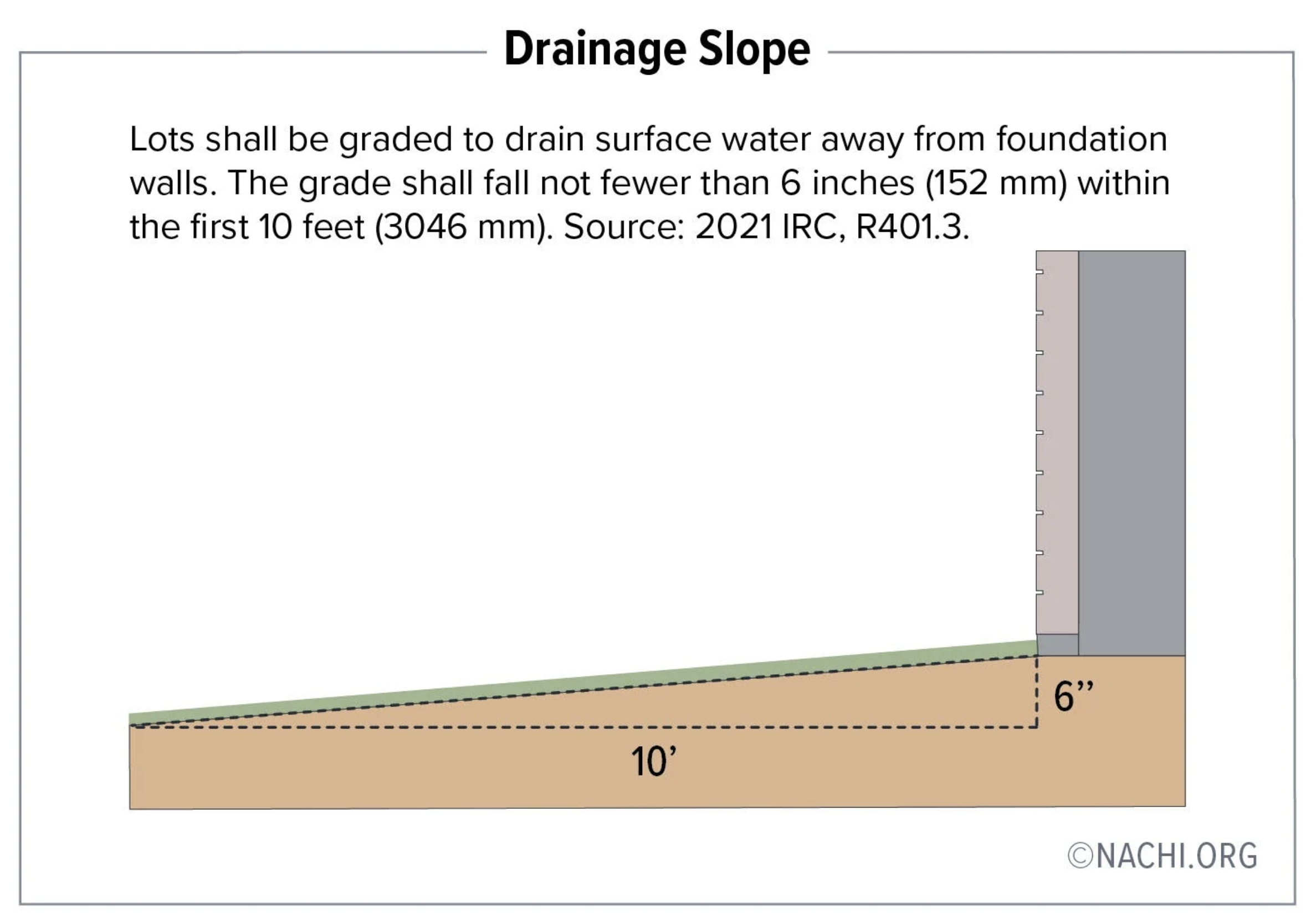

Surface Drainage Evaluation: Assess the grading around the foundation, looking for a proper slope away from the structure (minimum 6 inches within the first 10 feet as recommended in 2024 IRC Section R401.3). Poor surface drainage often compensates for inadequate subsurface drainage systems. Remember: water always follows the path of least resistance, so our job is to make "away from the foundation" that path.

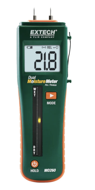

Moisture Testing: Utilize a moisture meter to assess foundation wall moisture content, particularly at the base where the wall meets the footing. This is where we get to play with the cool gadgets.
