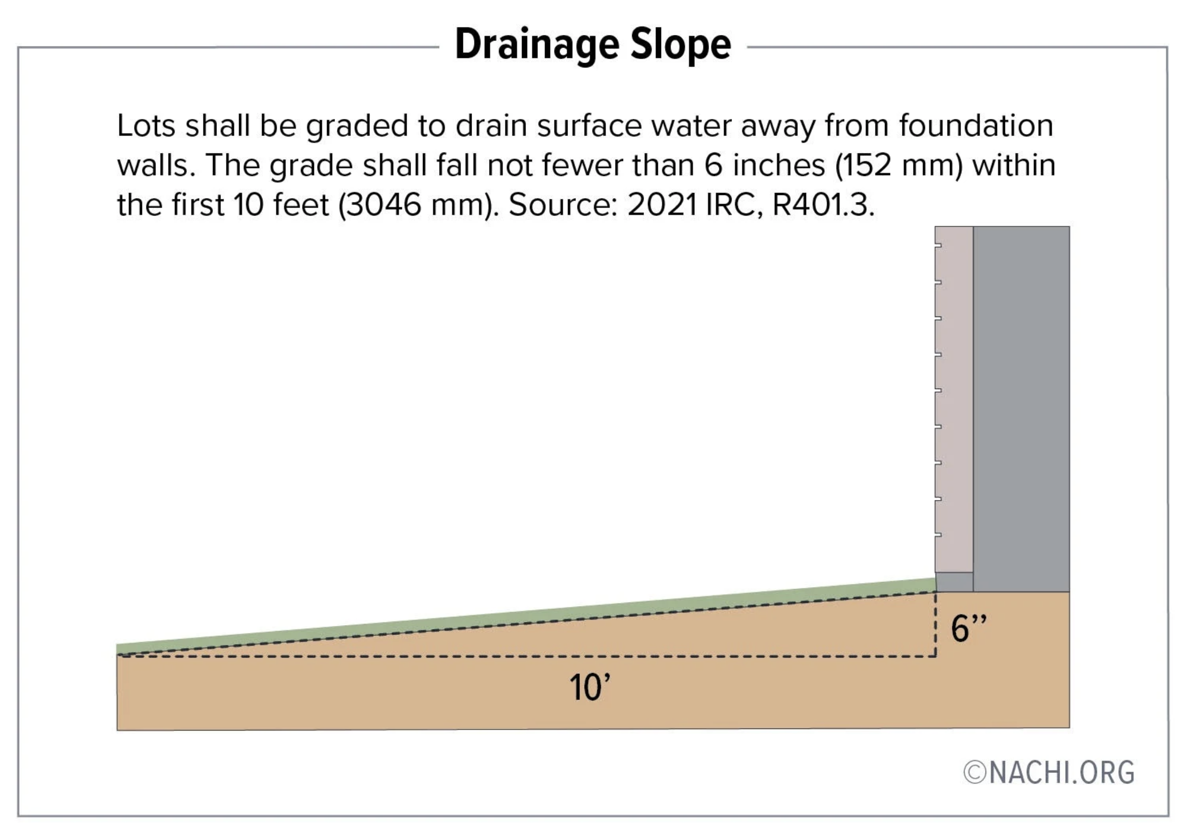

  • proper surface drainage directing water away from the structure,

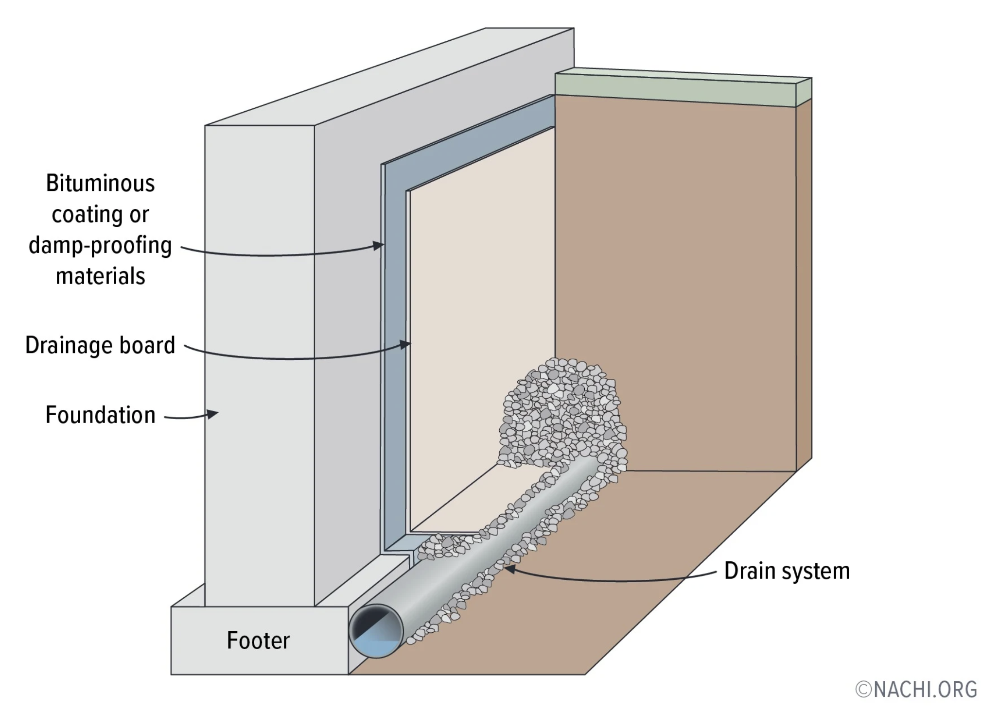

  • foundation dampproofing or waterproofing creating a moisture barrier.
This inspection training article focuses specifically on the third part - the foundation dampproofing and waterproofing as required by the International Residential Code® (IRC®) Section R406 and addressed in the InterNACHI® Home Inspection Standards of Practice. By understanding the differences between these moisture protection strategies and applying building code requirements, home inspectors can provide incredibly valuable information to clients facing one of the most common and costly home maintenance challenges.
Integrated System of Three Parts
Effective foundation water management represents a three-pronged defense system that, when properly executed, keeps below-grade spaces dry, healthy, and functional. This integrated system consists of:
  • Surface Drainage Components: The first line of defense includes properly sloped grading away from the foundation (minimum 6 inches of fall within 10 feet), strategic placement of impermeable soils against the foundation, and careful management of roof runoff through properly extended downspouts.
  • Foundation Dampproofing and Waterproofing: The direct barrier between soil moisture and foundation walls that prevents both vapor migration and liquid water intrusion—the focus of this inspection training article.
  • Subsurface Drainage Systems: The collection and diversion of groundwater through properly installed foundation drains, gravel beds, and sump systems.
While each component serves a distinct purpose, they work together to create a water management strategy. Failure of any one component can compromise the entire system, highlighting the importance of thorough inspection of all three elements.

Dimpled Membrane Systems
One of the most significant innovations in foundation moisture protection is the dimpled membrane.
Products like Delta-MS by Dörken Systems represent a dramatic improvement over traditional dampproofing methods by creating an air gap between the membrane and the foundation wall, which eliminates hydrostatic pressure and directs water down to the footing. These high-density polyethylene (HDPE) sheets feature molded dimples or studs that create a drainage plane.
When installed with the dimples facing the foundation wall, they create an air space that allows water to drain freely down to the perimeter drainage system. The membranes effectively function similar to an above-grade rainscreen system but for below-grade applications.
Some dimpled membranes are approved as stand-alone dampproofing systems, while others are used as part of a more comprehensive moisture protection assembly.

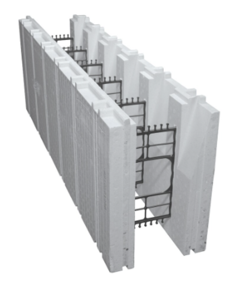

Special Considerations for ICF Walls
For insulated concrete form (ICF) walls with expanded polystyrene, IRC® Section R406.2 provides an important exception: organic-solvent-based products such as hydrocarbons, chlorinated hydrocarbons, ketones, and esters shall not be used, as these chemicals can dissolve the foam insulation. Instead, the code permits:
  • Plastic roofing cements
  • Acrylic coatings
  • Latex coatings
  • Mortars and pargings
If asphalt is used, it must be cold-setting or hot asphalt conforming to Type C of ASTM D449, with hot asphalt applied at temperatures below 200° F (93° C) to avoid damaging the foam.

  • Improper grading toward the foundation
  • Inadequate downspout extensions

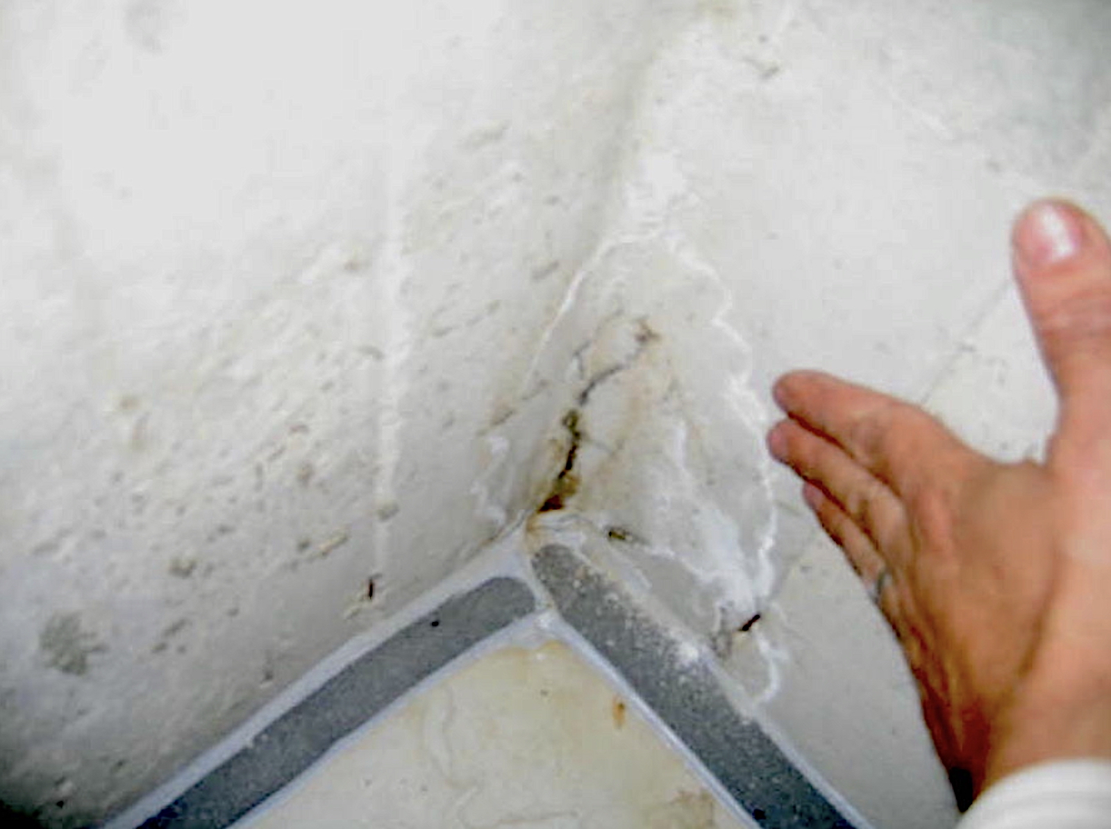

Interior Evidence Assessment: In accordance with Section 3.3.III.B, thoroughly inspect for and document any "observed indications of active water penetration." Even when the exterior dampproofing/waterproofing isn't visible, evaluate interior indicators:
  • Water staining or efflorescence on basement walls
  • Mold or mildew growth
  • Rust on metal components near foundation walls
  • Deteriorating floor or wall finishes
  • Musty odors
  • Standing water or evidence of previous water intrusion
These interior symptoms often tell the true story of the invisible exterior dampproofing's performance and must be documented as required by the InterNACHI Standards of Practice.

  • ICF-Incompatible Materials: Using solvent-based products on ICF walls with expanded polystyrene, potentially damaging the insulation and compromising structural integrity. This is like washing your wool sweater with bleach—the damage might not be immediately apparent but is certainly destructive.
