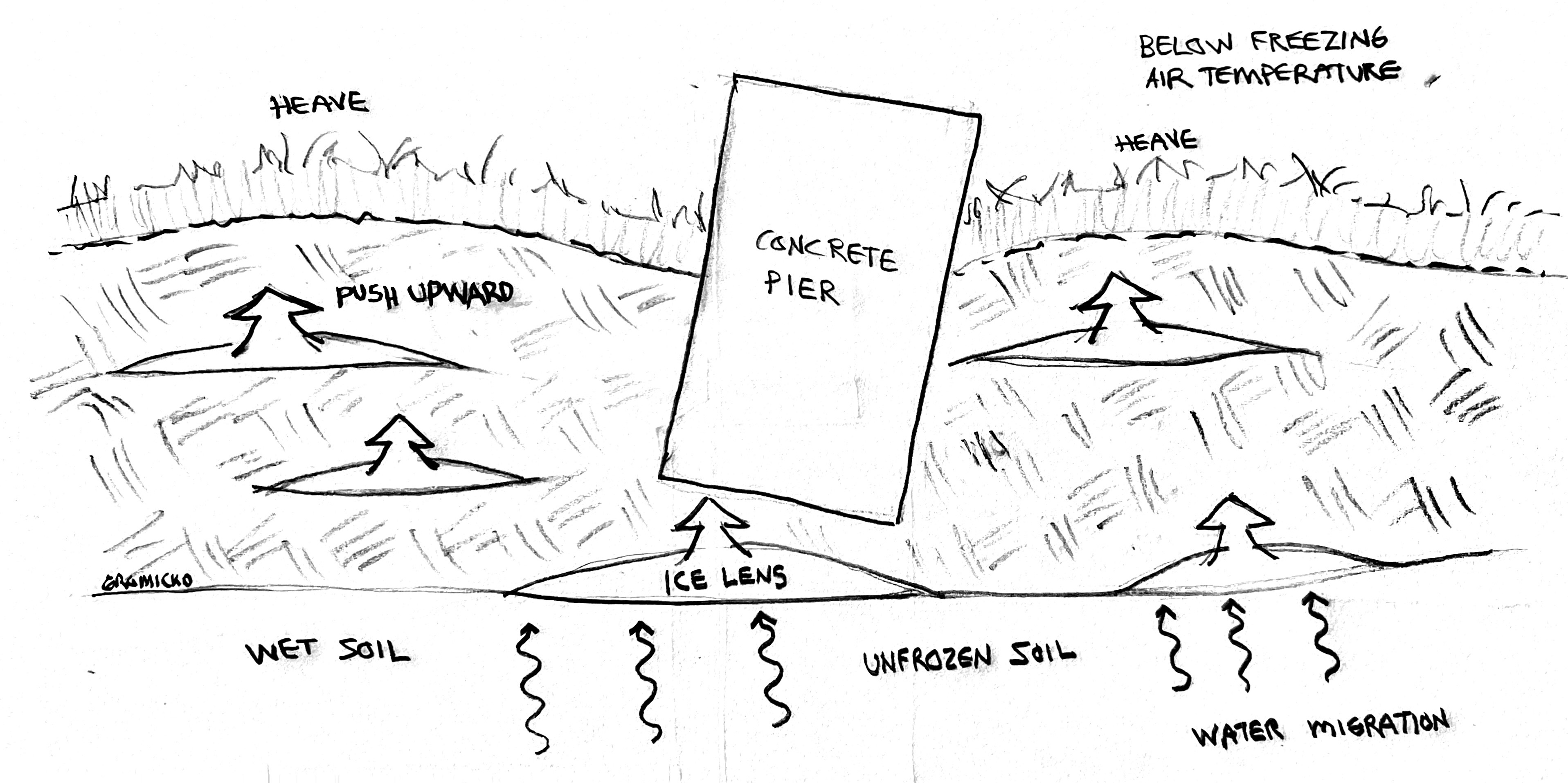

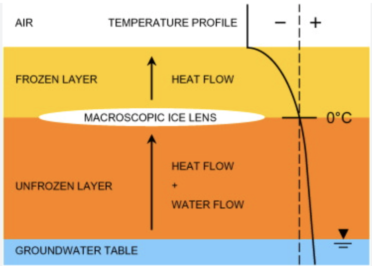

Frost Heave 101: What the Code Is Trying to Prevent
Before we dig into the insulation details, it’s important to understand what we’re fighting against — and what the IRC is trying to accomplish with all this frost protection.
Frost heave happens when three things come together:
  • The soil is susceptible to frost (usually fine-grained stuff like silt or loam).
  • The soil is wet.
  • The temperature drops below freezing.
When these conditions exist, water in the soil starts migrating toward the freezing zone and forms layers of ice called ice lenses.
These grow by drawing water upward and expanding — which, you guessed it, pushes the soil and everything above it up. When the ice eventually melts, the soil slumps back down, usually unevenly. Over time, this can cause structural movement, cracking, and settlement to buildings and other structures like decks and paved sidewalks.
To prevent that, traditional foundations just go deeper than the frost line. It’s a great brute-force solution. But IRC Section R403.1.4.1 clearly says you’ve got options — four, in fact:

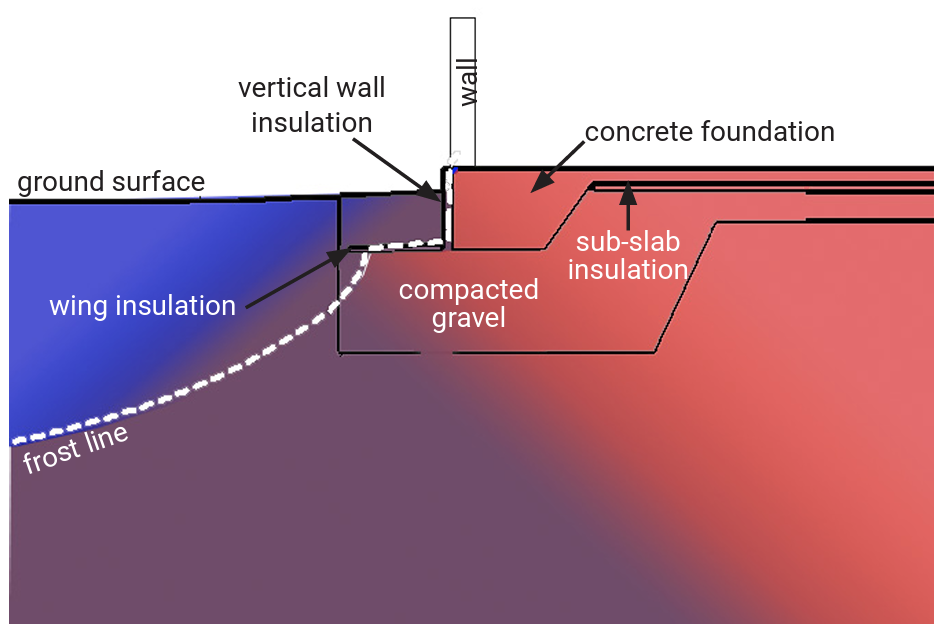

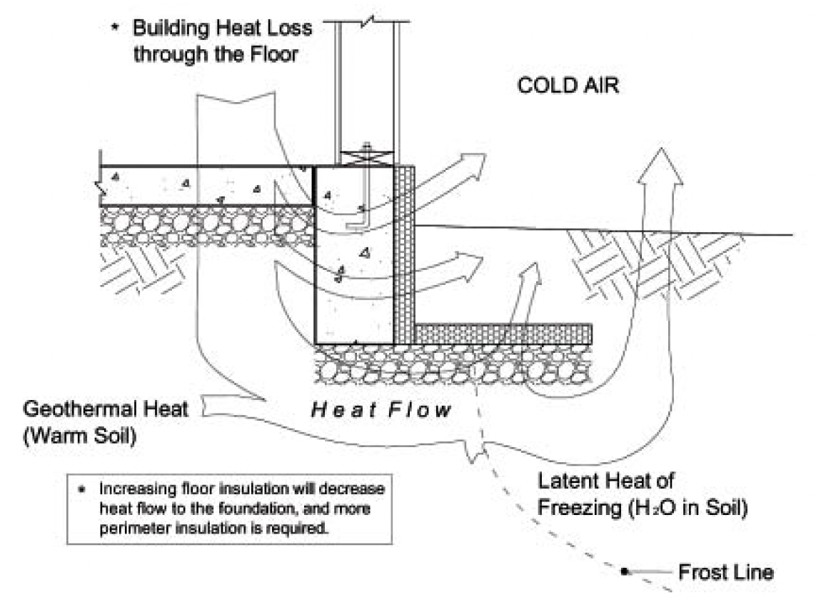

At their core, FPSFs manipulate the temperature of the soil. Instead of avoiding the freeze zone, they use insulation to keep the freeze zone from reaching the foundation in the first place.
But this only works if the building is heated — and that’s not optional. According to IRC R403.3, the building must maintain a monthly mean temperature of at least 64°F (18°C) for the system to work. That’s the temperature baseline the code relies on, because building heat loss is part of the design. In other words, some heat must be allowed to leak into the ground.
Yes, the FPSF method actually wants some heat loss — but only in the right places, at the right levels. Over-insulate the slab and the system fails. Under-insulate it? Same problem. There’s a sweet spot, and the code spells it out in detail.
A note for the field: If you’re inspecting a new home with an FPSF and they’ve put R-20 insulation under the slab and sealed it like a Yeti cooler, you’ve got a problem. FPSFs need just enough heat to warm the soil — not to keep it hermetically sealed.

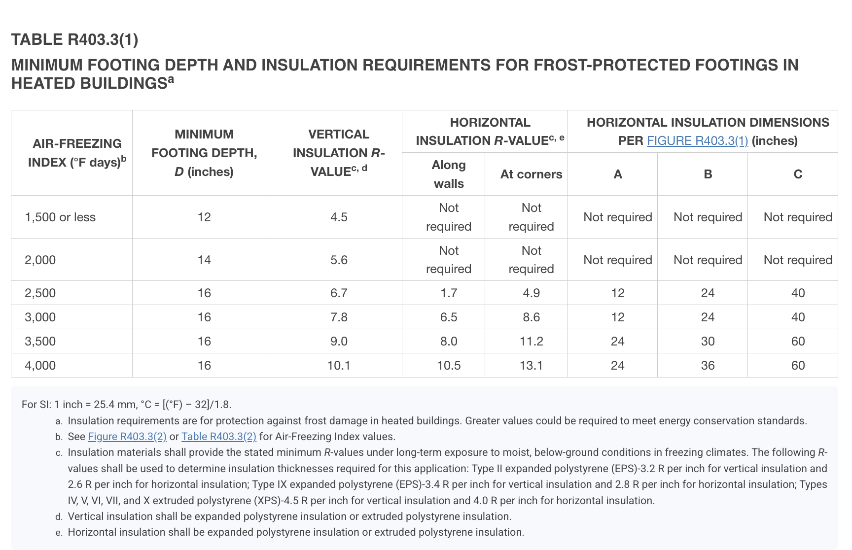

The code ties everything to one key climate metric: the Air-Freezing Index (AFI). This is a measure of how cold it gets and for how long — and it determines how much insulation you need.
IRC Table R403.3(1) gives the breakdown:
  • Minimum footing depth.
  • Required R-values for vertical and horizontal insulation.
  • How far the horizontal insulation must extend (especially at corners).
For example, in a cold zone with an AFI of 3,000°F-days:
  • Footing depth: 16 inches.
  • Vertical insulation: R-7.8.
  • Horizontal insulation: R-6.5 at walls, R-8.6 at corners.
  • Extension distances: 12 inches at walls, 40 inches at corners.
You can find your local AFI in IRC Table R403.3(2) or NOAA climate data.

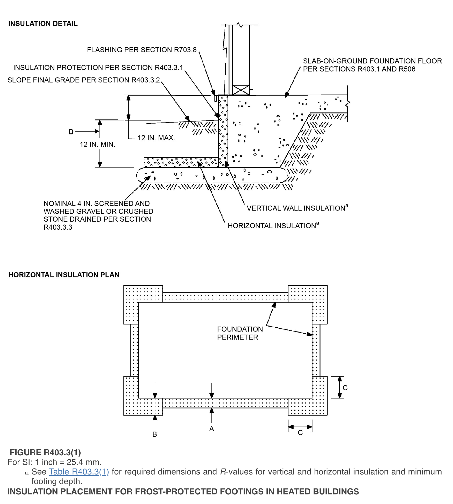

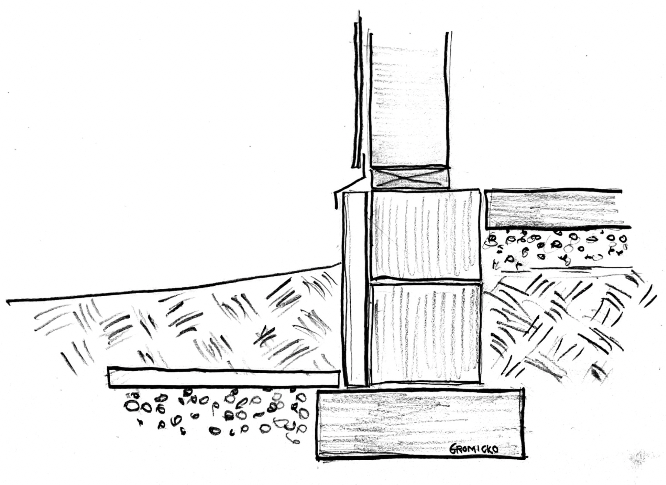

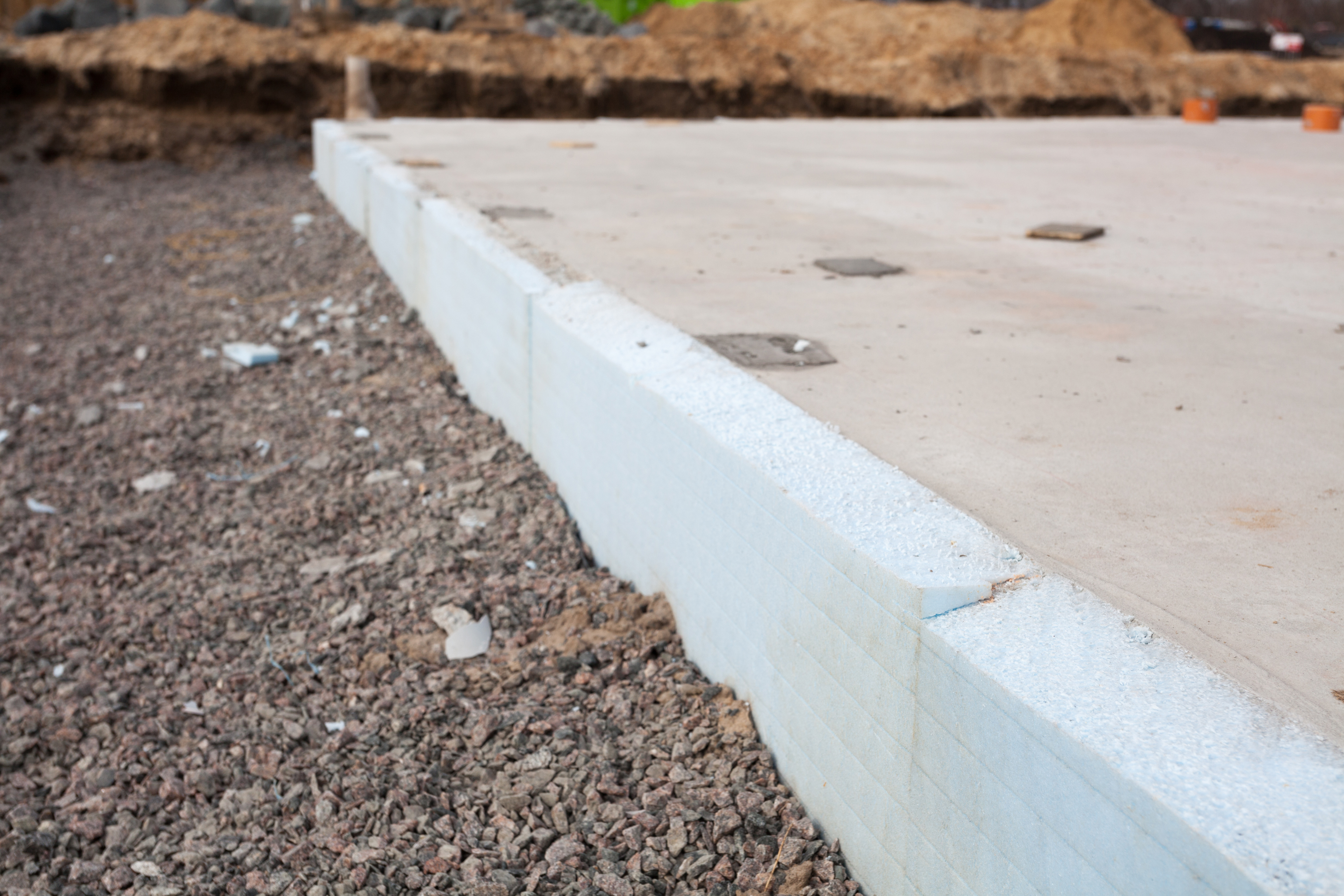

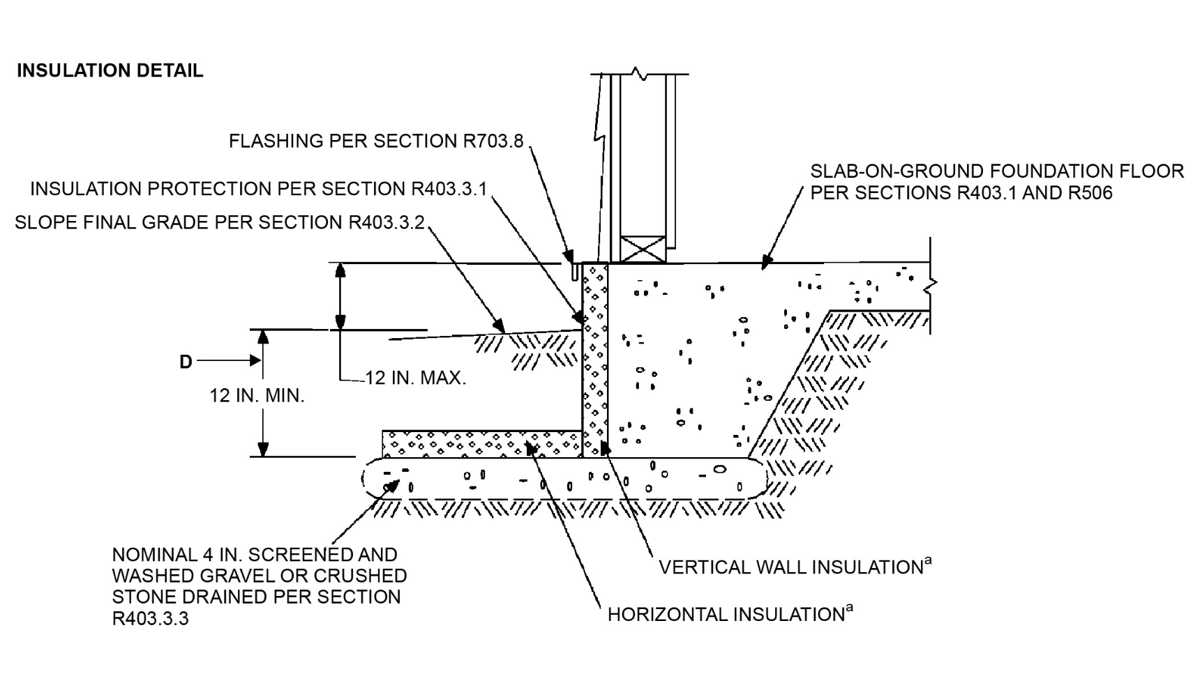

Vertical Insulation (The Wall Blanket)
According to IRC R403.3 and ASCE 32 design logic, vertical insulation is required wherever FPSFs are used.
Here’s how it works:
  • It runs from the top of the foundation wall to the bottom of the footing, or until it meets horizontal insulation.
  • Its job is to limit lateral heat loss — keeping warmth in the soil beneath the structure.
  • The R-value requirement is climate-dependent, as listed in IRC Table R403.3(1).
  • The insulation must be continuous, with no big gaps or breaks — because heat, like water, loves to find an escape route.
  • Vertical and horizontal insulation must be expanded polystyrene insulation or extruded polystyrene insulation.
Inspector Tip: The vertical insulation should be snug, sealed, and protected. If you see exposed pink or blue foam sticking out of the ground with UV damage or chunks missing where the weed whacker's been a little too enthusiastic — that’s a problem.
IRC requires that the above-grade portion of the insulation be protected from physical damage and sunlight. Think cement board, parging, or compatible coatings — anything that keeps the foam from degrading.
Horizontal Insulation (The Thermal Umbrella)
Now for the piece that makes FPSFs truly different: horizontal insulation. This foam lies flat, extending outward from the base of the foundation wall into the soil.
According to the code:
  • It should extend 12 to 60 inches, depending on the AFI and whether it’s at a wall or a corner.
  • It has to be buried at least 12 inches deep unless protected by concrete, pavers, or another approved cover.
  • Corners require more: higher R-values and longer extensions. (Why? Because corners lose heat faster — picture the way your fingers get cold before your palms in winter.)
A quick analogy: Think of the foundation as a campfire and the horizontal insulation as the stones you lay around it to keep the heat in. No stones = lost heat = frozen ground = heaving structure.
What if the insulation is too shallow, unprotected, or just... missing?
Then your FPSF isn’t really frost-protected — it’s just a shallow foundation waiting for a problem.

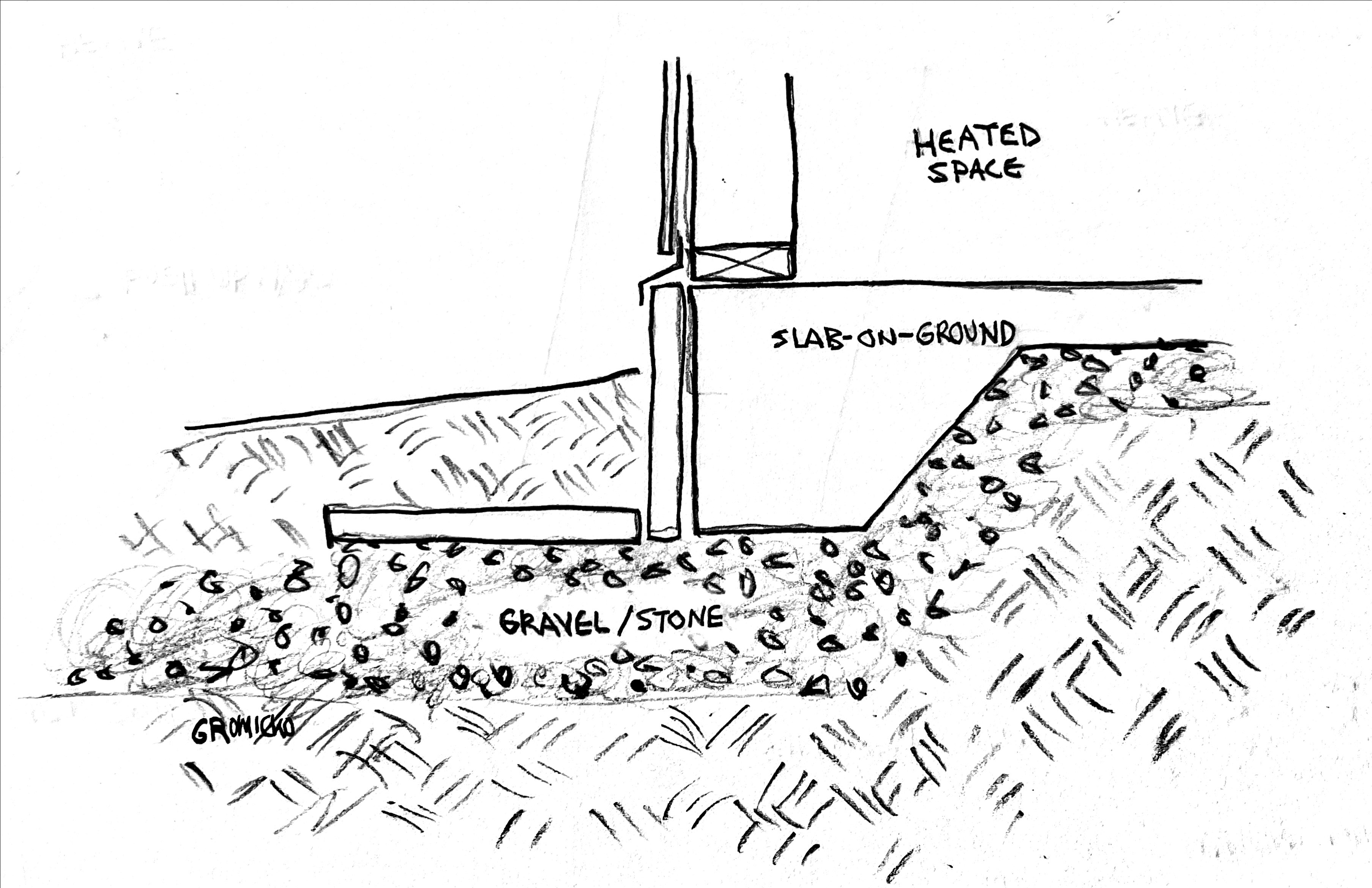

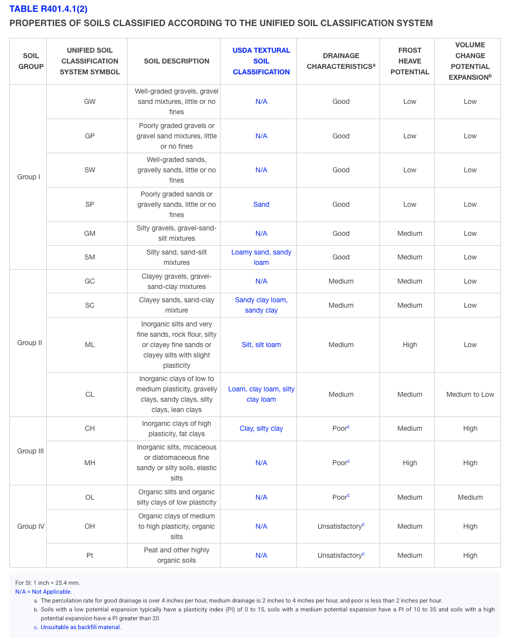

Gravel Base and Soil Considerations
Where the soil beneath the horizontal insulation and footing does not have very good drainage characteristics (Group I, sand or gravel), IRC R403.3.3 requires a 4-inch layer of washed gravel or crushed stone in accordance with Figure R403.3(1). Why? Because gravel:
  • Drains well
  • Doesn’t hold water
  • Reduces frost heave risk from capillary action
But here’s where it gets tricky. If the soil below the gravel isn’t Group I, the gravel has to drain to daylight or into a storm system. This is to keep water from saturating the soil beneath the foam and footing.
Code Reference: Table R401.4.1(2) defines Group I soils. If you're standing in silty clay, don't assume water will politely leave — it won’t.

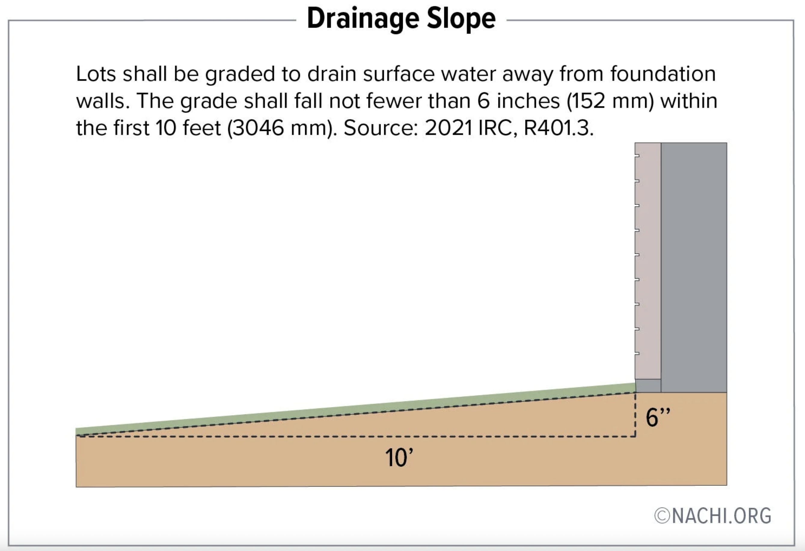

Inspectors should confirm:
  • Presence of proper base material
  • Adequate drainage pathways
  • Final grade slopes away from the foundation (IRC R401.3 requires 6" drop over 10 feet) as illustrated below.

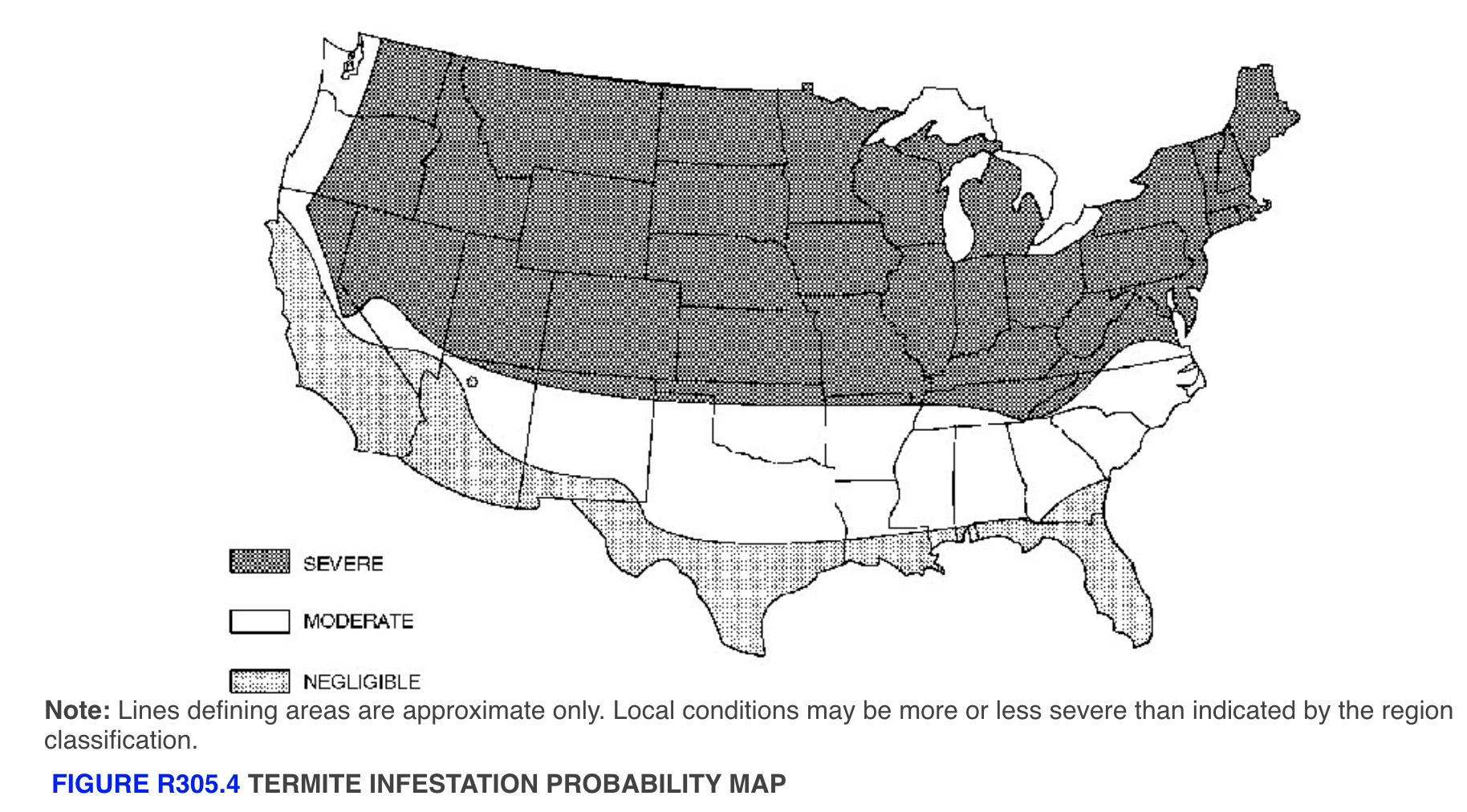

One Last Thing: Termites and Foam Don’t Mix (Section R305.4)
In regions where the probability of termite infestation is “very heavy” (as determined by IRC Figure R305.4), foam plastics (including extruded and expanded polystyrene and polyisocyanurate) are not permitted on:
  • The exterior face of foundation walls (both interior and exterior) located below grade.
  • Under foundation walls or slab foundations that sit below grade.
This code provision exists because foam insulation can obscure termite entry paths and make termite infestation more difficult to detect. By restricting below-grade installation in high-termite regions, the IRC aims to prevent concealed termites from bypassing typical inspection barriers.
Clearance Above Grade
When foam plastic is installed above grade, it must be separated from the exposed earth by no less than 6 inches (152 mm). This clearance prevents direct soil contact, which reduces the chances of termites bypassing visual inspections or protective barriers.

Verify the following:
  • Vertical insulation runs full height from top of foundation wall to the bottom of the slab or footing
  • Horizontal insulation extends the correct distance (Dimension A), with increased width and R-value at corners
  • R-values match the table — some contractors still think any foam board will do
Watch for substitutions. Not all rigid foam has the same compressive strength or long-term R-value. Insulation must comply with ASTM C578, and the builder should derate values for long-term soil contact if not using XPS.
Are Corners Properly Insulated?
Corners get cold faster — it’s just physics. The code requires longer and thicker horizontal insulation at corners, because these areas are the most vulnerable to frost penetration.
Red flags:
  • Same insulation used everywhere (no increased corner coverage)
  • Gaps or missing foam at foundation corners
  • Foam joints that aren’t taped or sealed
Check for Drainage and Soil Prep (R403.3.2 and R401.3)
FPSFs don’t just manage temperature — they manage moisture. Without proper drainage, the foundation could still experience heaving.
The IRC requires:
  • 4" minimum washed gravel or crushed stone beneath the footing
  • Drainage to daylight or approved system for soils other than Group I (see IRC Table Table R401.4.1(2)
  • Grade slope of 6” in 10 feet away from the foundation
On site:
  • Confirm that the right gravel layer exists
  • Look for signs of pooling, blocked drains, or improper grading

  • Termite protection for below-grade insulation in “very heavy” termite zones (see R318.4)
In the field:
  • Look for exposed, dented, chewed-up, or weathered foam
  • Ask about the termite control method used — if the builder looks at you like you just made that up, dig deeper

Frost Heave Caused by Ice Lens
Here’s a little more info about ice lens and frost heave.
Definition of Ice Lenses
An ice lens is a layer or band of pure ice that forms within freezing, moist soil. These lenses can grow and stack in stratified layers, causing the ground above to heave or lift.
Conditions That Promote Ice Lens Formation
Ice lenses form when the following three conditions are met:
  • Freezing Temperatures at the Surface. There must be a consistent downward-moving freezing front, usually during cold seasons when the air temperature is below 32°F (0°C). The soil doesn’t freeze all at once; rather, a freeze line slowly moves downward through the soil.
  • Availability of Water. Unfrozen groundwater or soil moisture must be present beneath the freezing zone. This moisture supplies the freezing front with liquid water, which then migrates upward through capillary action and freezes.
  • Frost-Susceptible Soil. Soils that are fine-grained, such as silts and clays, are most susceptible. These soils have small pore spaces that support capillary water movement, enabling water to rise toward the freezing front.
Mechanism of Ice Lens Growth
The formation of ice lenses is based on thermodynamics and capillarity:
  • As the upper layer of soil begins to freeze, it extracts latent heat from the surrounding unfrozen water.
  • This initiates a temperature gradient, drawing liquid water from the deeper, unfrozen layers upward.
  • The migrating water freezes when it reaches the colder zone, forming a distinct lens of ice.
  • As long as the freezing continues and unfrozen water remains available, the ice lens grows thicker.
This process can repeat itself, forming multiple stacked lenses and pushing the soil surface upward. This is the essence of frost heave.
Why Ice Lenses Matter in Construction and Inspection
For home inspectors and builders, understanding ice lenses is critical because:
  • Frost heave can damage foundations, especially shallow footings, walkways, driveways, and slabs not properly protected against freezing.
  • Moisture control and soil selection are essential during site preparation.
  • Proper use of non-frost-susceptible fill, insulation, or drainage systems can help prevent the conditions that lead to ice lens formation.
Ice lenses are based upon the principle that when certain soils are exposed to freezing temperatures and have access to liquid water, capillary action draws water toward the freezing front, where it freezes and accumulates into layered ice bands. These ice lenses can expand and lift the soil, leading to structural damage known as frost heave. Understanding the mechanics behind ice lens formation is crucial for proper building design, especially in cold climates.
Ice lens formation—and the associated problem of frost heave—is a serious concern for building officials, engineers, and inspectors, primarily in cold climates, where soils freeze seasonally and remain frozen for extended periods. The phenomenon is not uniform globally; it’s region-specific, depending on climate, soil type, and groundwater availability.
