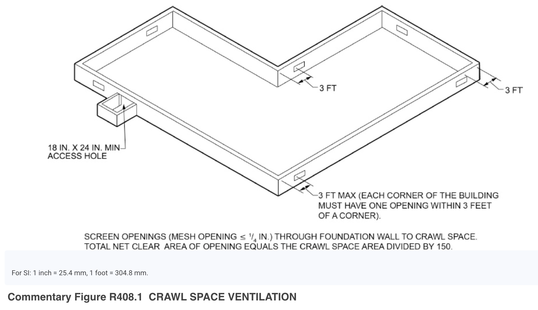

R408.2: Openings for Under-Floor Ventilation
Section R408.2 provides comprehensive requirements for ventilation openings in crawl spaces. As a home inspector, understanding these specifications is essential for proper evaluation.
Minimum Ventilation Area Requirements
The code mandates that the minimum net area of ventilation openings should be at least 1 square foot for each 150 square feet of under-floor area. This ratio ensures adequate air exchange to mitigate moisture accumulation. When calculating required ventilation:
  • Determine the total crawl space area in square feet
  • Divide this area by 150 to obtain the required net ventilation area in square feet
  • Convert to square inches (multiply by 144) for practical application when measuring vent openings
For example:
  • A 1,300 square foot crawl space requires 1,300 ÷ 150 = 8.7 square feet of net ventilation area.
  • Converting to square inches: 8.7 × 144 = 1,252 square inches.
  • Using standard 8" × 16" foundation vents (128 square inches each): 1,252 ÷ 128 = 9.78 vents.
  • Therefore, ten 8" × 16" vents would satisfy the requirement.
Location and Distribution of Ventilation Openings
The 2024 IRC requires ventilation openings to be strategically placed for effective cross-ventilation:
  • One ventilation opening must be located within 3 feet of each external corner of the under-floor space
  • Remaining openings should be distributed to provide cross-ventilation throughout the entire crawl space
  • This corner-proximity requirement provides enough air movement and prevents stagnant air pockets where moisture can accumulate.

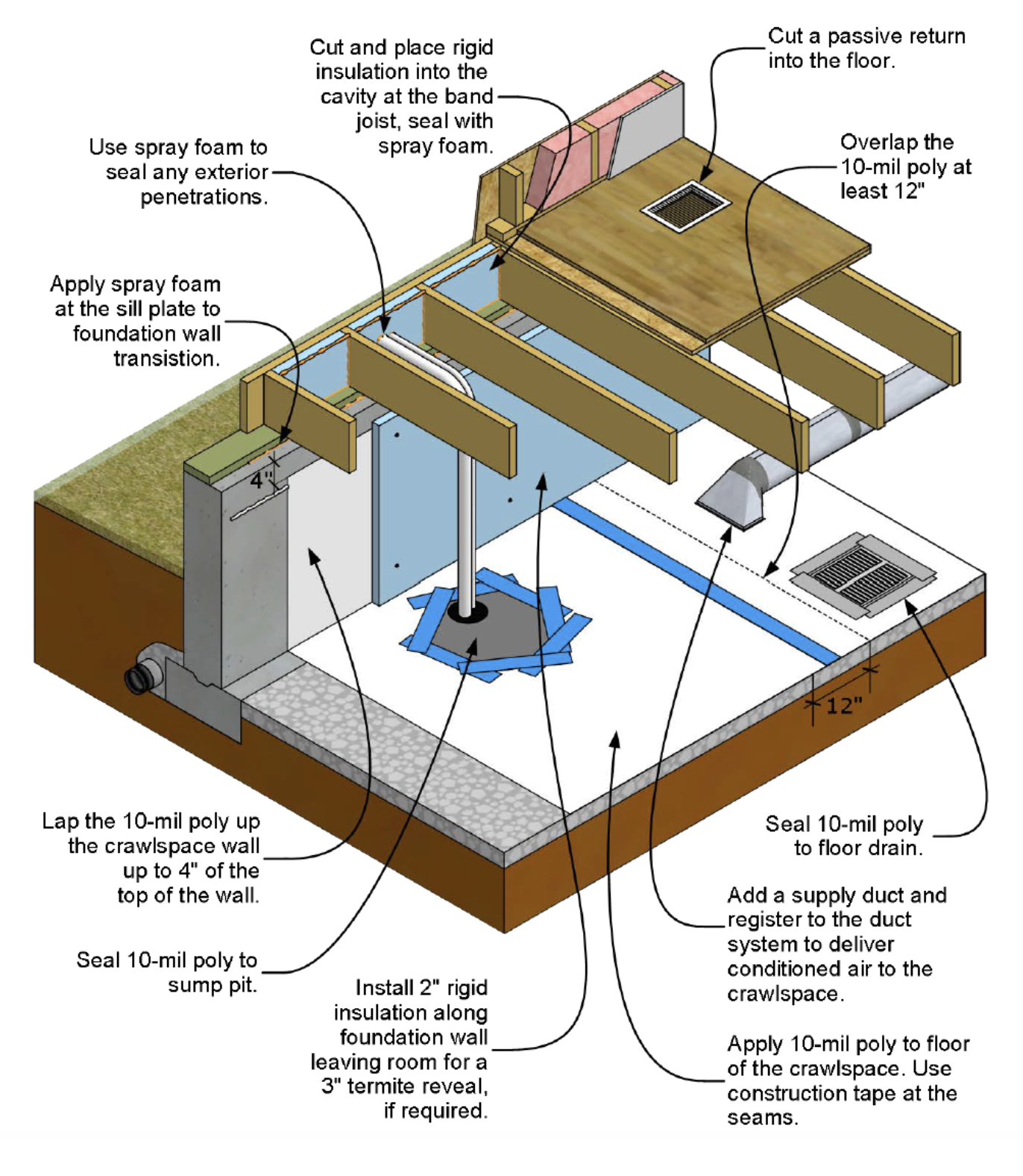

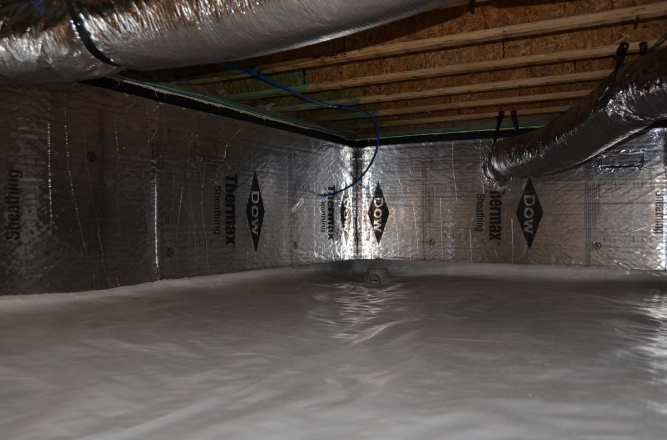

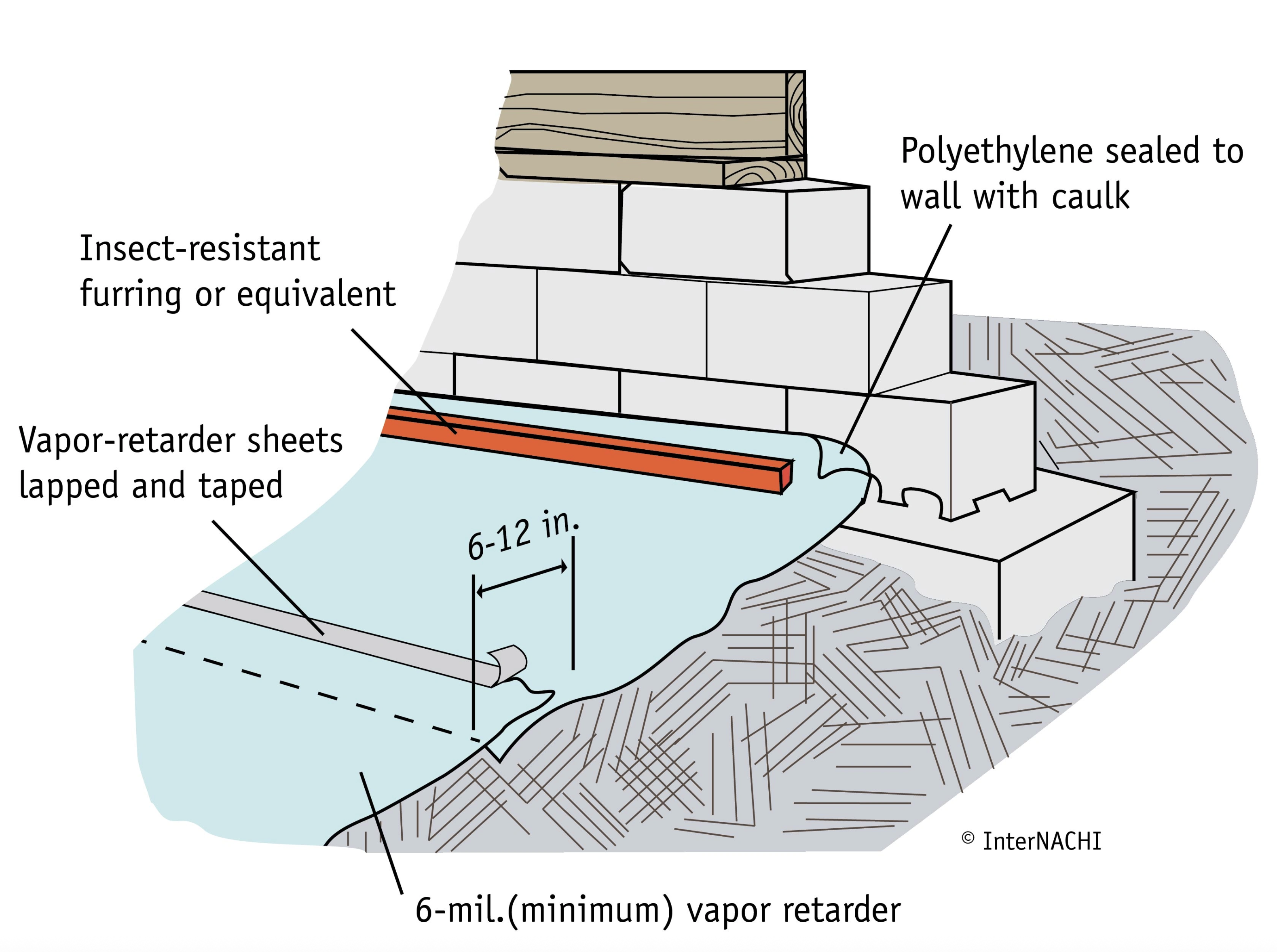

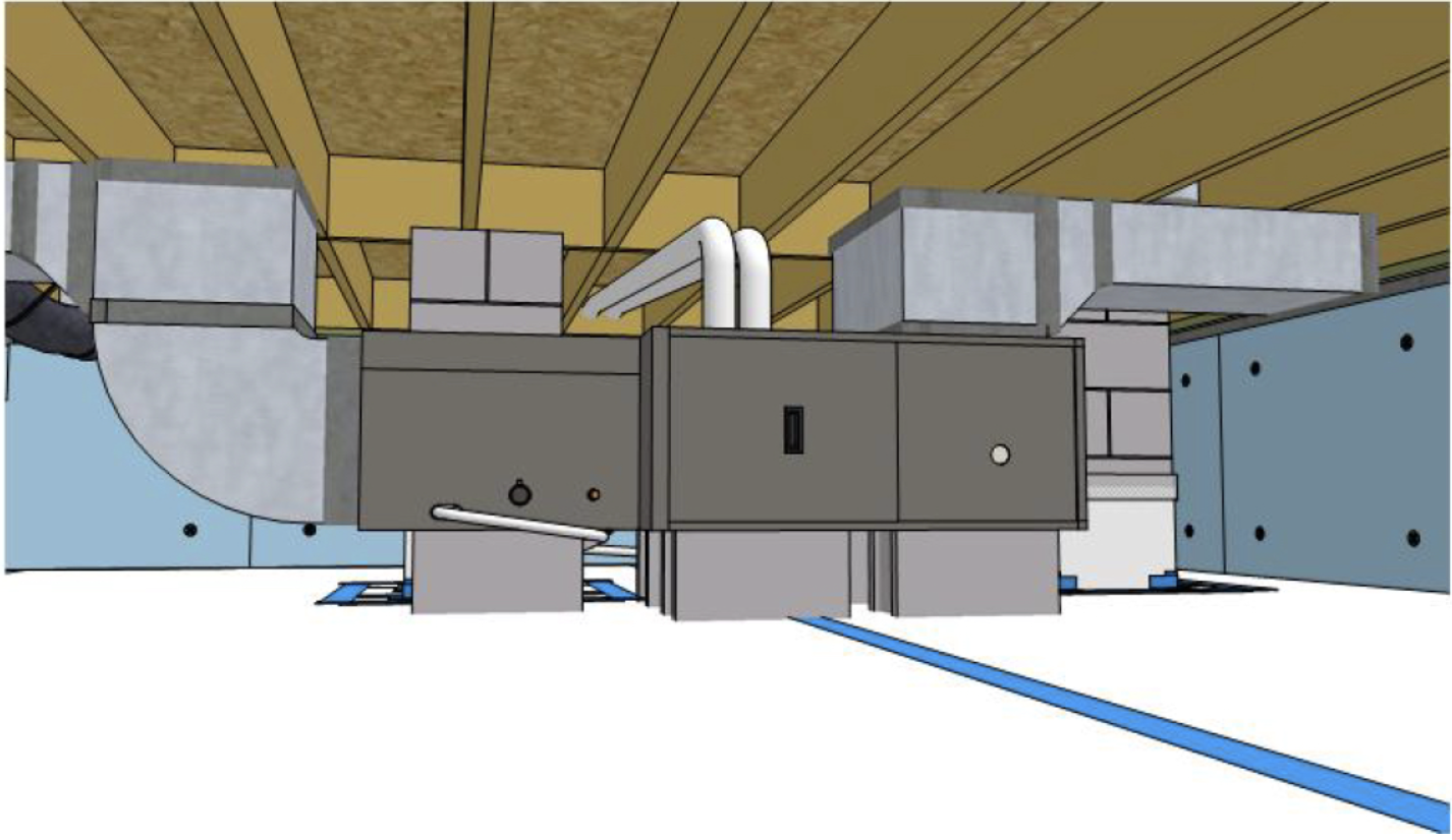

R408.3: Unvented Crawl Space
Section R408.3 of the 2024 IRC provides an alternative approach to crawl space moisture control with unvented (sometimes called "conditioned" or "sealed") crawl spaces. This approach has gained significant acceptance in the building science community as research has demonstrated its effectiveness in controlling moisture and improving energy efficiency, particularly in humid climates.

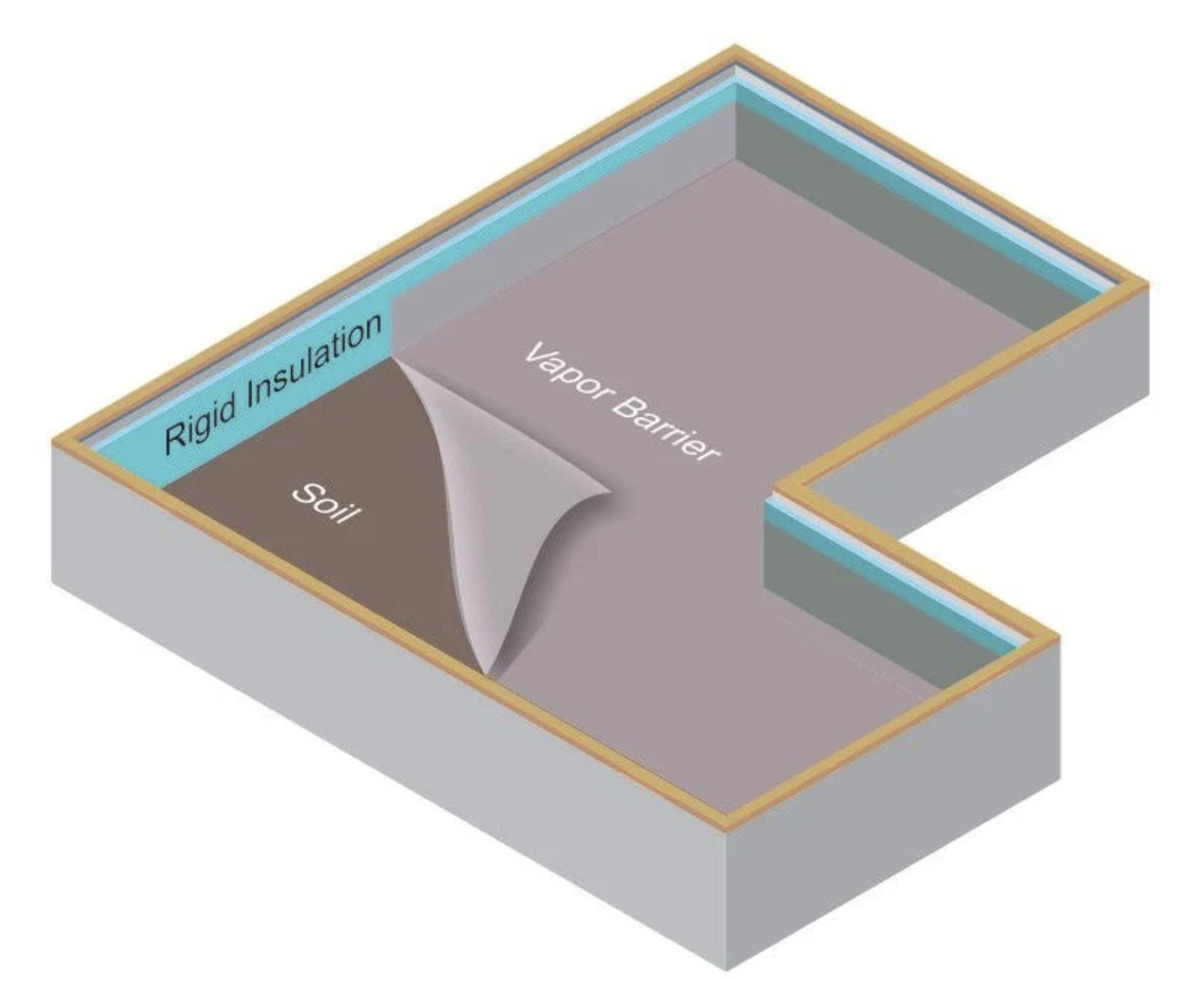

Vapor Retarder Requirements
For unvented crawl spaces, the code mandates specific requirements for vapor retarders that are more stringent than those for vented spaces:
  • A continuous Class I vapor retarder must cover all exposed earth
  • Joints must overlap by a minimum of 6 inches (152 mm)
  • All joints must be sealed or taped to create a continuous moisture barrier
  • The edges of the vapor retarder must extend at least 6 inches (152 mm) up the stem wall
  • The vapor retarder must be properly attached and sealed to the stem wall or insulation
These requirements create a complete separation between the soil moisture and the crawl space environment, significantly reducing the primary source of moisture in these spaces.

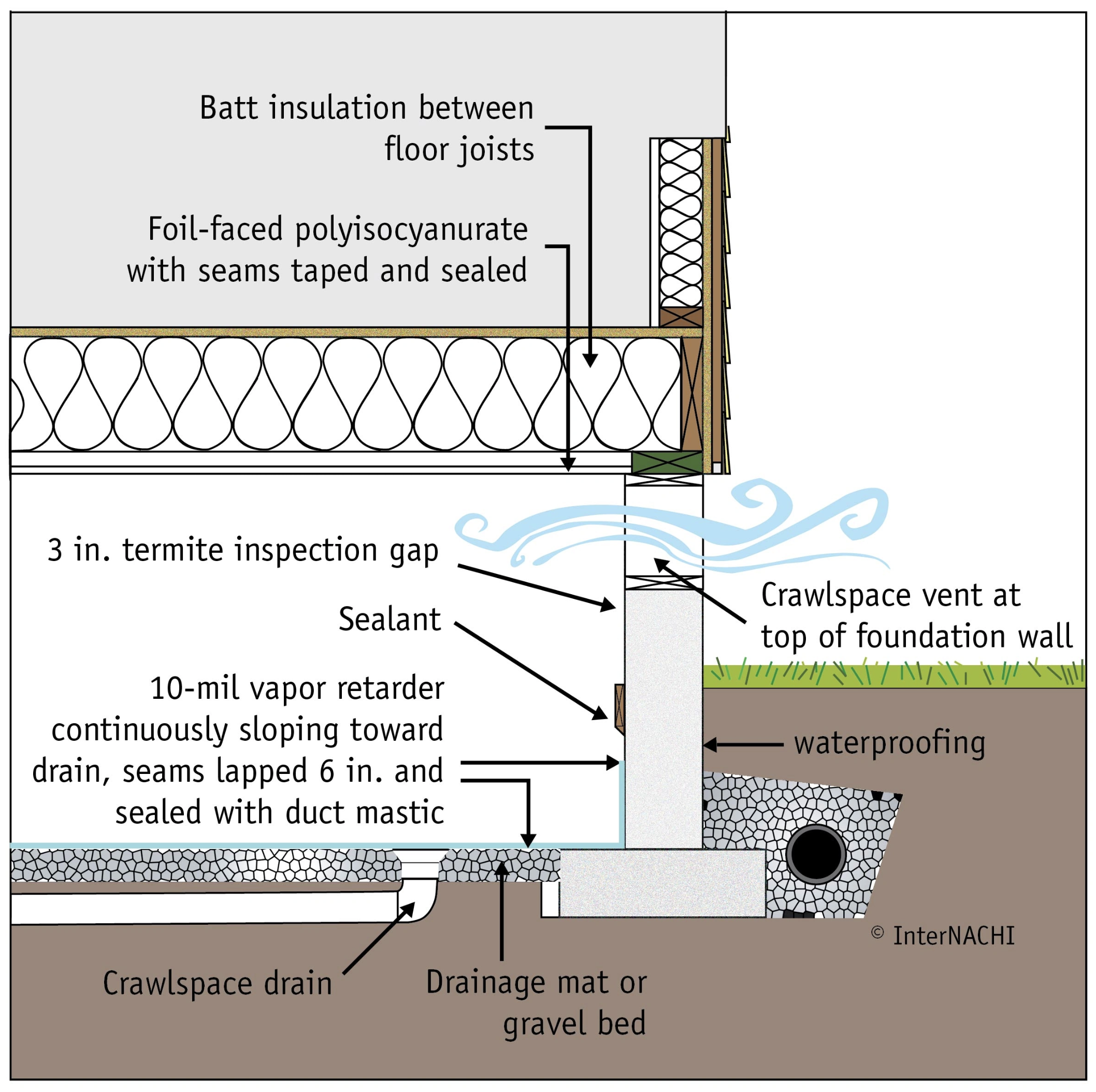

Conditioning Options
In addition to the vapor retarder, the code requires one of four conditioning methods for the crawl space:
  1. Mechanical Exhaust Ventilation. This option requires:
    • Continuous operation of mechanical exhaust ventilation
    • Ventilation rate of 1 cubic foot per minute (CFM) for each 50 square feet of crawl space area
    • An air pathway to the common area (such as a duct or transfer grille)
    • Perimeter walls insulated according to Section N1102.2.10.1.
    • For example, a 1,500 square foot crawl space would require a continuously operating exhaust fan rated at 1,500 ÷ 50 = 30 CFM.
  2. Conditioned Air Supply. This alternative requires:
    • Supply of conditioned air to the crawl space
    • Supply rate of 1 CFM for each 50 square feet of under-floor area
    • A return air pathway to the common area
    • This approach integrates the crawl space into the home's HVAC system, treating it as semi-conditioned space.
  3. Plenum Use (Existing Structures Only). For existing structures only, the crawl space may serve as a plenum if it complies with Section M1601.5. The code commentary specifically notes that under-floor plenums are prohibited in new construction.
  4. Dehumidification. The final option allows for dehumidification sized according to manufacturer's specifications. This approach directly addresses moisture accumulation through mechanical removal of water vapor from the air.
Insulation Requirements
For options 1 and 2, perimeter wall insulation should have:
  • Insulation extending from the top of the footings to the floor above
  • Minimum R-values based on climate zone
  • Proper protection of insulation exposed to the interior

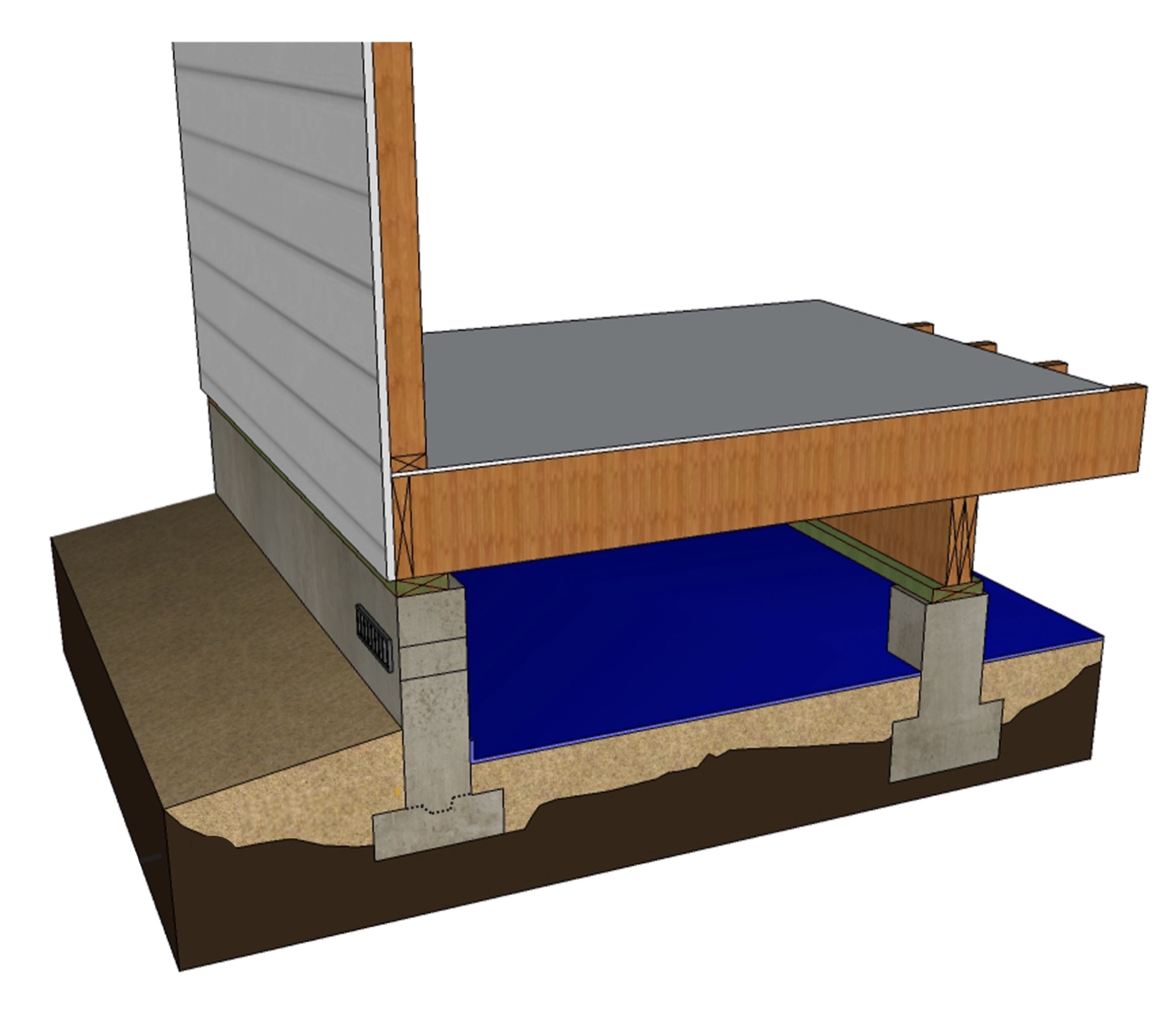

Benefits of Unvented Crawl Spaces
Research by the U.S. Department of Energy's Building America program has demonstrated several advantages of properly designed unvented crawl spaces:
  • Reduced moisture problems and associated mold and decay issues
  • Improved energy efficiency by reducing heat loss/gain through the floor
  • Better indoor air quality in the living space above
  • Fewer issues with pest intrusion
  • Protection of HVAC equipment and ductwork that may be located in the crawl space
Inspection Considerations for Unvented Crawl Spaces
When inspecting unvented crawl spaces, home inspectors should pay particular attention to the following elements:
  • Vapor Retarder Assessment
  • Verify the presence of a continuous Class I vapor retarder covering all exposed earth
  • Confirm that seams overlap by at least 6 inches
  • Check that all seams are properly sealed or taped
  • Verify that the vapor retarder extends at least 6 inches up the stem wall
  • Confirm proper attachment and sealing to the stem wall or insulation
  • Note any penetrations, tears, or damage to the vapor retarder
  • Assess for any signs of moisture accumulation on top of the vapor retarder

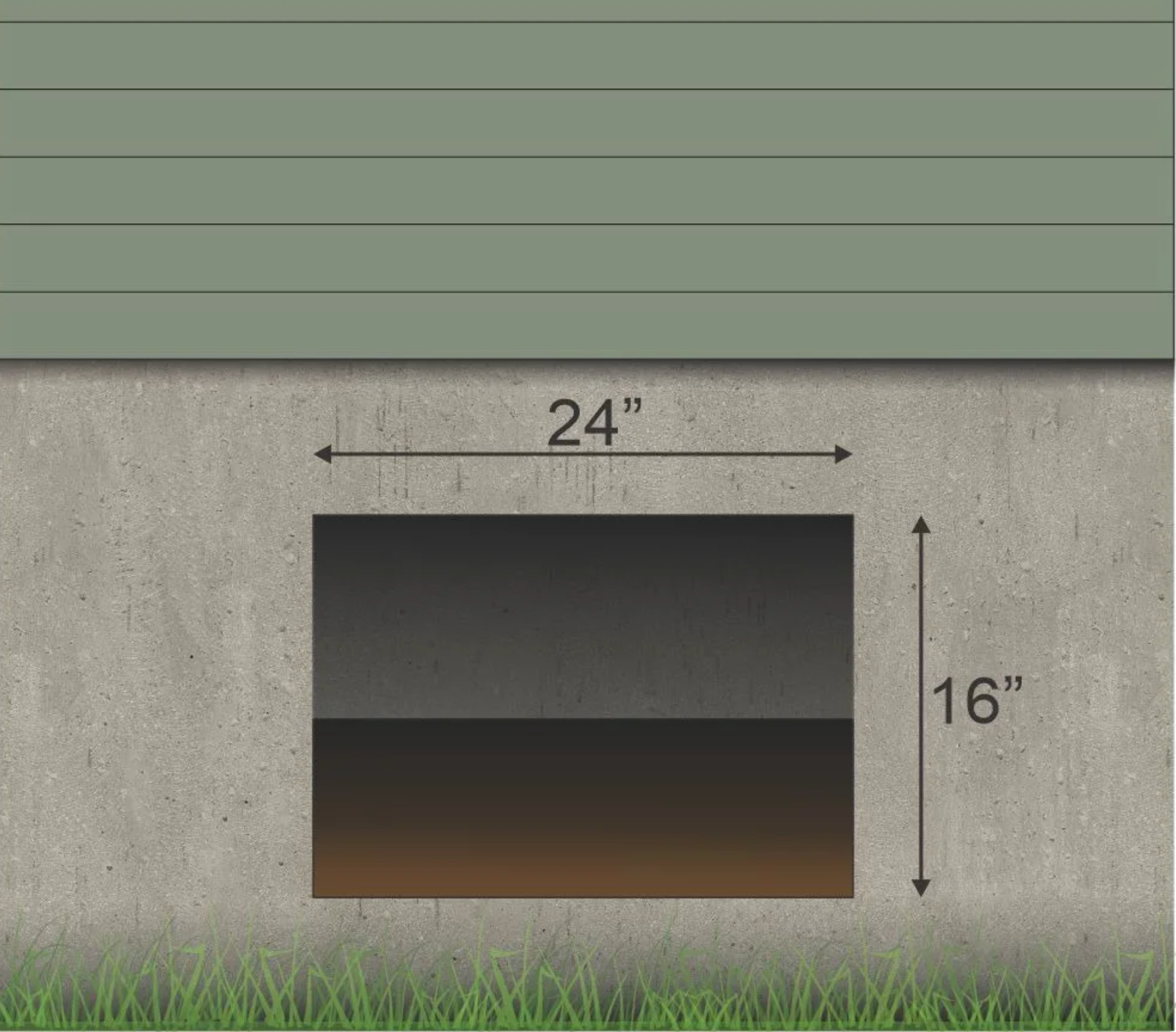

Perimeter Wall Access Openings: 24" x 16"
Minimum size: 24 inches by 16 inches (407 mm by 610 mm).
These dimensions align with standard concrete masonry unit (CMU) coursing to facilitate installation in block foundations. These openings are commonly installed at the building perimeter.

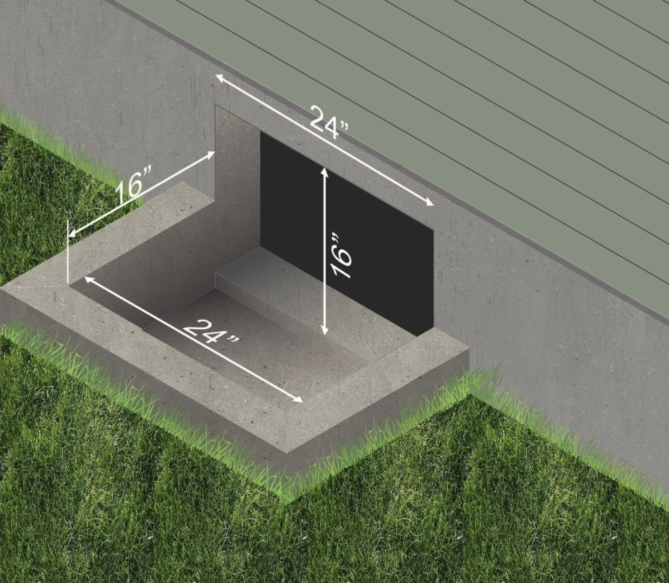

Below-Grade Access Requirements
For perimeter wall access openings that are partially or fully below grade, the code includes additional requirements:
  • An areaway not less than 16 inches by 24 inches (407 mm by 610 mm) must be provided
  • The bottom of the areaway must be below the threshold of the access opening
This provision ensures that the access remains functional and that soil or debris does not obstruct the opening.

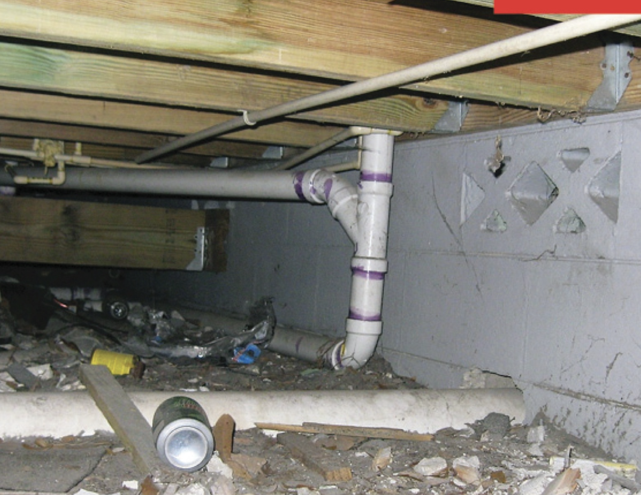

R408.5: Site Preparation Requirements
Section R408.5 of the 2024 IRC addresses a critical but often overlooked aspect of crawl space construction: the proper preparation of the under-floor grade prior to building occupancy.
Removal of Debris and Construction Material
The under-floor grade should be cleaned of all vegetation and organic material. This seemingly simple requirement serves several essential purposes:
  • Prevention of Termite Infestation: Vegetation, stumps, roots and other matter left in an excavation around a building are major causes of termite infestation. Organic material provides an attractive food source and harborage for wood-destroying organisms.
  • Moisture Management: Decaying organic material provides pockets for water accumulation, which can have subsequent destructive impact on the structure. These moisture pockets can lead to elevated humidity levels and associated problems.
  • Ground Settlement Prevention: As such material decays, the ground settles, negating the original drainage plan. This settlement can create low spots where water collects, potentially compromising the building's foundation.
Wood forms used for placing concrete should be removed before a building is occupied or used for any purpose.

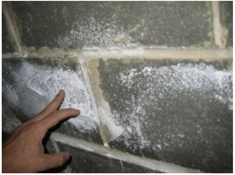

  • Water staining on foundation walls and floors
  • Efflorescence or mineral deposits on masonry surfaces
  • Rust on metal components near ground level
  • Moisture damage to wood elements
  • Standing water or mud in the crawl space
  • Excessive humidity or condensation
  • Presence of vegetation
  • Visible water channels or erosion patterns

Vapor Retarder Specifications
For the climate zones specified, the code requires:
  • A continuous Class I or II vapor retarder
  • Installation on the exposed face of air-permeable insulation
  • Placement between the floor joists and exposed to the grade
  • Maximum water vapor permeance of 1.5 perms
This requirement addresses issues with moisture accumulation in floors above vented crawl spaces in warm-humid climates. Without such protection, water vapor migrating from vented crawl spaces and post-and-beam foundations toward cooler and drier indoor spaces may cause mold, mildew and decay within floor assemblies—especially where an impermeable floor covering or underlayment is used.

  • Access Provisions (R408.4)
    • Measure access opening dimensions for compliance (18" × 24" for floor openings, 16" × 24" for perimeter openings)
    • Assess the adequacy of any areaway for below-grade access
    • Confirm access is not located under a door to the residence
    • Check for proper security of exterior access points

  • Ventilation Configuration (R408.2)
    • Count, measure, and photograph ventilation openings
    • Verify vent placement within 3 feet of corners (if required)
    • Examine vent covering materials for compliance with approved types
    • Calculate total net-free ventilation area based on visible vents
    • Check for operational louvers and seasonal adjustment capabilities

Ventilation System
  • The crawl space utilizes a traditional vented design with foundation vents
  • Eight foundation vents are present, each measuring 8" × 16" (128 sq in each)
  • All vents are covered with proper corrosion-resistant wire mesh with openings less than 1/4"
  • One vent is located within 3 feet of each corner as required
Defects Observed
  • Three of the eight vents are partially obstructed by insulation that has fallen from between floor joists
  • One vent on the west side is completely blocked by exterior landscaping
  • The actual net-free area of ventilation, accounting for screen reduction and blockage, is approximately 650 sq in, short of the required 1,152 sq in (1,200 ÷ 150 × 144)
Vapor Retarder
  • A vapor retarder covers approximately 90% of the soil surface
  • The material appears to be 6-mil polyethylene, compliant with general requirements
  • Seams are properly overlapped by 6" or more in most locations
Defects Observed
  • The vapor retarder does not extend to the foundation walls in several areas
  • There are three significant tears in the material, exposing soil
  • Pooled water is visible on top of the vapor retarder in one corner, indicating potential drainage issues

Floor Assembly Protection
  • Floor joists and subfloor appear to be in good condition with no visible moisture damage
  • The floor is properly insulated with fiberglass batts between joists
Defects Observed
  • In this Climate Zone 3A location, there is no vapor retarder on the exposed face of the insulation as required by R408.8
  • Approximately 20% of the insulation has fallen from between joists
  • Condensation is visible on several plumbing pipes and ductwork
