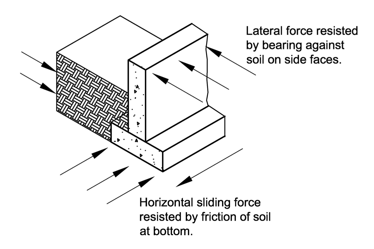

Foundations act as the crucial interface between a building and the earth during earthquakes. When seismic forces shake a structure, the entire building's lateral loads converge at the foundation level, essentially trying to slide the building sideways. The foundation's ability to resist this movement depends on how effectively it can push back against the surrounding soil.
Two key dimensions determine a foundation's earthquake resistance capacity:
  1. Width - The horizontal footprint of the foundation creates friction against the soil below
  2. Depth - The vertical surfaces of the foundation press against soil on both sides
These dimensions create two distinct resistance mechanisms:
  • Frictional resistance along the bottom surface
  • Passive soil pressure against the sides
This explains why increasing either the width or depth of a foundation significantly improves its ability to withstand lateral seismic forces.
It also illustrates why slab-on-grade construction offers superior earthquake resistance compared to perimeter-only foundations - the entire underside of the slab creates a massive frictional surface that resists sliding.
For home inspectors evaluating foundations, especially in seismic zones, these dimensions aren't just structural specifications - they're critical safety features designed to keep buildings firmly anchored during earthquake events.

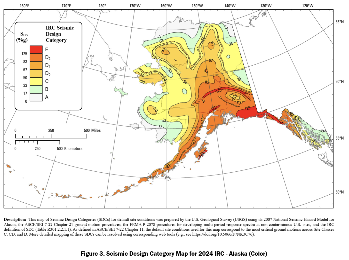

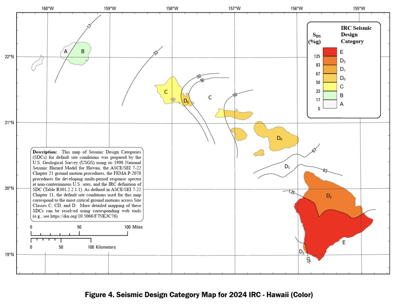

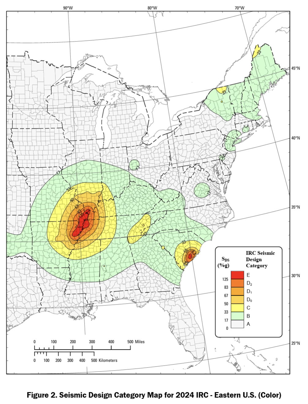

Seismic Design Categories Explained
Before diving into the reinforcement requirements, it's important to understand what these seismic design categories mean:
  • Seismic Design Categories (SDC) are classifications assigned to structures based on the anticipated intensity of ground motion in an earthquake.
  • Categories D0, D1, and D2 in the United States represent areas where stronger seismic activity is expected compared to Categories A, B, and C.
  • These designations determine the minimum structural requirements necessary to resist earthquake forces.
Where Are Seismic Design Categories D0, D1, and D2 Located?
Seismic Design Categories D0, D1, and D2 are primarily found in these regions of the United States:
  1. West Coast
    • Most of California, particularly along the San Andreas Fault system
    • Western Oregon and Washington, especially near the Cascadia Subduction Zone
    • Parts of western Nevada
  2. Intermountain West
    • Areas of Utah near the Wasatch Fault (particularly around Salt Lake City)
    • Parts of Idaho, Montana, and Wyoming near the Yellowstone region
    • Portions of western Colorado
  3. New Madrid Seismic Zone
    • Parts of southeastern Missouri
    • Northeastern Arkansas
    • Western Tennessee and Kentucky
    • Southern Illinois
  4. Charleston Area, South Carolina
    • The coastal region around Charleston, which experienced a major earthquake in 1886
  5. Alaska
    • Much of southern Alaska, particularly around Anchorage and the Aleutian Islands
  6. Hawaii
    • The Big Island of Hawaii, especially near active volcanic regions
The specific category (D0, D1, or D2) assigned to a location depends on several factors including the soil type at the building site, proximity to known fault lines, historical seismic activity, and the anticipated ground acceleration during an earthquake. Local building departments typically have detailed seismic zone maps that show the exact designation for their jurisdiction, and home inspectors should familiarize themselves with the seismic requirements in their service areas.

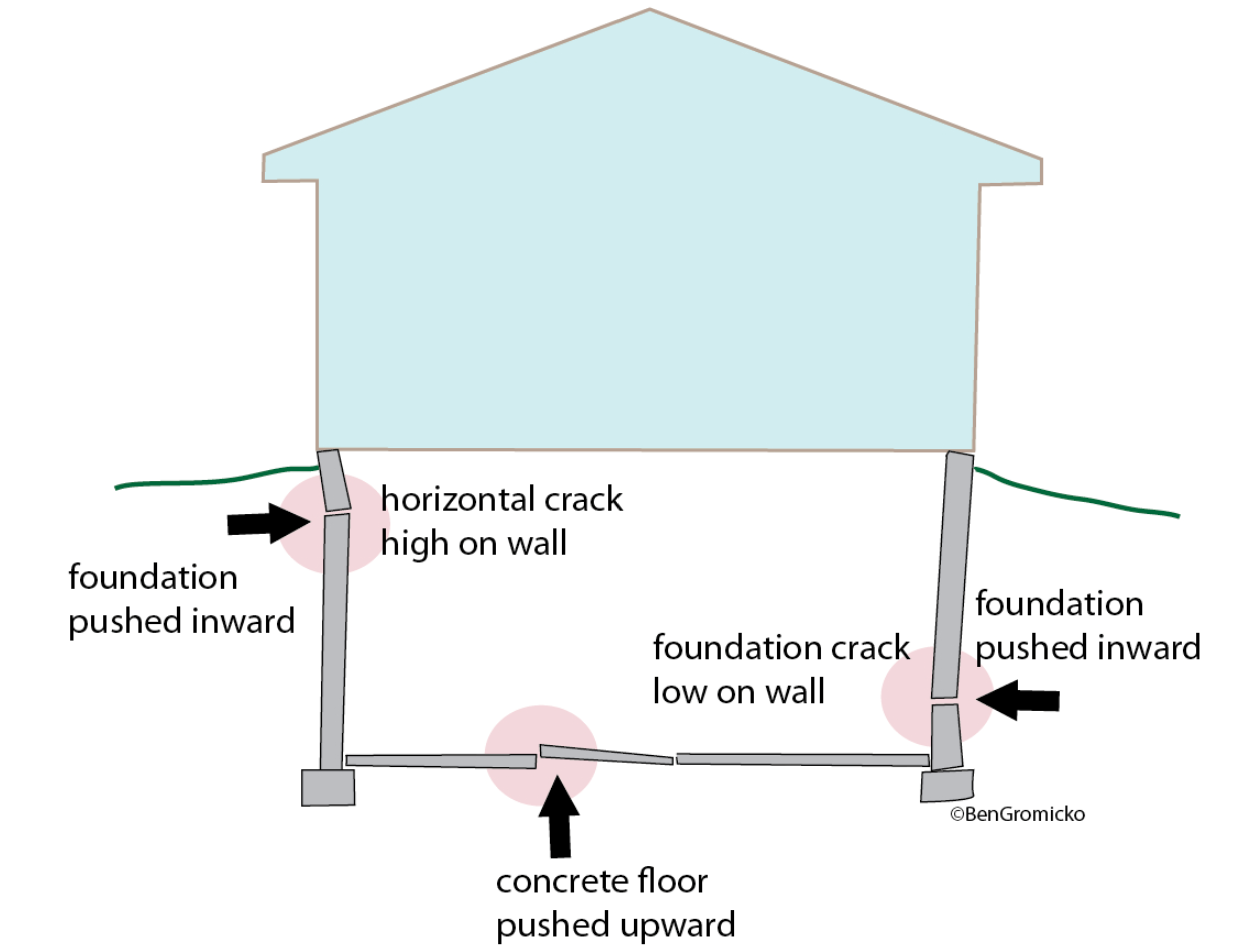

Reinforcement in seismic zones addresses three critical types of forces that occur during earthquakes:
  1. Lateral Forces: Side-to-side movement that can push walls off foundations
  2. Uplift Forces: Vertical forces that can literally lift portions of the foundation
  3. Shear Forces: Sliding forces that can cause foundations to crack and separate
Without proper reinforcement, these forces commonly lead to several types of foundation failures:
  • Shear Cracking: Horizontal cracks that develop when seismic forces push a stem wall laterally
  • Vertical Splitting: Foundation walls splitting due to inadequate spacing of vertical reinforcement bars
  • Foundation Uplift: Portions of the foundation lifting due to insufficient anchoring
  • Displacement: The entire structure shifting off its foundation due to inadequate connections
The reinforcement requirements detailed in the building code directly address these failure mechanisms by creating a unified, interconnected foundation system that can flex slightly without catastrophic failure.

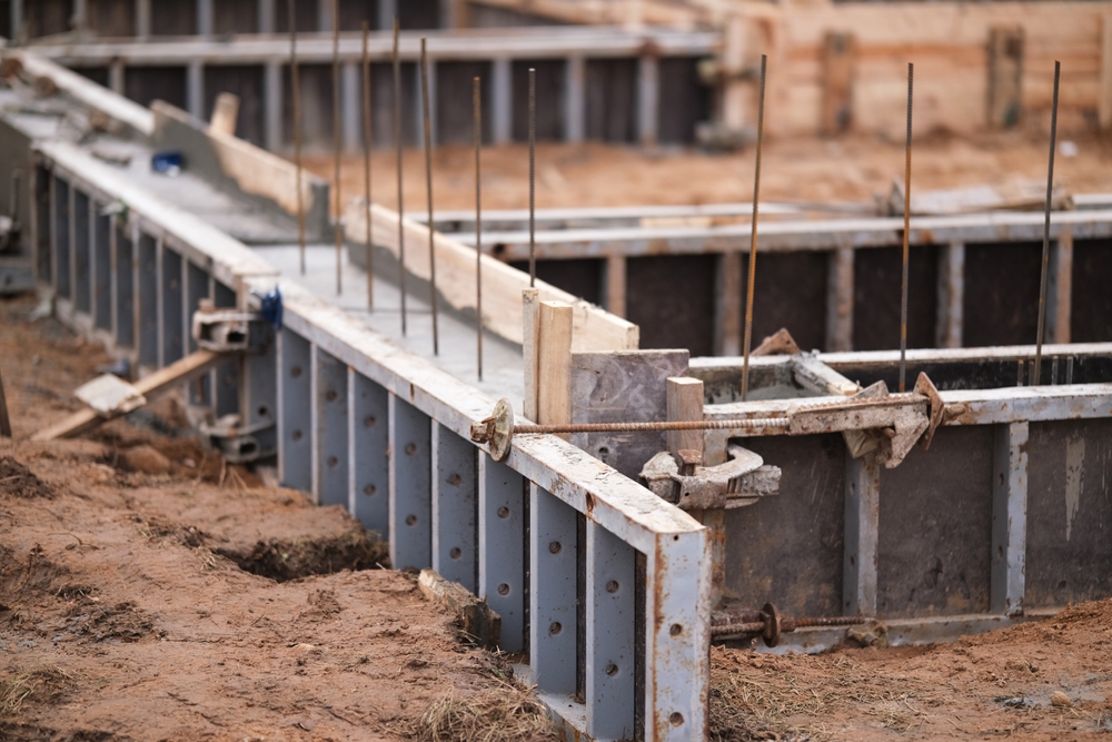

Key Reinforcement Requirements

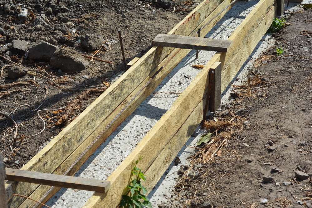

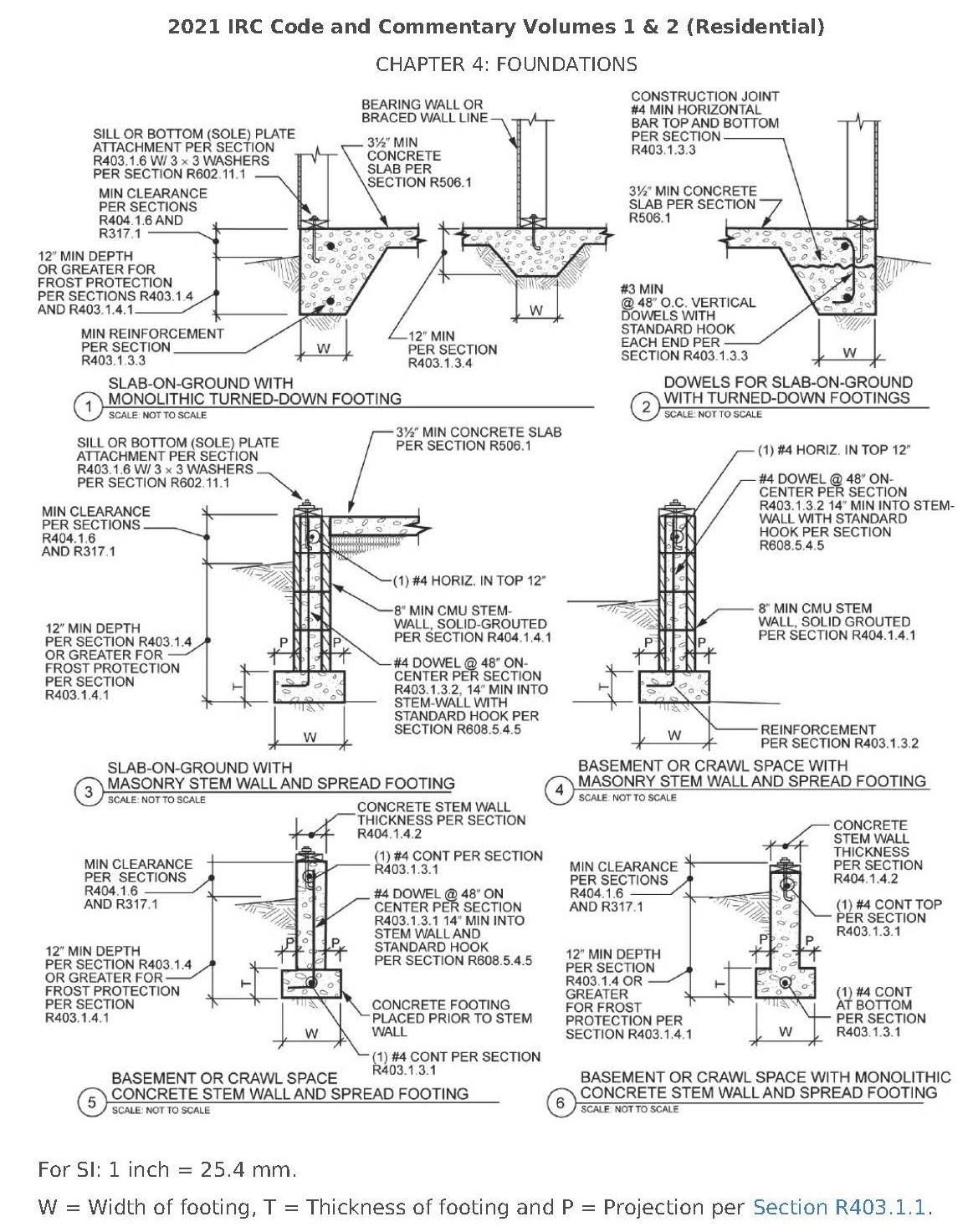

According to 2024 IRC Section R403.1.3 of the International Residential Code (IRC), concrete footings in SDC D0, D1, and D2 must include:

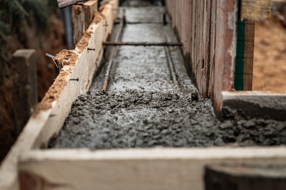

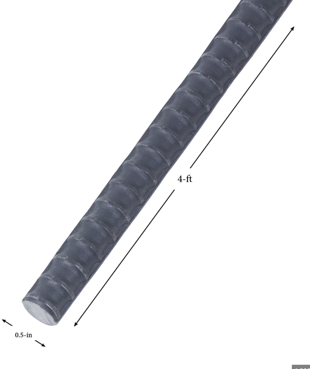

  1. Vertical Reinforcement: Minimum one No. 4 bar (1/2 inch diameter) at maximum 48-inch intervals (IRC R403.1.3)
  2. Horizontal Reinforcement: Specific placement at both top and bottom portions of the foundation system (IRC R403.1.3.1)
  3. Proper Bar Support and Cover: Ensuring reinforcement stays in the correct position during concrete placement (IRC R403.1.3.5.3)

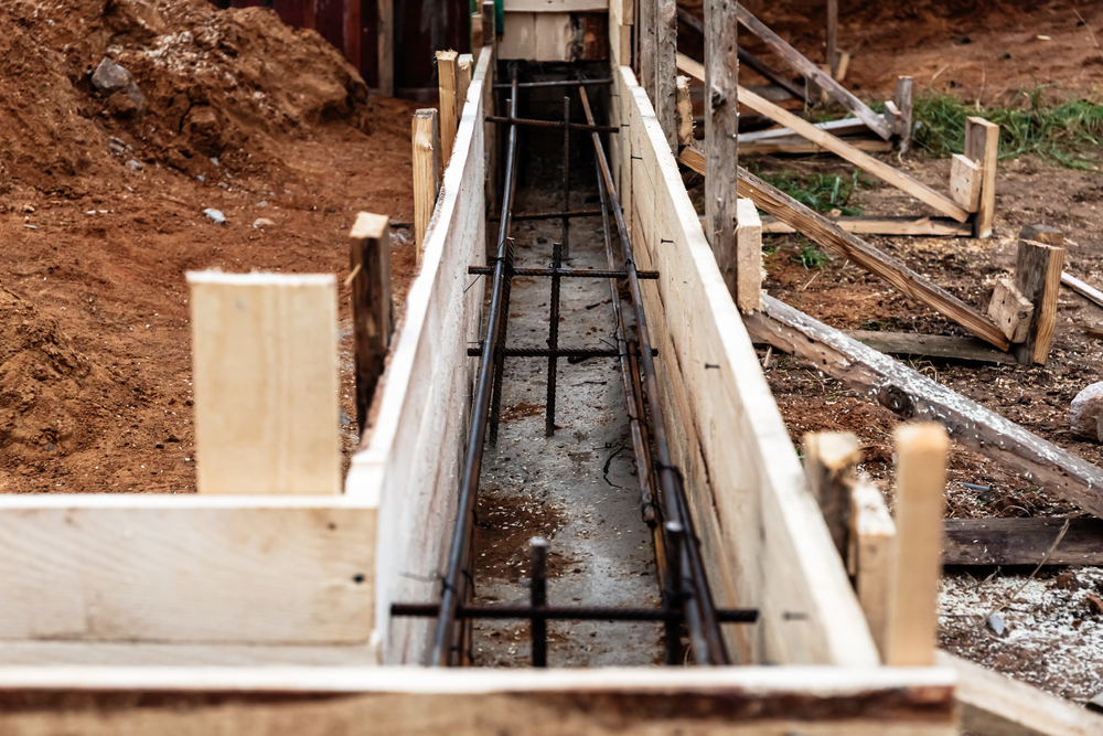

Concrete Stem Walls with Concrete Footings

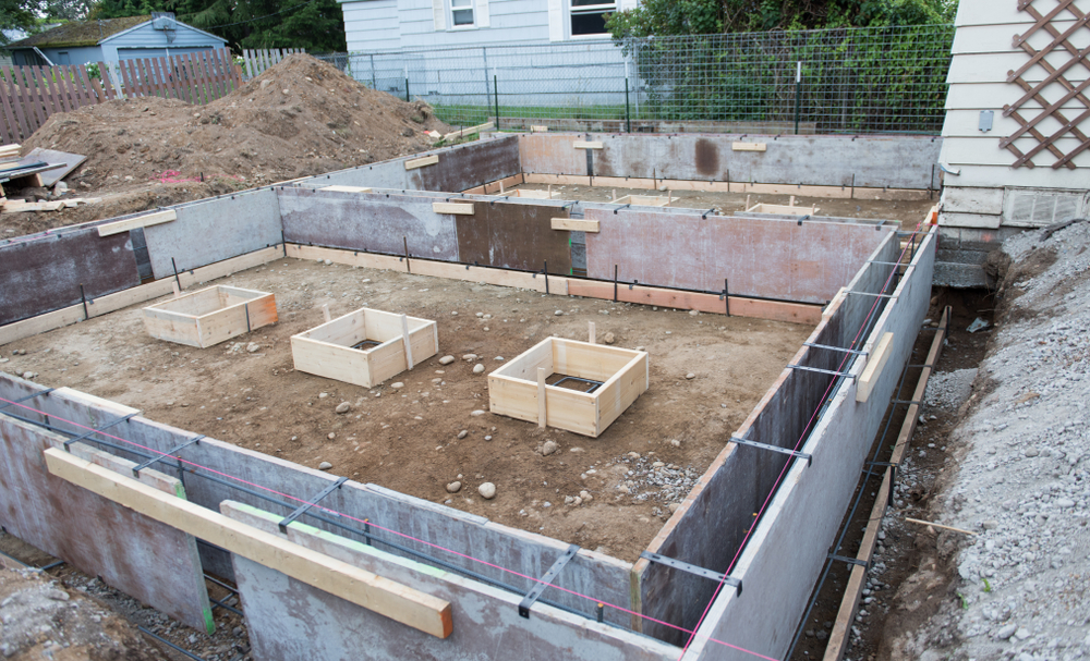

For homes with concrete stem walls on concrete footings (a common configuration), the code requires:
  • Vertical Bars: No. 4 bars placed no more than 4 feet apart (IRC R403.1.3.1)
  • Standard Hooks: These bars must include standard hooks extending to the bottom of the footing (IRC R403.1.3.1)
  • Minimum Extension: Vertical bars must extend at least 14 inches into the stem wall (IRC R403.1.3.1)
  • Horizontal Reinforcement: One No. 4 bar within 12 inches of the stem wall's top and another placed 3-4 inches from the bottom of the footing (IRC R403.1.3.1)
Click here to view IRC's illustration.

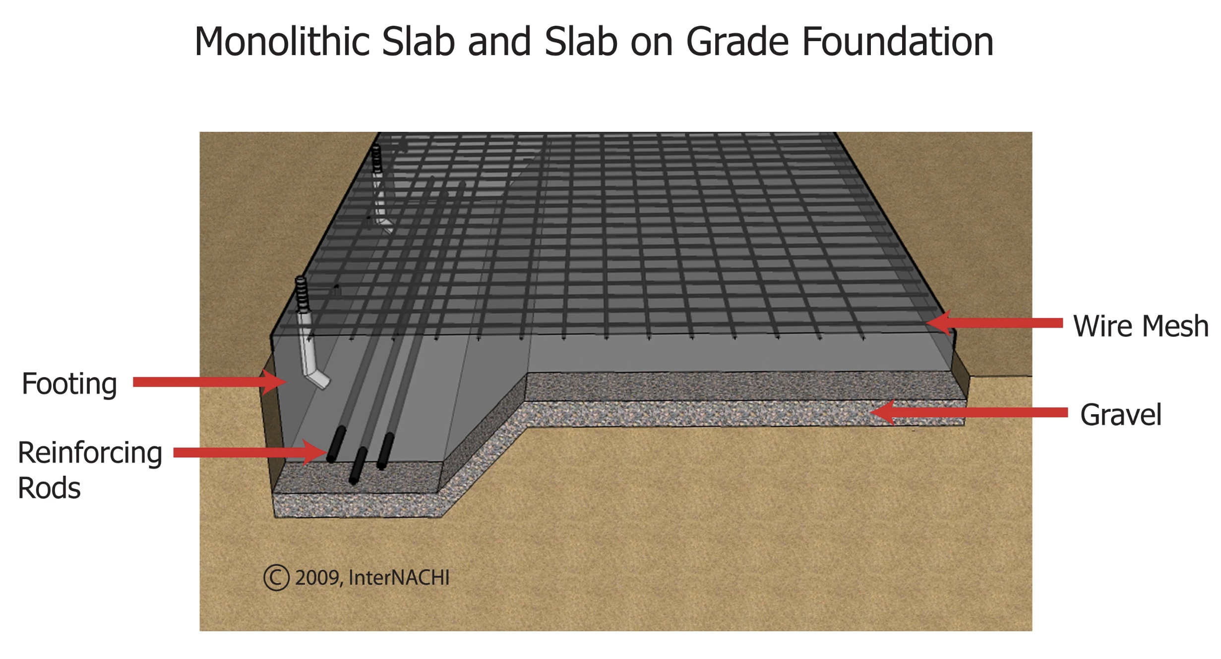

Monolithic Slabs with Turned-Down Footings
For slab-on-ground construction cast as a single unit with a turned-down footing (monolithic pour), IRC Section R403.1.3.2 requires:
  • Either one No. 4 bar at both top and bottom of the footing
  • OR one No. 5 bar or two No. 4 bars in the middle third of the footing depth
Non-Monolithic Construction
When the slab and footing are not poured as a single unit, vertical dowels must be installed at the construction joint as specified in IRC Section R403.1.3.3. This detail is critical to prevent slippage during seismic events—a common failure point in earthquakes.
Interior Footing Requirements
In these seismic zones, IRC Section R403.1.3.4 specifies that interior footings that support bearing walls or braced wall panels and are cast monolithically with a slab must:
  • Extend to a depth of at least 12 inches below the top of the slab
  • This provides adequate depth for proper installation of anchor bolts and tie-downs

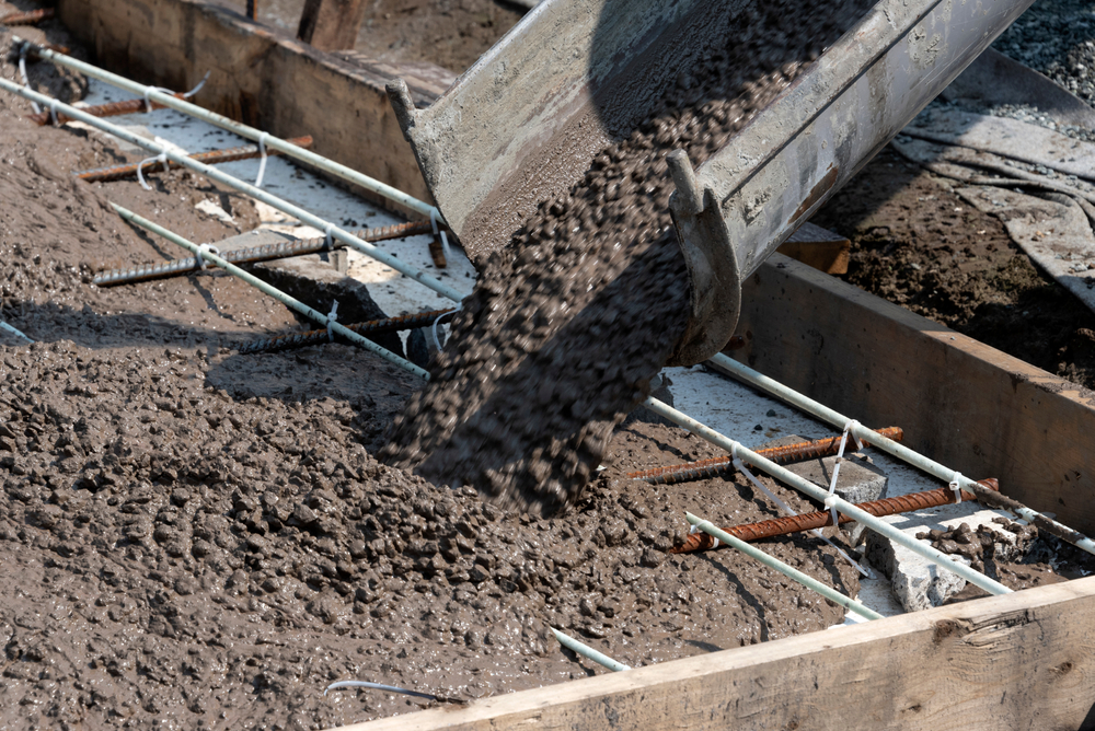

The effectiveness of reinforcement depends not just on its presence, but on its precise placement:
  • Centered Placement: Vertical reinforcement in stem walls must be located at the wall's centerline (IRC R403.1.3.5.2)
  • Secure Positioning: Reinforcement must be secured with tie wire or other support systems to prevent displacement during concrete placement (IRC R403.1.3.5.3)
  • Adequate Cover: Sufficient concrete cover is required to protect reinforcement from corrosion and ensure proper bonding (IRC R403.1.3.5.4)

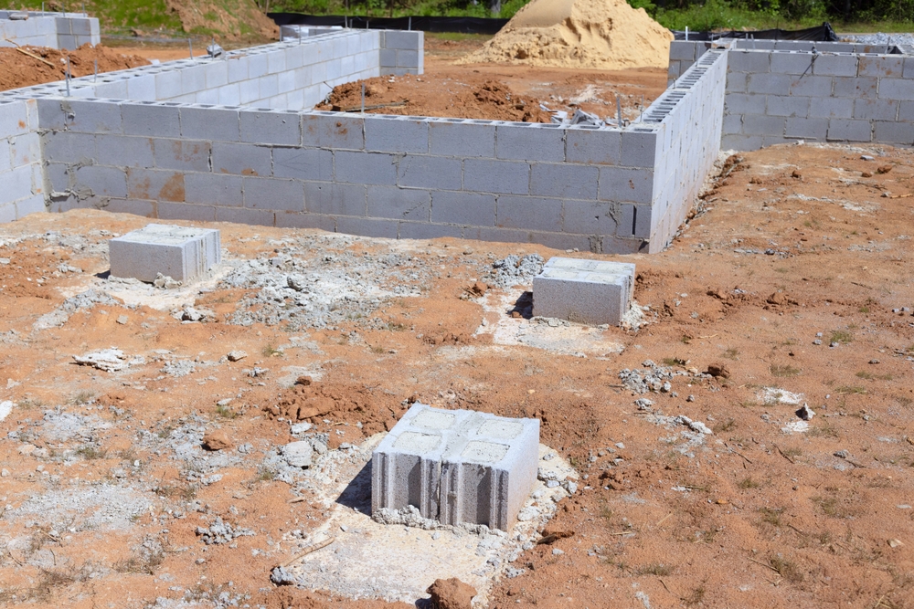

Isolated Concrete Footings: An Exception
In detached one- and two-family dwellings that:
  • Are three stories or less in height
  • Are constructed with stud bearing walls
IRC Section R403.1.3.6 permits isolated plain concrete footings that support columns or pedestals without the reinforcement described above. This exception recognizes that these elements typically don't support or anchor braced walls.

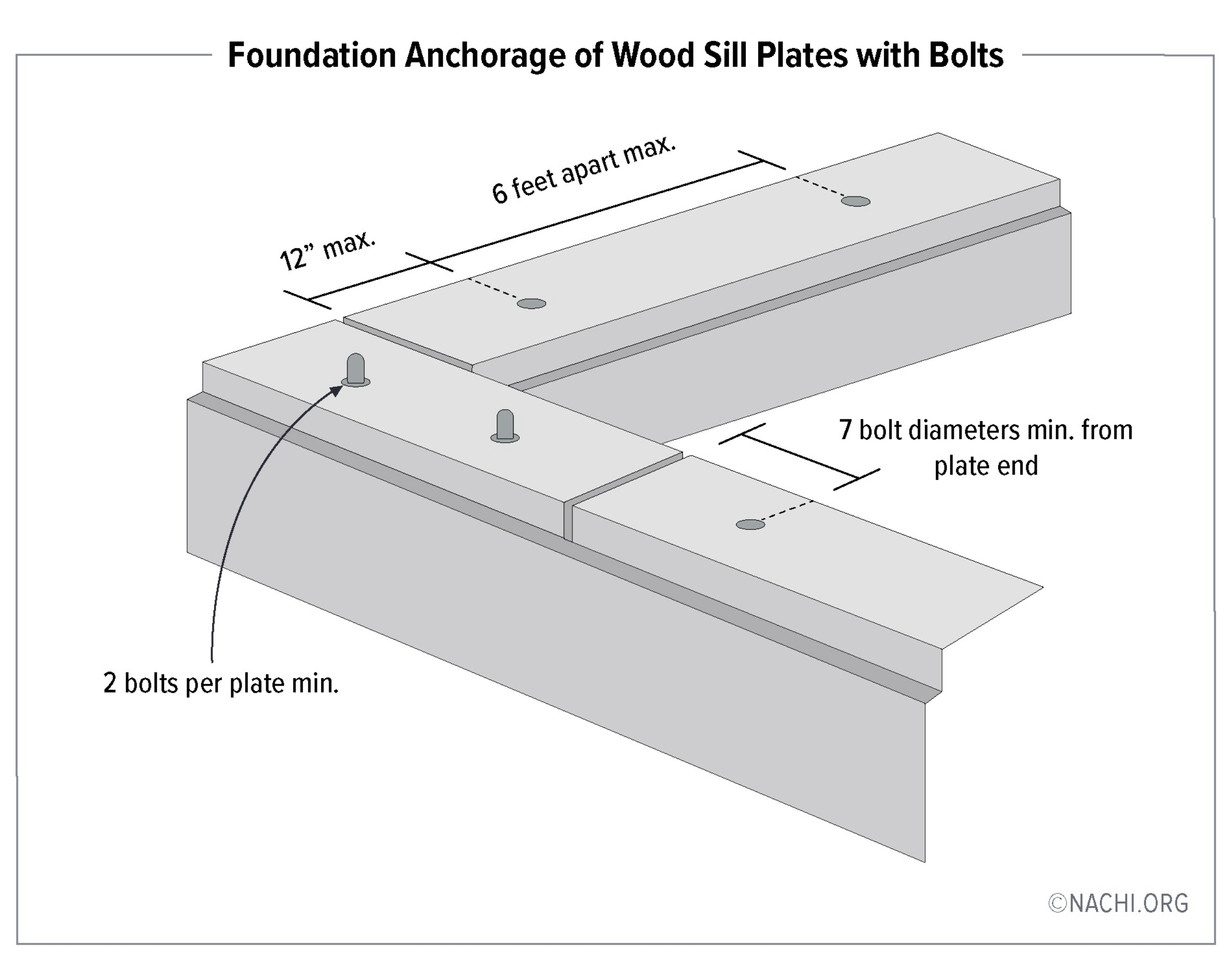

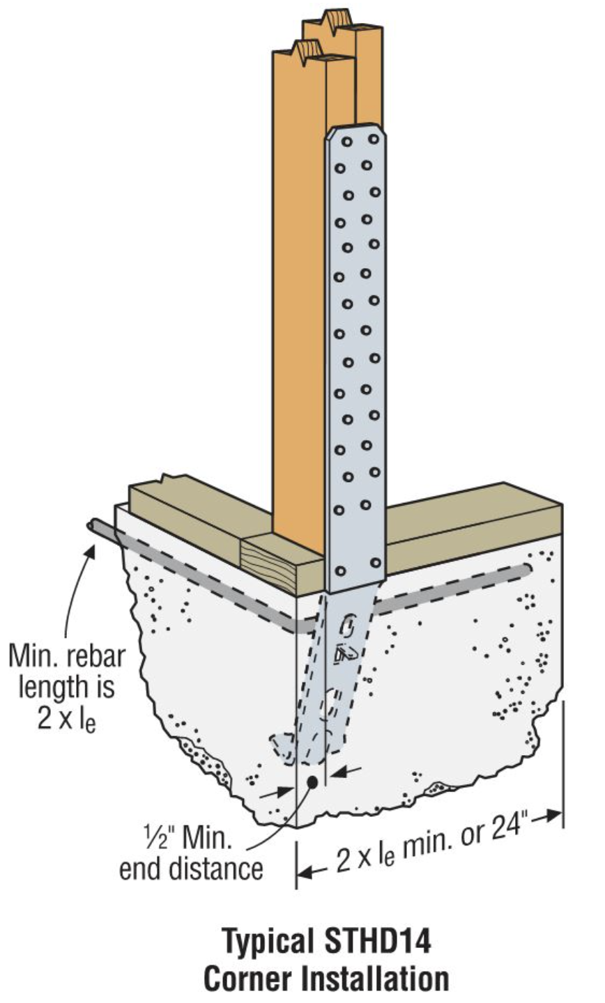

Anchor Bolts and Hold-Downs
  • Minimum Embedment: Anchor bolts must be embedded at least 7 inches into concrete (IRC R403.1.6)
  • Spacing Requirements: Typically 6 feet apart maximum, but spacing may be reduced to 4 feet or less in higher risk areas (IRC R403.1.6.1)
  • Plate Washers: Oversized square washers (3"×3"×¼") must be used to improve load distribution (IRC R602.11.1)
  • Edge Distance: Bolts must be placed at least 1.75 inches from the edge of the sill plate (IRC R403.1.6)
Straps and Tie-Downs
  • Critical in stem wall construction to secure the structure to the foundation
  • Required at corners and near openings
  • Must be rated for the appropriate design loads
  • Often used in conjunction with anchor bolts for a complete load path
