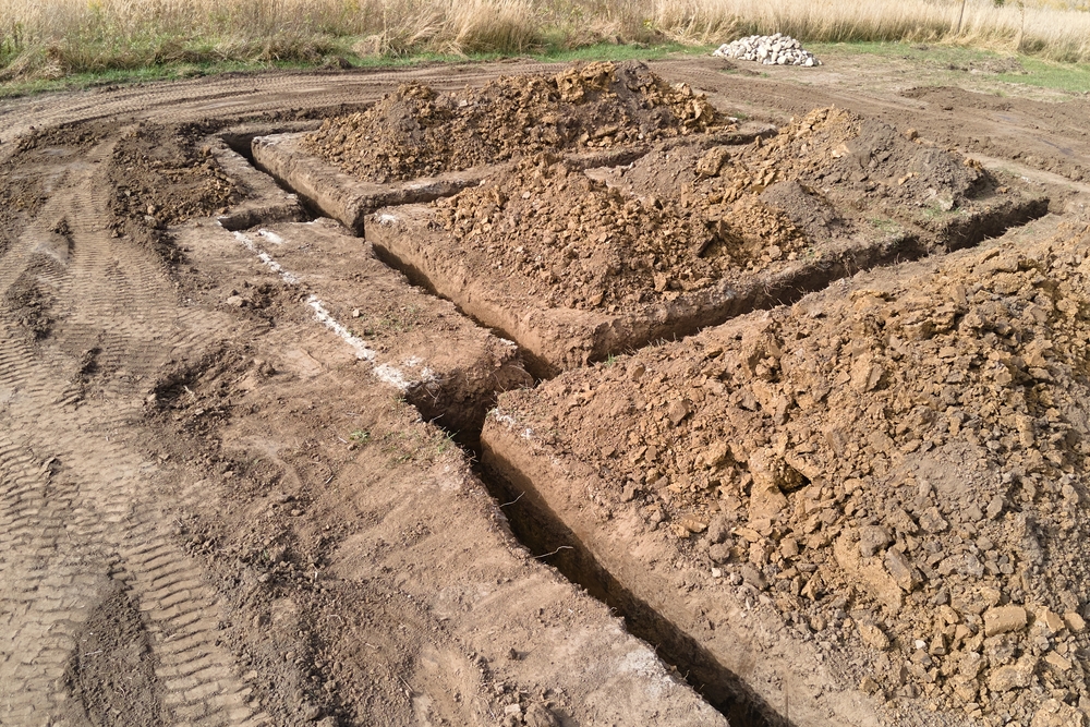

Foundation Inspection (R109.1.1)
The foundation inspection is typically the first inspection of the job site by a representative of the local building department. At that time, the inspector will verify that the foundation is located as shown on the approved plans and in accordance with the jurisdictional requirements for building setbacks and easements.
  • Where a footing system is to be used, the footing trenches must be excavated and any required reinforcing steel must be in place.
  • For foundation walls, the wall forms must be completely erected with the appropriate steel reinforcement placed within the forms.
  • Column pads, thickened slabs, and other foundation work must also be ready for inspection prior to concrete placement.
  • This inspection verifies proper foundation preparation and construction. It includes checks for poles, piers, trenches, forms, reinforcing steel, and thickened slabs.
In essence, this inspection ensures the home's structural base is built well without any indications of major defects.

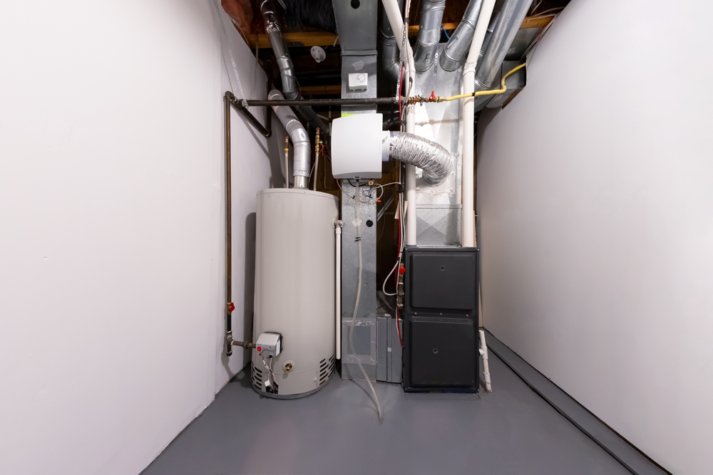

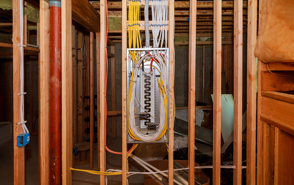

Plumbing, Mechanical, Gas, and Electrical Systems Inspection (R109.1.2)
The electrical, gas, mechanical, and plumbing systems that are to be concealed must be inspected and approved prior to their concealment. This is referred to as the “rough-in” inspection.
  • The inspector checks that piping, ductwork, wiring, and gas lines are properly installed, and that systems comply with code requirements.
  • This "rough-in" inspection happens before walls and ceilings are covered. It verifies that these essential systems are installed correctly and safely. The effect of these systems on the structural integrity of the building must be reviewed after they are completed and ready to be covered.
  • After all of the trades inspections are completed, approvals are granted prior to the inspection of the framing system.
This inspection occurs before fixtures and appliances are installed. There’s an exception for the backfilling of ground-source heat pump loop systems which is allowed after testing the system, but before final inspection.

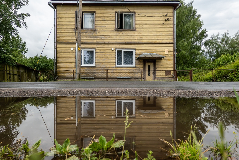

Floodplain Inspections (R109.1.3)
For any building constructed in a flood hazard area, the elevation of the lowest floor level must be established immediately after the placement of the floor system.
  • Documentation of this elevation is evidence of compliance. If the documentation is submitted when the lowest floor level is established and before further vertical construction, errors in elevation may be corrected at the least cost.
  • The elevation of the lowest floor is used by insurance agents to compute federal flood insurance premium costs. An error in the minimum required elevation may significantly increase the cost of flood insurance.
  • If the elevation of the lowest floor goes uncorrected, all future owners will be exposed to flood hazards and incur the additional recovery costs and insurance costs.
  • Documentation of elevations is required prior to the final inspection.
For homes in designated flood hazard areas, this inspection is critical. The inspection happens after the lowest floor (including basement) is placed, but before vertical construction begins. The building official requires documentation of the elevation of the lowest floor, prepared and sealed by a registered design professional. This ensures the home is built at the required elevation to minimize flood risk.

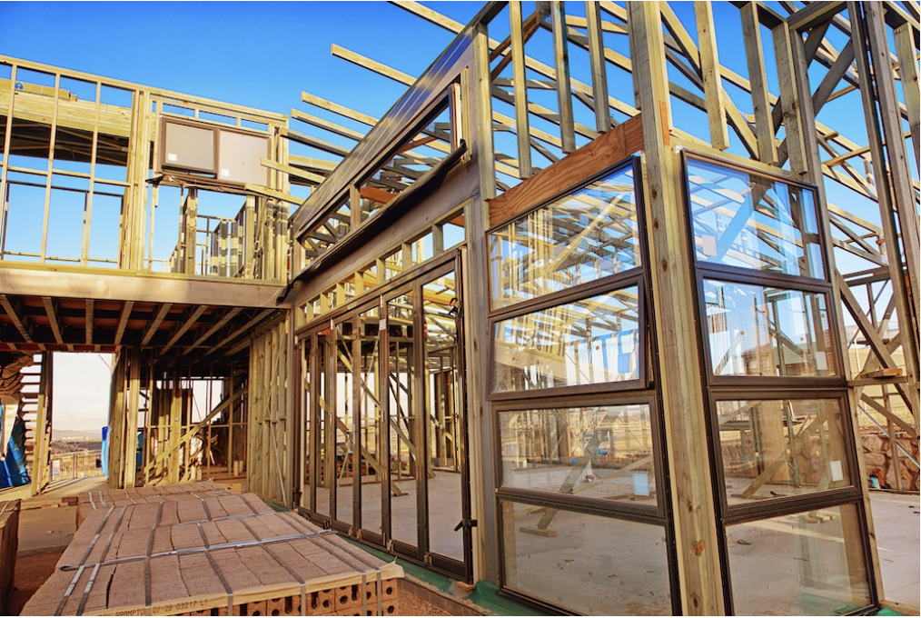

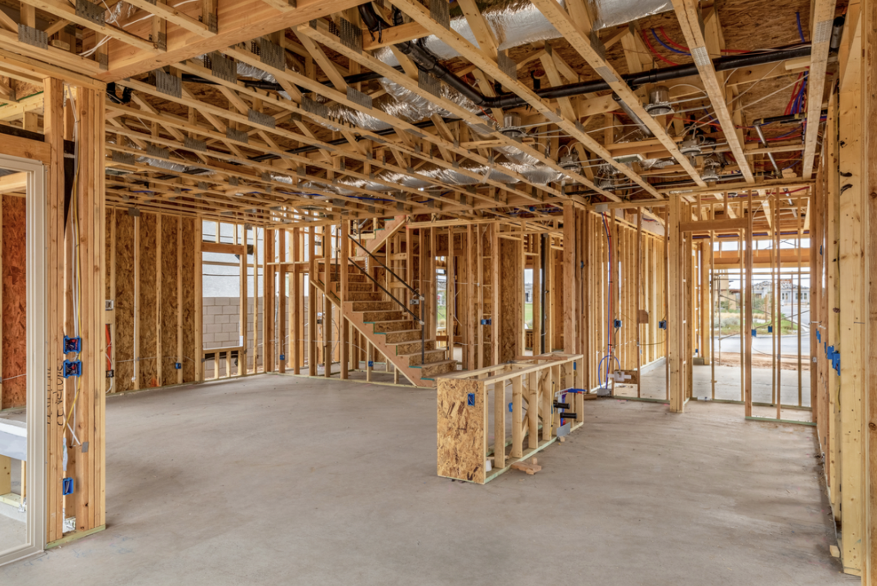

Frame and Masonry Inspection (R109.1.4)
The framing inspection is usually the final opportunity for the inspector to view all the items that will be concealed within the structure.
  • The inspection includes the structural framework of the building, as well as any fireblocking or draftstopping that will be contained within concealed spaces.
  • All electrical, mechanical, gas, and plumbing inspections must be completed and approved prior to the framing inspection.
  • This allows any framing members to be repaired while they are open for access.
  • This inspection occurs after the rough-in inspections are approved.
  • It verifies the structural integrity of the home's framing and masonry.
  • The inspector checks that the roof, framing, masonry, firestopping, draftstopping, and bracing are all correctly installed.
This inspection ensures the home's structural framework is built well without any indications of major defects.

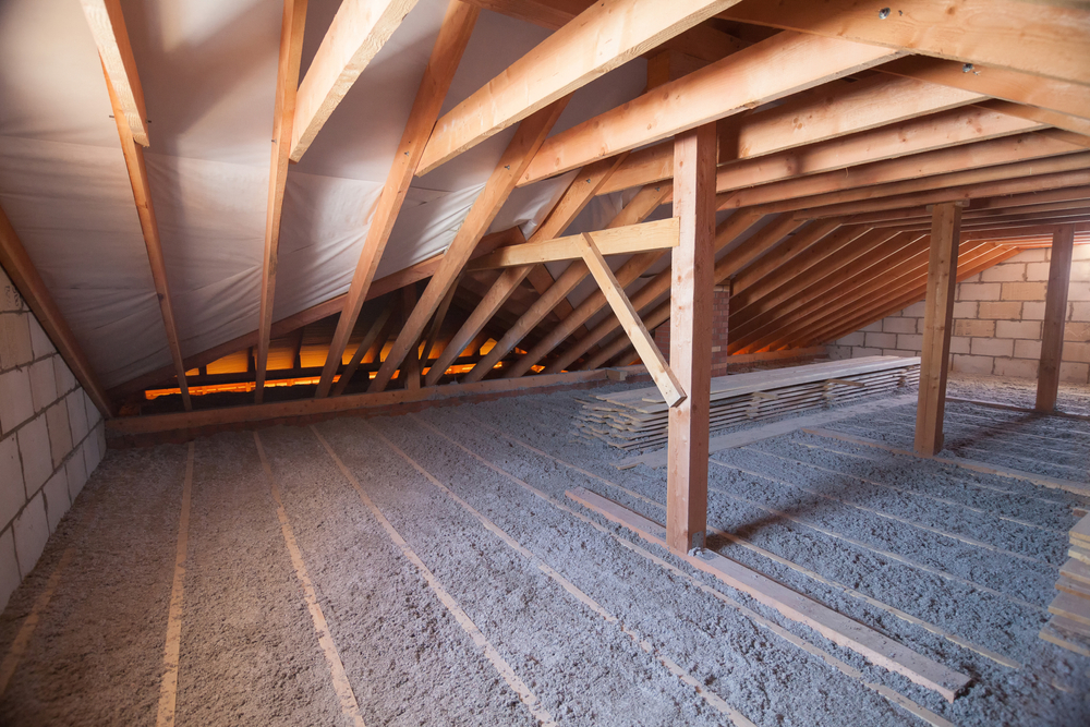

Other Inspections (R109.1.5)
Any item regulated by the code is subject to inspection by the building official to determine compliance with the applicable code provision, and no list can include all types of work in a given building. Also, other inspections before, during, or after the rough-in could be necessary.
  • The building official has the authority to inspect any regulated work.
  • A variety of other inspections, such as those for gypsum board or insulation, may be mandated by the building department to verify compliance with the code or other city ordinances. These inspections are generally established as a result of local concern regarding a specific portion of the construction process.
The building official has the authority to make or require any other inspections to ascertain compliance with this code and other laws enforced by the building official.

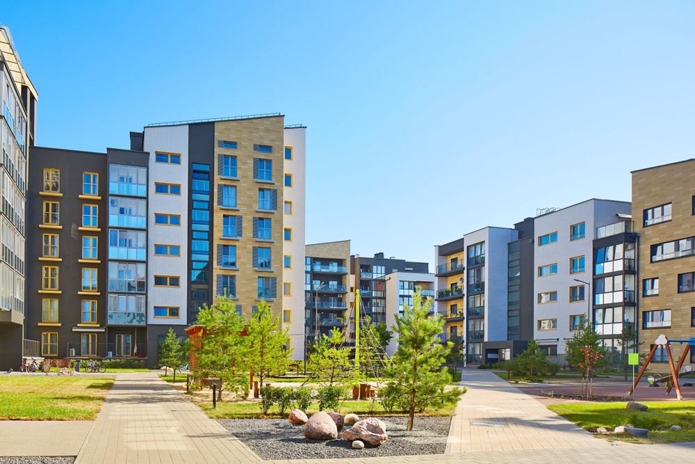

Fire-Resistance-Rated Construction Inspection (R109.1.5.1)
There are a limited number of situations in which fire-resistance-rated construction is required by the code.
  • For example, where two or more dwelling units are located within the same structure, they are required to be completely separated from each other by a specified level of fire resistance. This is the case for two-family dwellings and townhouses.
  • A second example would be the proximity of the building to an adjoining property line. Code requires exterior walls located less than 3 feet (914 mm) from a property line (unless abutting a public way) to be of minimum 1-hour fire-resistance-rated construction.
  • If either of these conditions should occur, an inspection of the fire-resistance-rated construction is required.
  • The inspection for compliance with the fire-resistance requirements of the code should happen when the covering materials are in place, but the fasteners are still exposed. This allows the inspector to verify the appropriate fastener type and location based code requirements.
Where fire-resistance-rated construction is required between dwelling units or due to location on property, the building official can require an inspection of such construction after lathing or drywall are installed, but before any plastering or compound is applied, or before joints and fasteners are taped and finished.

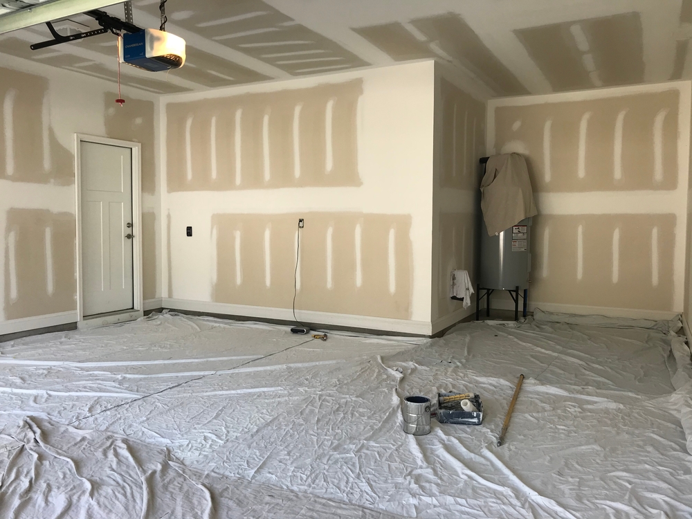

Pre-Drywall Inspection (Not Listed in the Code)
A pre-drywall inspection, also known as a “rough-in” inspection, is a critical phase in the construction process of a new home or renovation project.
  • This inspection occurs after the foundation, framework, roofing, exterior covering, doors, windows, mechanical systems, plumbing, and electrical have been installed and before the insulation and interior walls and ceilings are covered.
  • The primary purpose of a pre-drywall inspection is to verify that the structural, mechanical, plumbing, and electrical systems have been installed correctly and comply with building codes, plans, and specifications. In essence, a pre-drywall inspection helps ensure the home's systems are installed properly without any indications of major defects before the drywall is installed.
  • This inspection provides an opportunity to identify and correct any issues before they become hidden behind the interior wall, ceiling and floor coverings, where they could be challenging and costly to correct.
  • A pre-drywall inspection is a critical inspection performed by trained home inspectors. It could identify major problems before they’re covered up.
There’s an online “Pre-Drywall Inspection Course” offered by a tuition-free nationally-accredited college for inspectors at internachi.edu. The course is online, self-paced, and includes an open-book exam.
