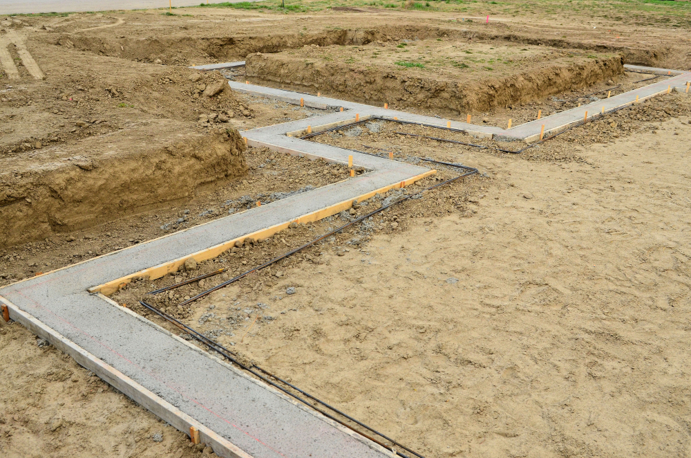

What Are Footings?
Footings are thick slabs of concrete (or sometimes crushed stone or masonry) that spread the weight of a house so it doesn’t sink into the ground like a bad investment. They go under the foundation walls and make sure the home stays put—no settling, no cracking, and no dramatic collapses.
According to the 2024 IRC (International Residential Code) Section R403, all exterior walls must be supported by one of the following:
  • Concrete or masonry footings (the gold standard)
  • Crushed stone footings (fancy gravel)
  • Wood foundations (not as common, but still an option)
  • Other approved structural systems (basically, anything engineers say is safe)
The footing’s job is to hold up the weight of a home, distribute that weight properly, and keep everything stable.

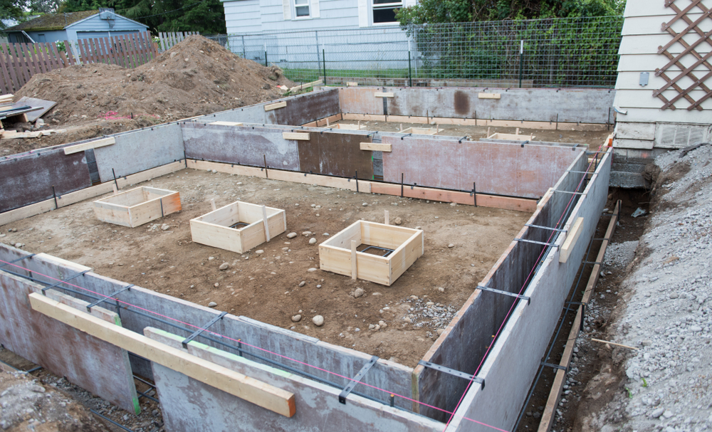

Footings can’t just sit on any old dirt pile. The IRC says they must be placed on:
  • Undisturbed natural soil (the ground as nature intended)
  • Engineered fill (dirt that’s been compacted and tested)
In other words, you can’t just backfill a hole, tamp it down with your boots, and call it good. Footings need solid ground or properly prepped fill beneath them.

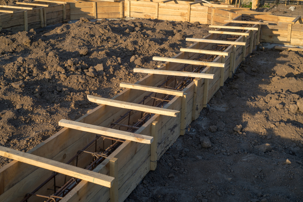

How Big Should Footings Be?
Footing sizes depend on a few things:
  • How wide the building is (A 12-foot cabin doesn’t need the same footings as a 50-foot McMansion.)
  • What the house is made of (Wood? Brick? Concrete? Each one adds different weight.)
  • How much snow or live load the roof carries (In snowy places, footings have to work harder.)
  • What kind of soil you’re dealing with (Clay? Sand? Rock? Some soils need bigger footings.)
The IRC has tables (more tables than a furniture store) that tell you how wide and deep footings should be. But here’s the quick version:
  • Minimum footing thickness = 6 inches (thicker if you have heavier loads)
  • Minimum footing width = 12 inches
  • If your house is wider, footings get wider too
And if you have a basement or crawl space, footings get even bigger to handle the extra weight of the foundation walls.

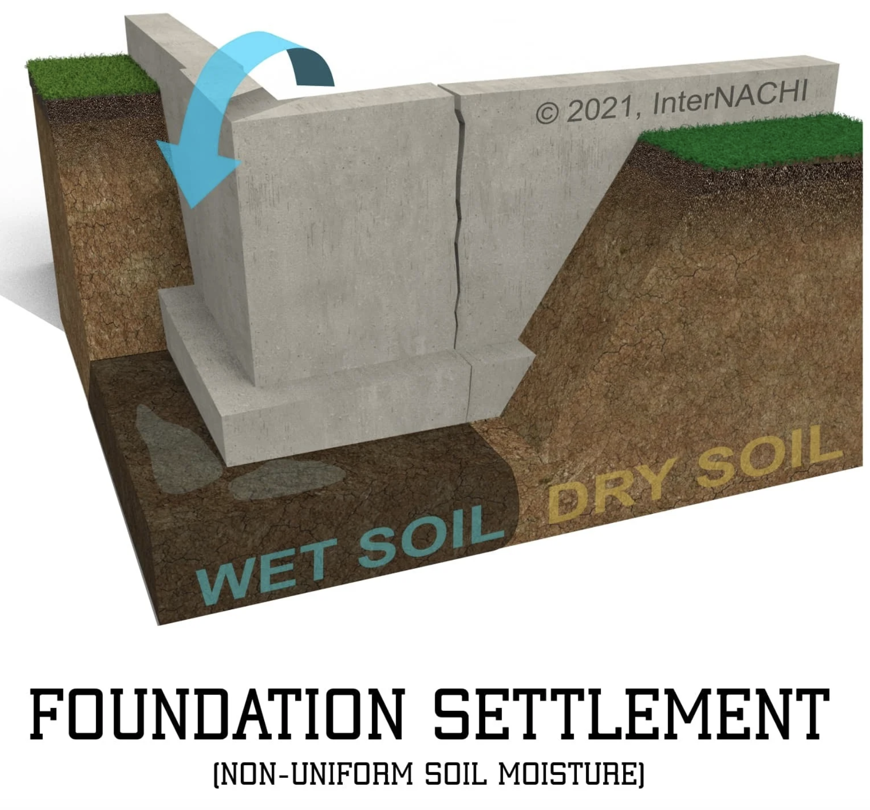

Not every plot of land is ready for footings. If a house is being built on bad soil, it might need a structural engineer to design something stronger.
If the soil is any of these, watch out:
  • Loose fill (like dumping a truckload of dirt and hoping for the best)
  • Expansive clay (swells when wet, shrinks when dry)
  • Soft sand or silt (basically like building on a beach)
  • Compressible clays (sinks over time like an old mattress)

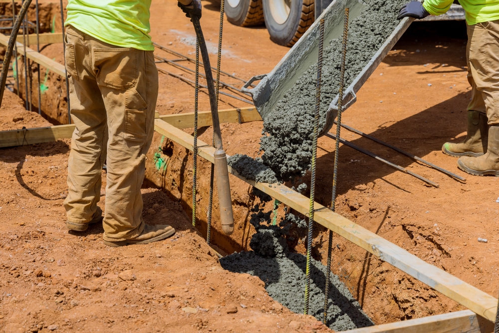

Also, footings should NEVER be poured on frozen ground. If it must be built in winter, the builder should make sure the soil is frost-free and protected from freezing.

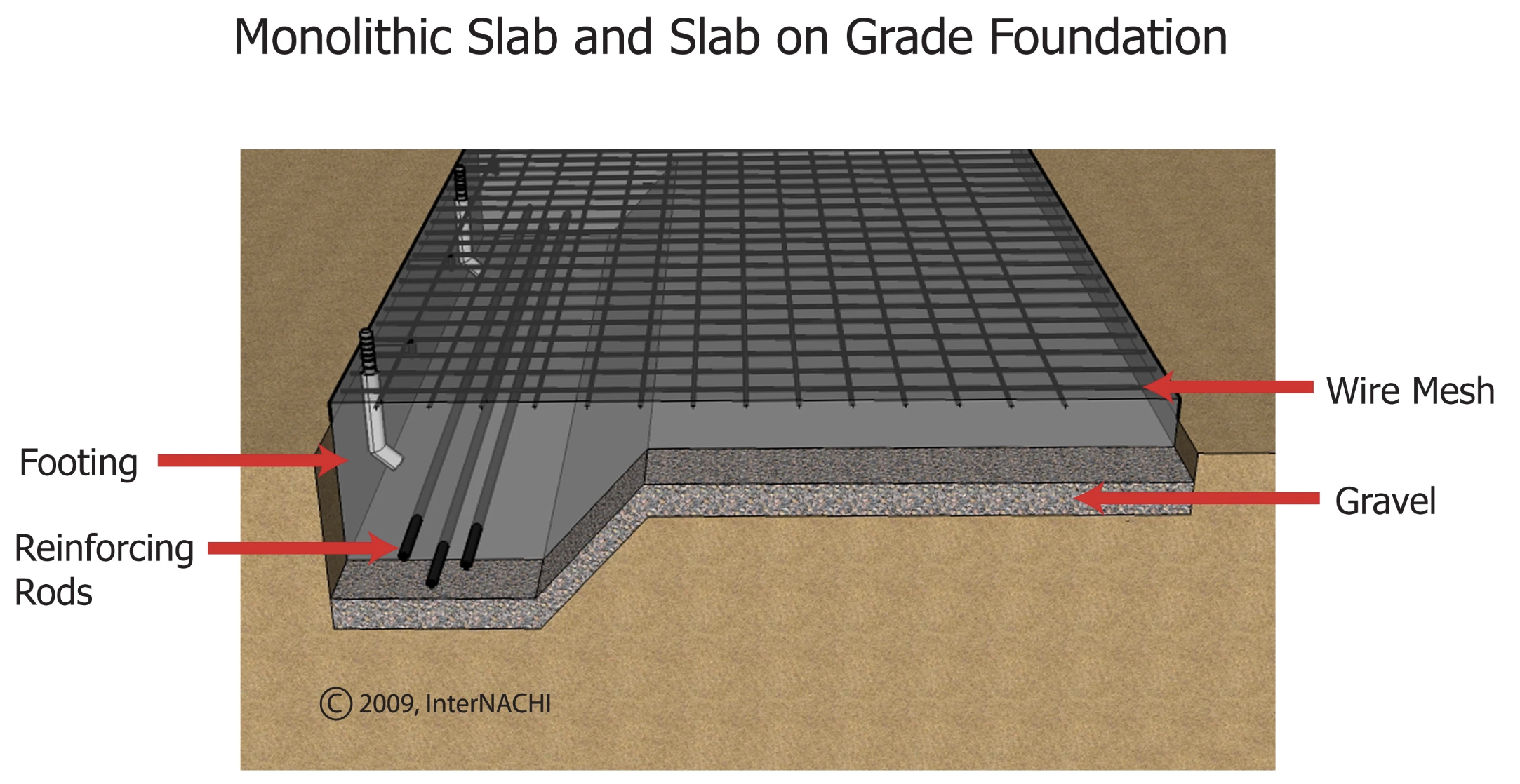

Slab, Crawlspace, or Basement—Which Needs Bigger Footings?
Your footing size depends on what’s above it.

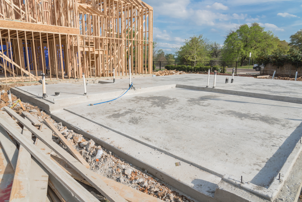

  • Slab-on-grade homes = The lightest option, so footings are the smallest.

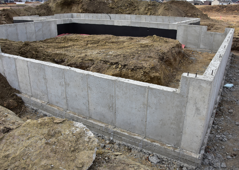

  • Crawlspace foundations = Need bigger footings to hold up the foundation walls.
  • Basements = The heavy weight champion, so it needs the biggest footings since it’s holding up extra concrete.
The IRC® now considers basement walls when sizing footings, which is an improvement from the old days when they just ignored that little detail.

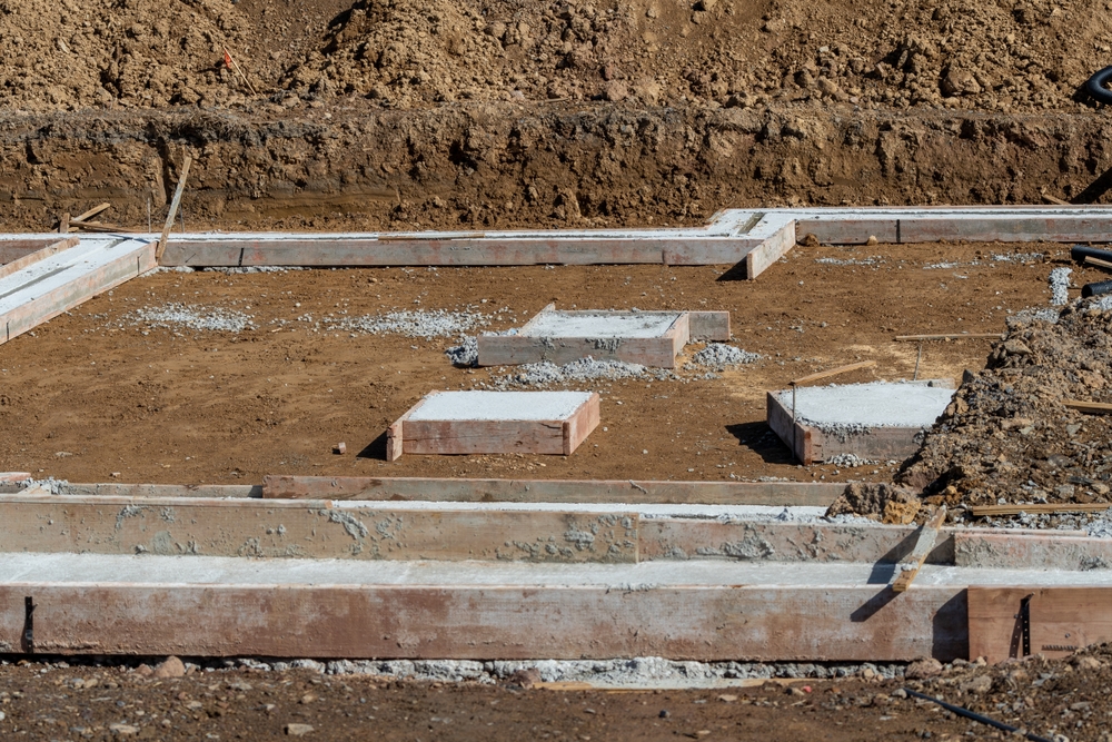

R403.1.1 Minimum Size—Breaking It Down
Alright, let’s keep this simple: How big do footings need to be? The answer: at least 12 inches wide and 6 inches thick—no exceptions.
The exact size of the footings depends on a few things (like how heavy your house is and what kind of soil you’re working with), which is why the IRC has multiple tables (R403.1(1) through R403.1(3)) and handy diagrams (Figures R403.1(1) and R403.1.3) to help you out.
But here’s the golden rule: No matter what the tables say, you can’t go smaller than 12 inches wide and 6 inches thick.
A house needs a solid base to stay put. So, when in doubt, go by the tables.
R403.1.4 Minimum Depth—How Deep Should Footings Go?
If you’re thinking about how deep to dig before pouring a footing, here’s the magic number: at least 12 inches below the ground surface.
Why?
Because the ground moves—especially in colder climates where freezing and thawing can push shallow footings around like a big bully. By sinking them at least a foot deep, you help protect the foundation from shifting soil and seasonal movement.
But wait—there’s more!
If you’re in an area with frost, check out Section R403.1.4.1 for even deeper frost protection rules.

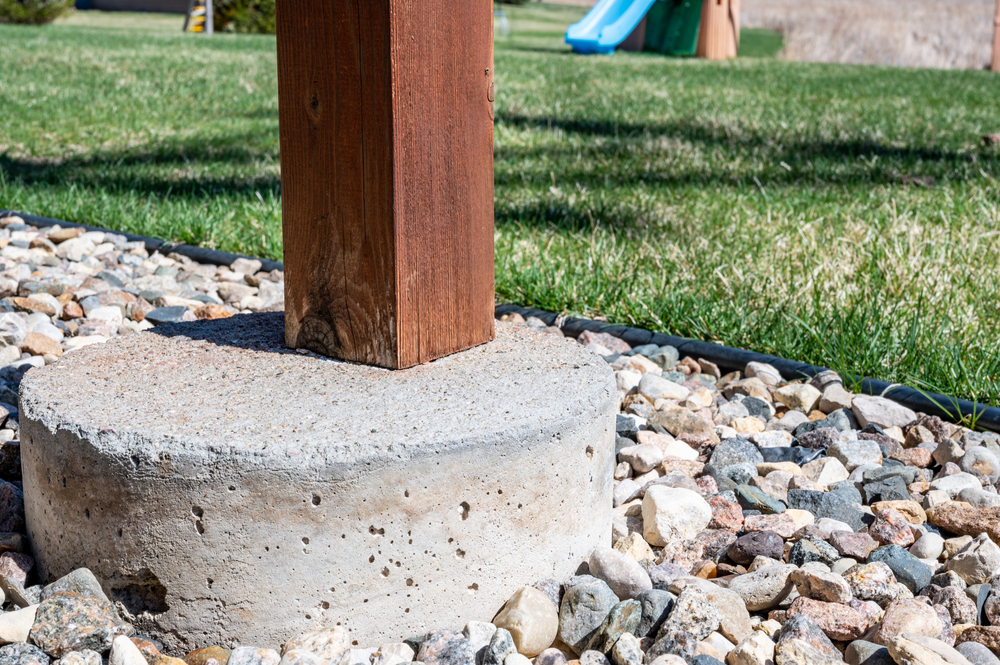

Building a deck? Deck footings have their own special rules in Section R507.3, so don’t assume the same depth applies.

Frozen Ground = Big Problems
If you’ve ever left a bottle of soda in the freezer too long, you know what happens—it expands, cracks, and makes a mess. The same thing happens to soil when it freezes: it expands, shifts, and then contracts when it thaws. That’s called frost heave, and it’s bad news for buildings. If the foundation is resting on frozen soil, once that ice melts, the ground settles unevenly—causing cracks, tilting, and general foundation chaos.
That’s why footings CANNOT be placed on frozen ground. Period.

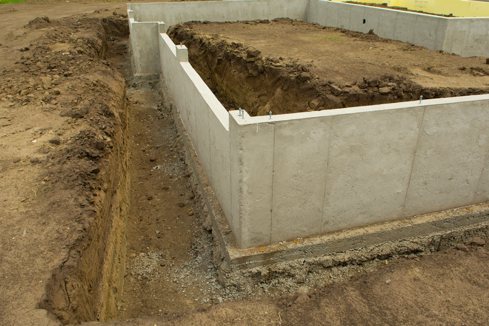

3 Ways to Keep Footings Safe from Frost (R403.1.4.1)
The IRC gives three solid options to keep a foundation from shifting:
  • Dig below the frost line. The frost line is the deepest point the ground freezes in winter. If the footings go deeper than that, they won’t be affected by frost heave. The local building department determines the frost line depth for your area (check Table R301.2(1) for specifics).
  • Use insulation for a frost-protected shallow foundation (FPSF). Instead of digging deep, the foundation can be insulated using prescriptive rules in Section R403.3 or the ASCE 32 performance standard. Insulation helps trap ground heat, preventing freezing underneath the foundation.
  • Build on solid rock. If you’re lucky enough to have a site with bedrock, congratulations! No frost protection needed. Rock doesn’t expand when frozen, so frost heave isn’t a problem.
No matter which method you choose, footings must still be at least 12 inches deep.
One exception: If you’re building on permafrost (permanently frozen ground), footings can be placed on frozen soil—but only if special steps are taken to keep the structure from warming the ground and causing it to thaw.

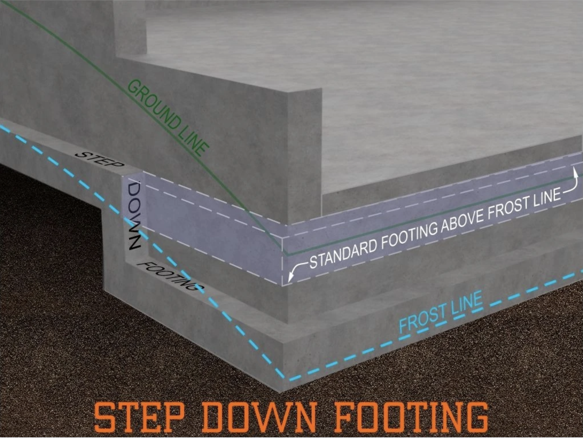

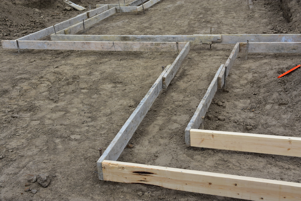

Slopes and Footings (R403.1.5)
Ever tried to build a tower of playing cards on a slanted table? Doesn’t end well. Foundations work the same way.
  • Footing Rule #1: The top surface must be LEVEL.
  • Footing Rule #2: The bottom surface can have a slight slope—up to 10%.
  • Footing Rule #3: If the ground is sloped more than 10%, you need stepped footings.
What’s a Stepped Footing?
Think of a staircase. If the land isn’t flat, the footing needs to follow the slope in “steps” rather than one continuous angle. This keeps everything stable and prevents shifting over time.
