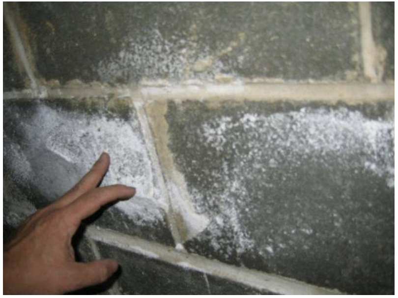

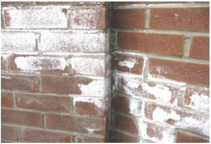

Efflorescence: The Warning Sign

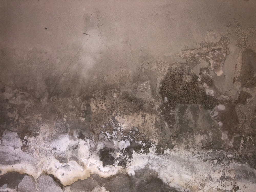

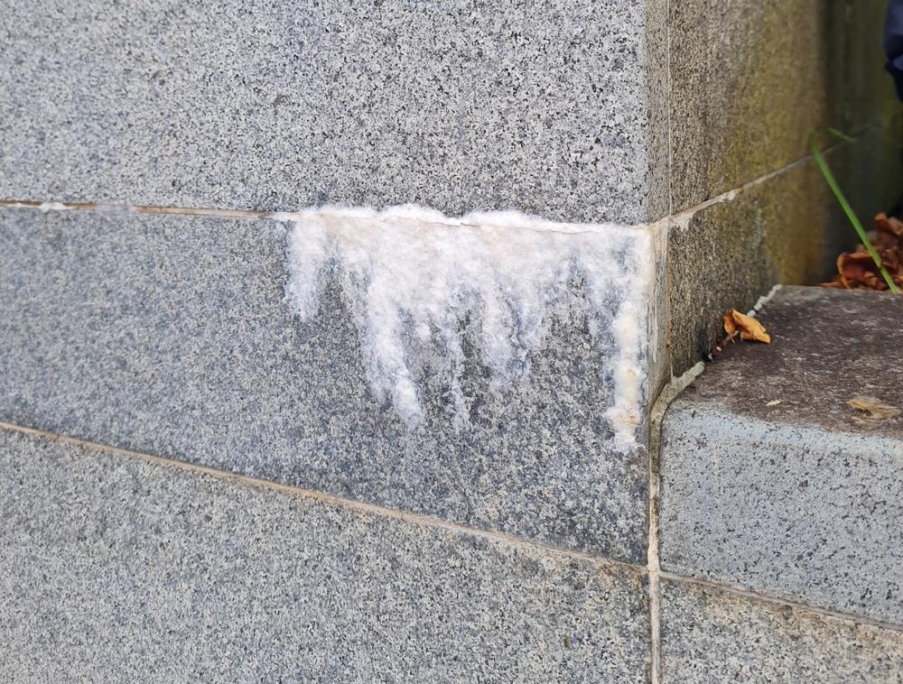

Efflorescence looks like a white, chalky residue on the surface of concrete or masonry structures. This crystalline deposit forms when water migrates through porous building materials, dissolving mineral salts within the substrate, and subsequently evaporates at the surface, leaving behind these salt deposits.
The term "efflorescence" derives from the French word meaning "to flower out," an apt description of how these crystalline blooms appear to grow from the surface. While primarily considered an aesthetic issue, efflorescence serves as a critical indicator of moisture penetration that may eventually lead to more serious structural degradation.
The Process of Efflorescence Formation
The formation of efflorescence relies on three essential elements:
  • Soluble salts present within the building material
  • Moisture to dissolve and transport these salts
  • Evaporation that concentrates the dissolved salts at the surface
Concrete, brick, stone, and mortar naturally contain mineral salts, as do the soils surrounding foundations. When these materials absorb water through capillary action—a process where moisture moves through the porous structure due to surface tension—the water draws salt with it. This capillary pressure, though relatively modest at 300-500 PSI, is sufficient to facilitate significant moisture movement through building materials.

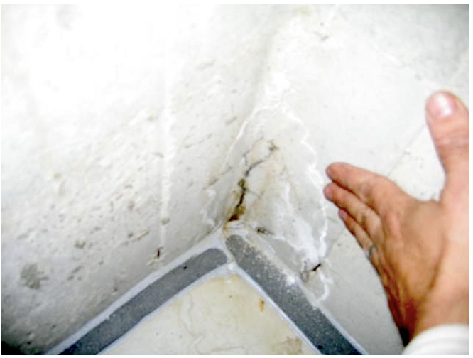

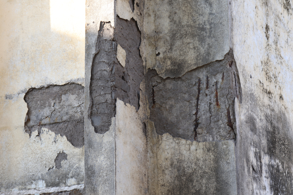

Spalling: The Structural Concern

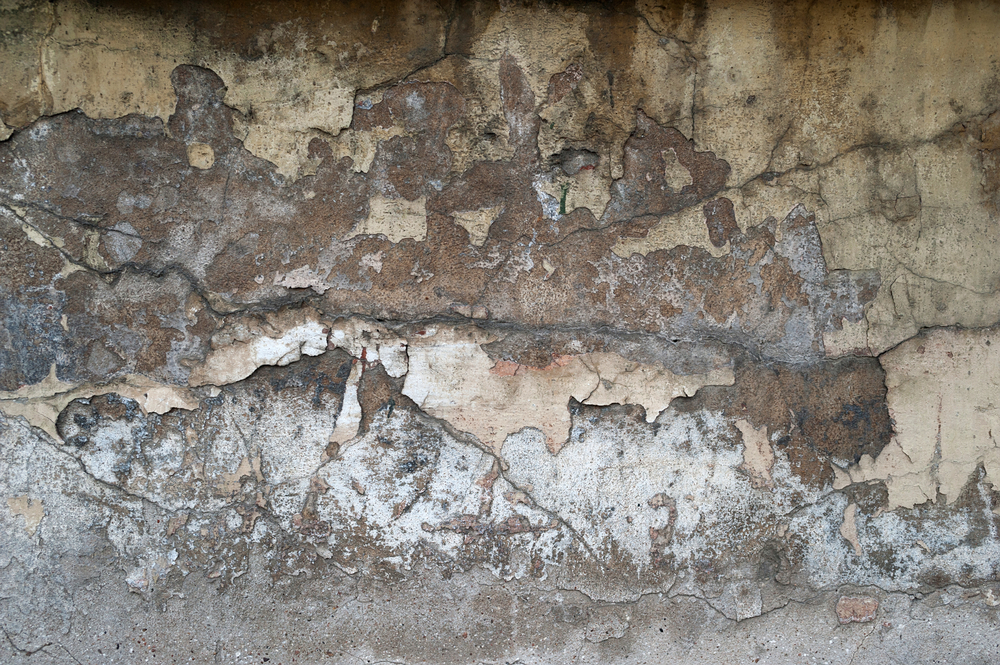

While efflorescence serves as an early warning, spalling represents a more advanced deterioration process where the surface material actually breaks away from the main body of concrete or masonry.
This flaking or fragmenting occurs when hydrostatic pressure builds within the material to levels exceeding its tensile strength—typically between 3,000-5,000 PSI—causing portions of the surface to detach or "blow off."
Mechanisms of Spalling
Spalling frequently develops through two primary mechanisms:
  1. Hydrostatic Pressure. As more salt accumulates beneath the surface, the osmosis process draws increasing amounts of water through the material. This osmotic action generates substantial hydrostatic pressure—potentially reaching 3,000-5,000 PSI. With concrete typically having a structural strength of 2,000-3,000 PSI, this pressure can overwhelm the material's capacity, resulting in surface failure.
  2. Freeze/Thaw Cycles. In colder climates, moisture trapped within porous building materials expands upon freezing. Repeated freeze/thaw cycles progressively weaken the material's structural integrity. Materials with higher moisture content are particularly vulnerable to this cyclic damage.
You may be interested in learning more about soils that heave under foundations in “Frost Heave Caused by Ice Lenses” at nachi.org/frost-heave-ice-lens
Critical Assessment Parameters for Spalling
When evaluating spalling, inspectors should document:
  • Depth and extent of material loss
  • Whether reinforcing steel has been exposed
  • Presence of concurrent moisture issues
  • Location patterns that might indicate systemic problems
  • Structural implications based on the affected components
